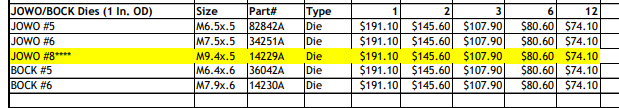

Perhaps this will help you. The part number is the Tapco part number. These are prices from the group buy in 2020. I don't think these have been done in a group buy since then.
We just completed a group buy from Tapco, and the prices are much higher now than what you see below from 2020. Maybe 60-70% higher based on prices we got for single-unit 1" dies.

I heard back from TapCo and they gave me these prices:
Item/Amount1pc2pc3-5pc6-11pc
M7.4-.5 HS 1"OD Die$312$241.20$102.08$75.75
Item/Amount1pc2pc
The M7.4-.5 D4 Plug tap with TiN treat$212.56156.72
Based on what Herman mentioned above (thanks!) it looks like these aren't really necessary, but since I've got the data, here it is. I will post an update later after my M7.5-0.5 die comes in later this month.
Item/Amount1pc2pc
