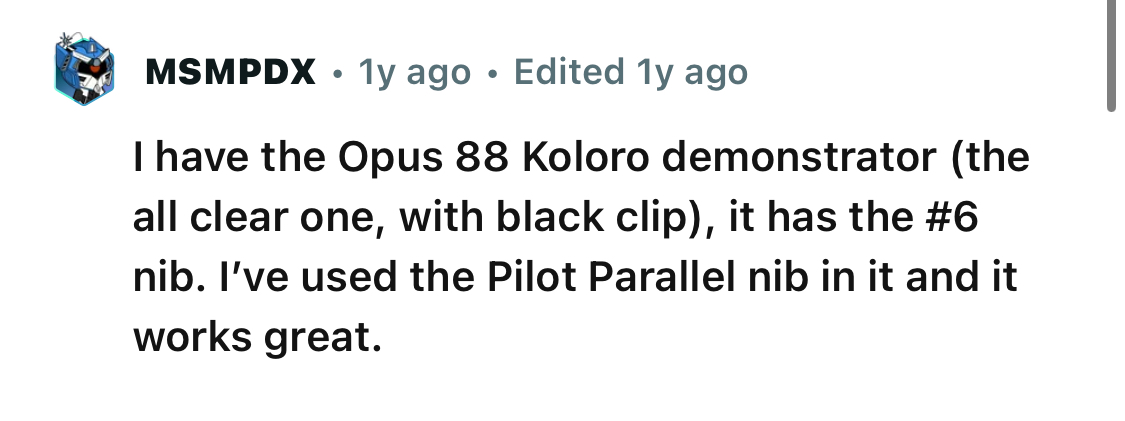

I did find this. Would this indicate they are compatible or no?
The deal is someone from outside the country is asking if I can modify a pen I make to accommodate a pilot parallel nib, our sections are tapped for a Jowo#6. This is really outside my wheelhouse so I'm at a loss.

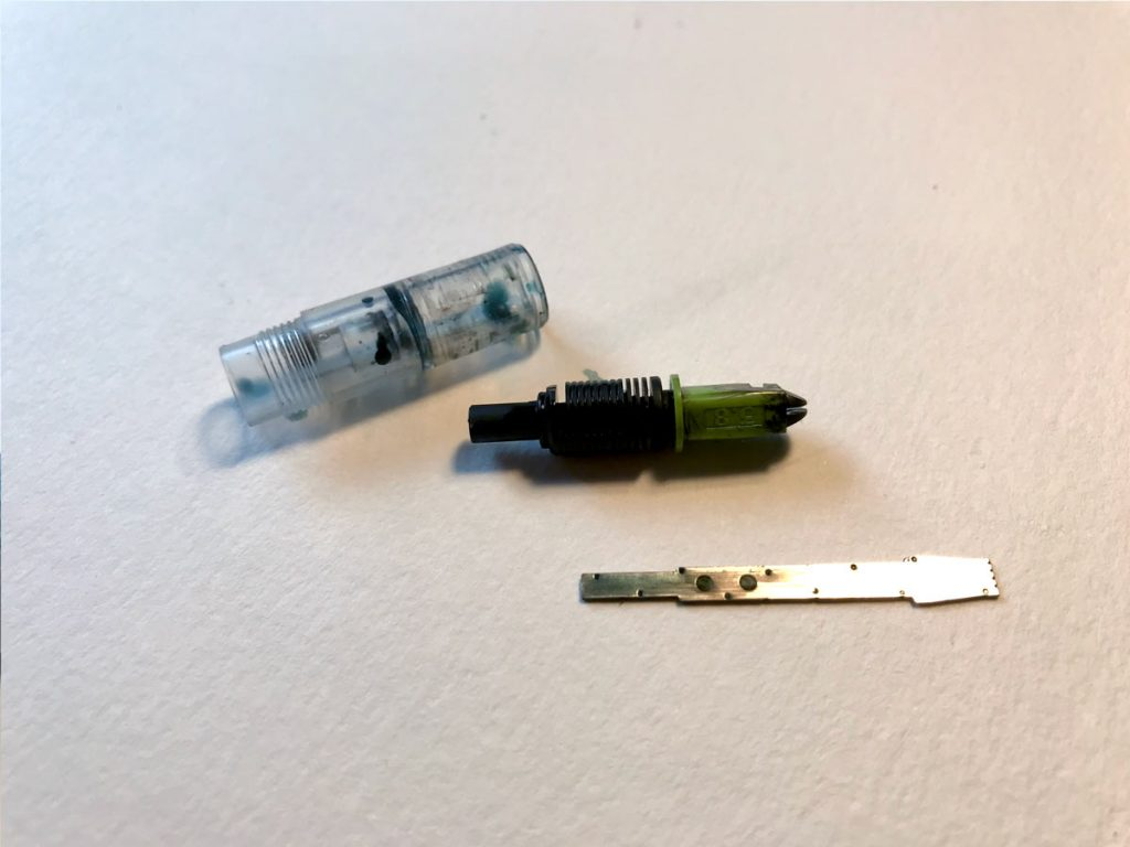

Below is a picture from a blog I bookmarked when I looked into this last year for a friend but never made the pen. I planned to make a barrel that threads with the housing shown and use the Pilot cartridges. The eyedropper fill with a section built to accept the feed would be the more elegant method. I haven't done an eyedropper fill, so I passed on that idea.
picture used from jakerainis.com blog
