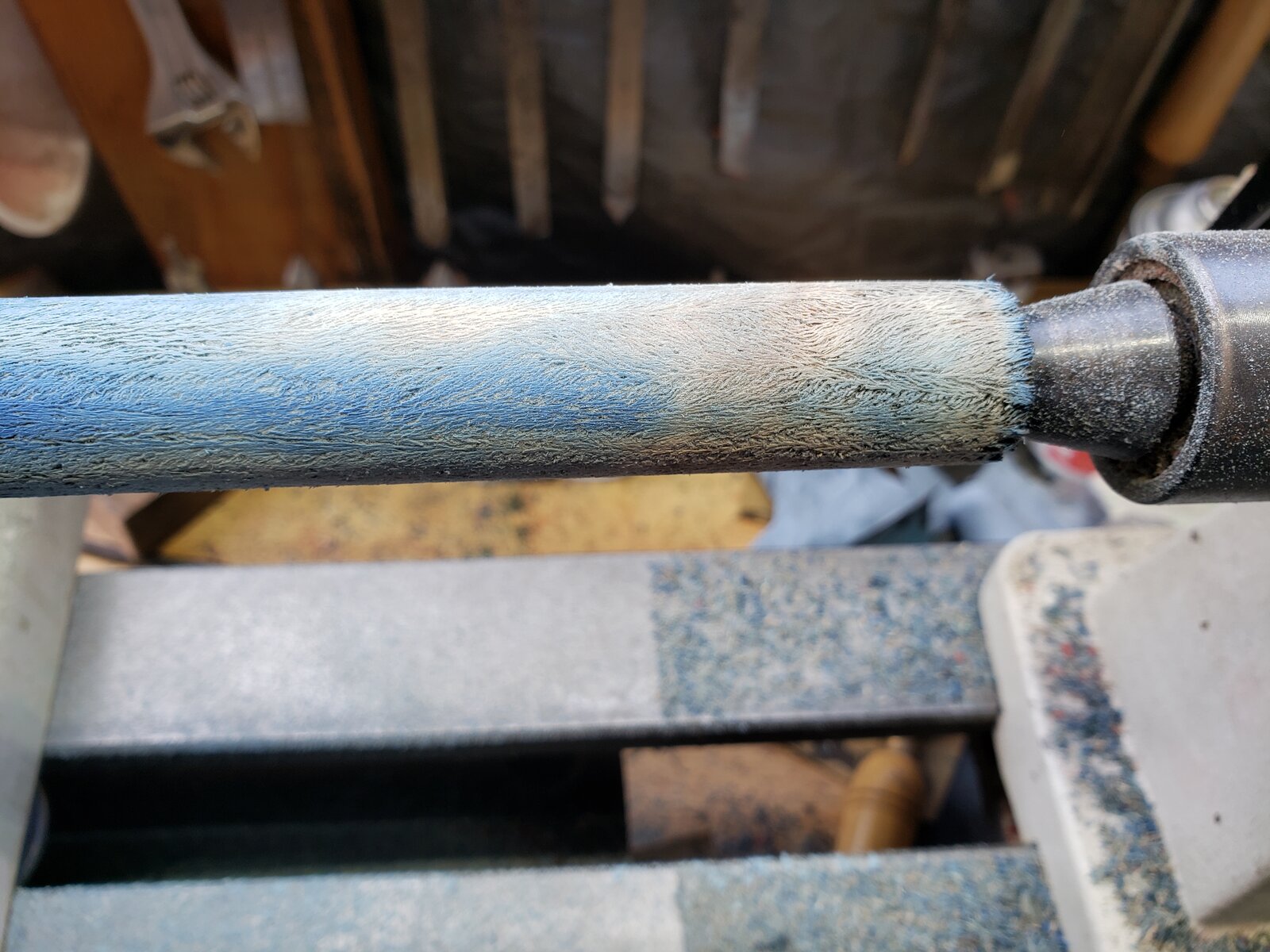

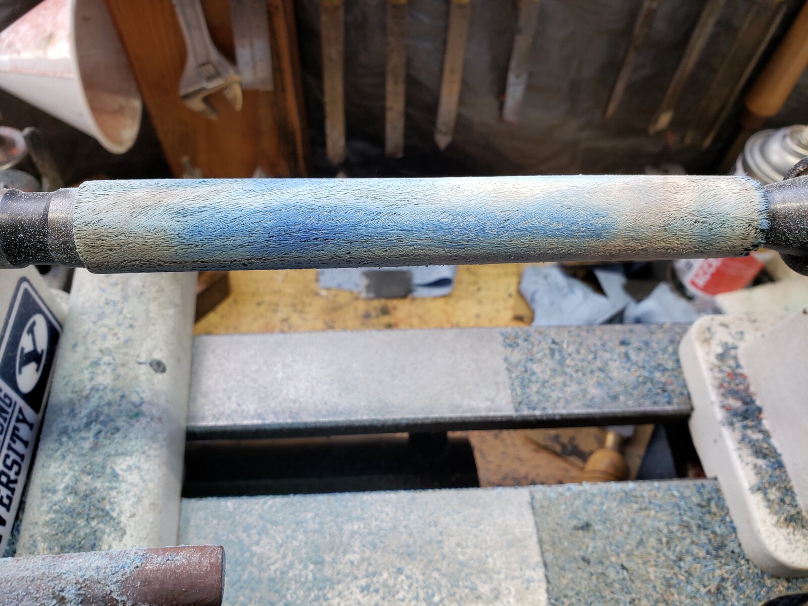

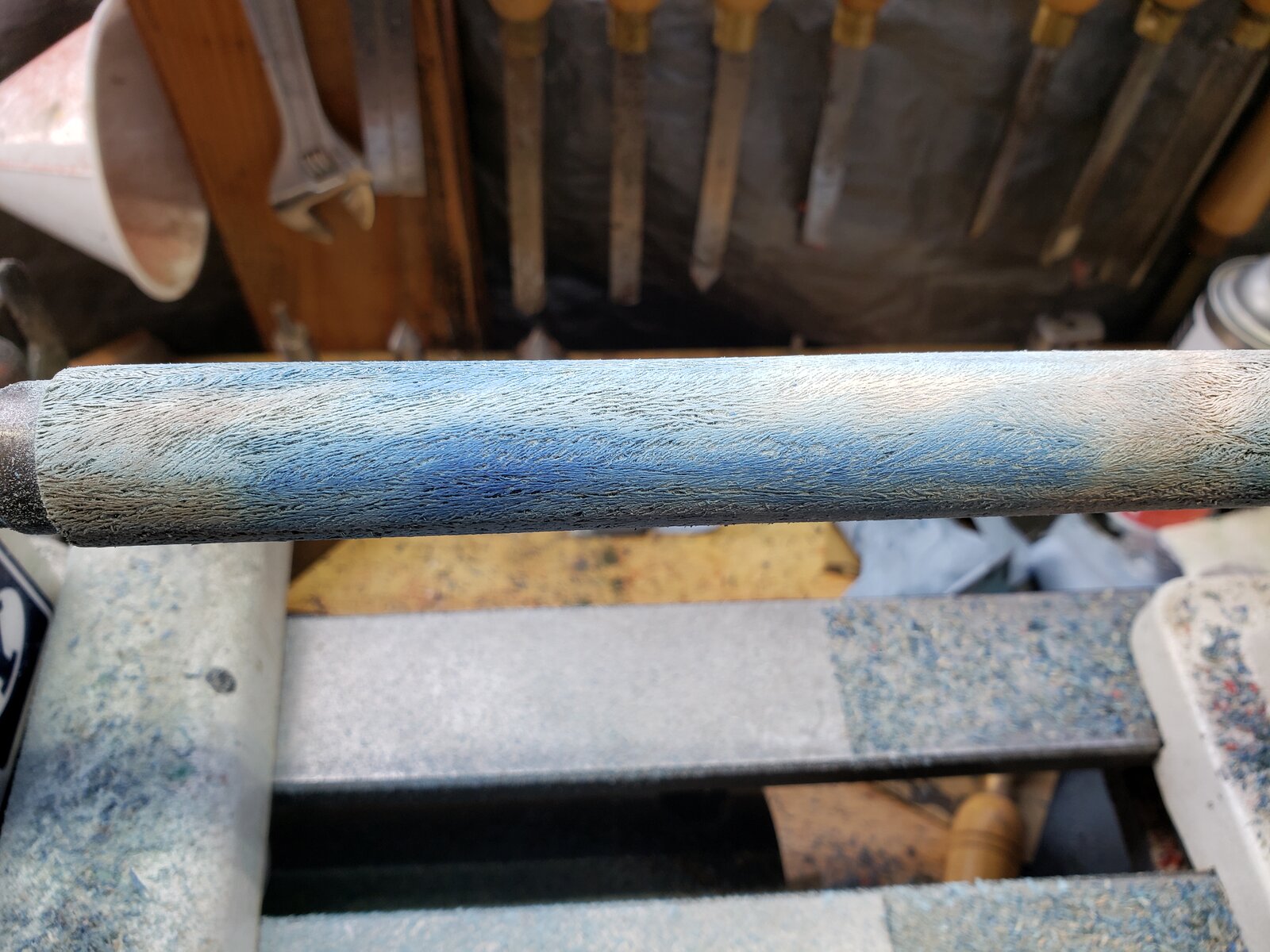

My dad's neighbor had a Joshua tree removed several years ago, and I finally got around to cutting a chunk of it and bringing it home to make into blanks to see what they'd look like.
The "wood" is so porous that I thought it might dye well without a vacuum or pressure pot, but alas it was not consistent. I think with a vacuum dye would take exceptionally well though.
Aside from the poor dye job, it's not well-suited for turning without stabilization, which is how I thought it would be. And beyond that, it doesn't do it for me appearance-wise. Maybe with a better dye job I'd like it more.
Anyway, if anyone ever wondered about Joshua Tree, there's my take on it.

If I had the opportunity... (without stabilization):
1. No dying for the first trial.
2. I would coat the rounded blank in CA.
3. Turn, and re-coat every few cuts.
4. Continue to coat in CA and turn to dimensions.
Interesting timber. 🧐 I hope it does well for you. Thanks for sharing.

That looks less like wood and more a bundle of hairs. I would almost think it needs a good full stabilization to really shine. Interesting and thank you for sharing!

Yes, it looks like a bundle of Fibers. Mark's suggestion will work to see what the turned blank could look like.
If you were going to do more than a couple, you may want to look into stabilizing.
It turned down ok without stabilization, but yeah, once you got within about 1/8" of final dimension, you'd want to start coating with CA. Still, it's SOOOO porous, I'd be prepared to use a ton of CA. For me, I'll hang onto the blanks I have until I'm in a place and financial position where I can stabilize...or look into having someone else stabilize them for me. I'm still not sure I like them enough to even bother with it.

I thought right from the start that it'd need stabilizing, but I wanted to see what it would look like without.

Wow, that does look "hairy". They are kind of an odd palm, yucca, cactus combination in appearance. I'll bet it would be pretty interesting stabilized, especially with a little mica between the fibers.
