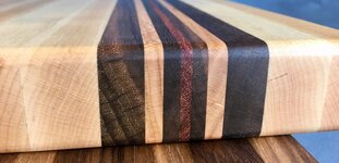

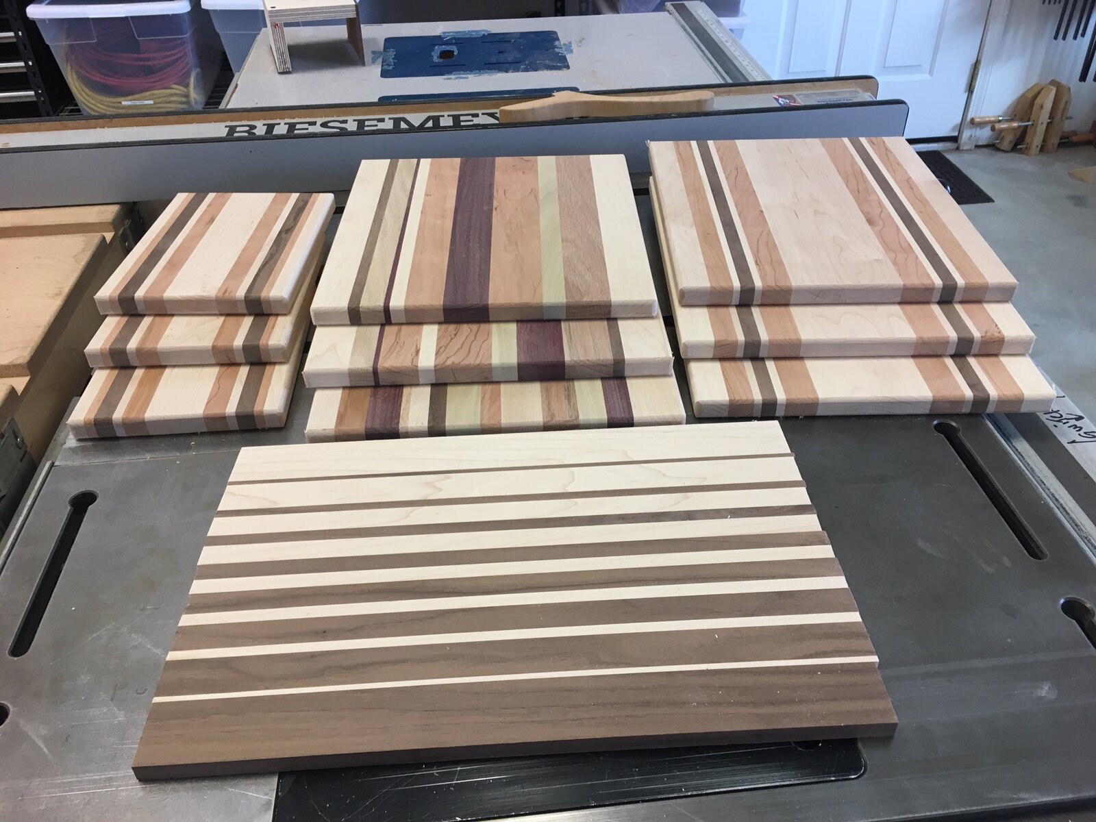

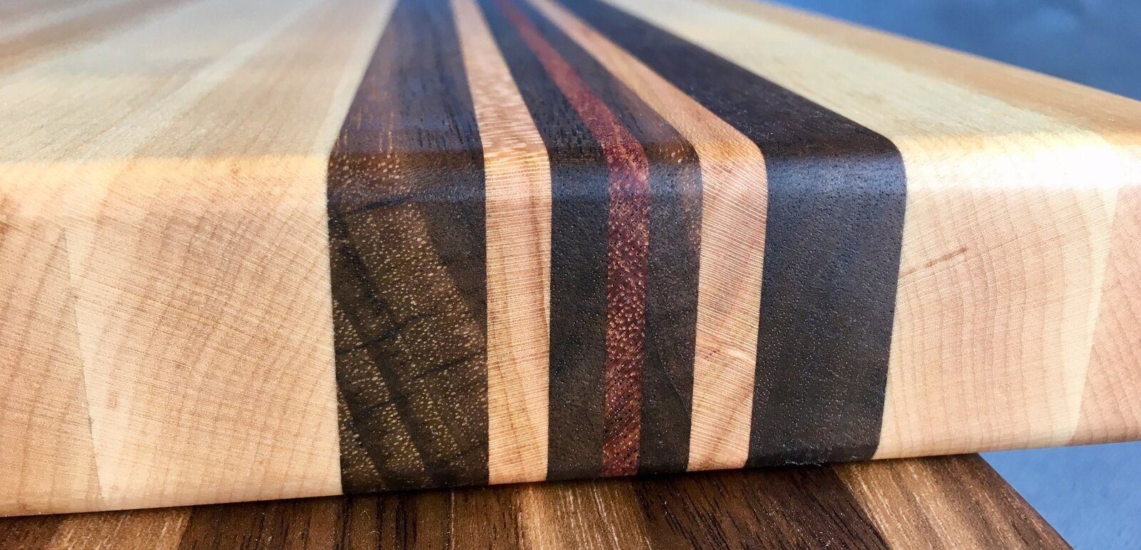

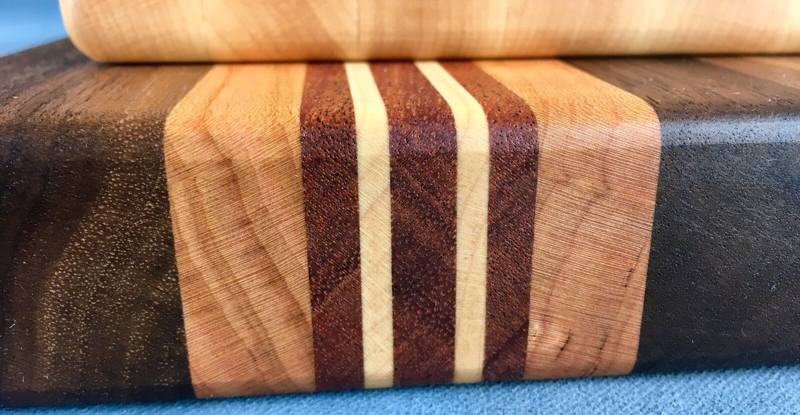

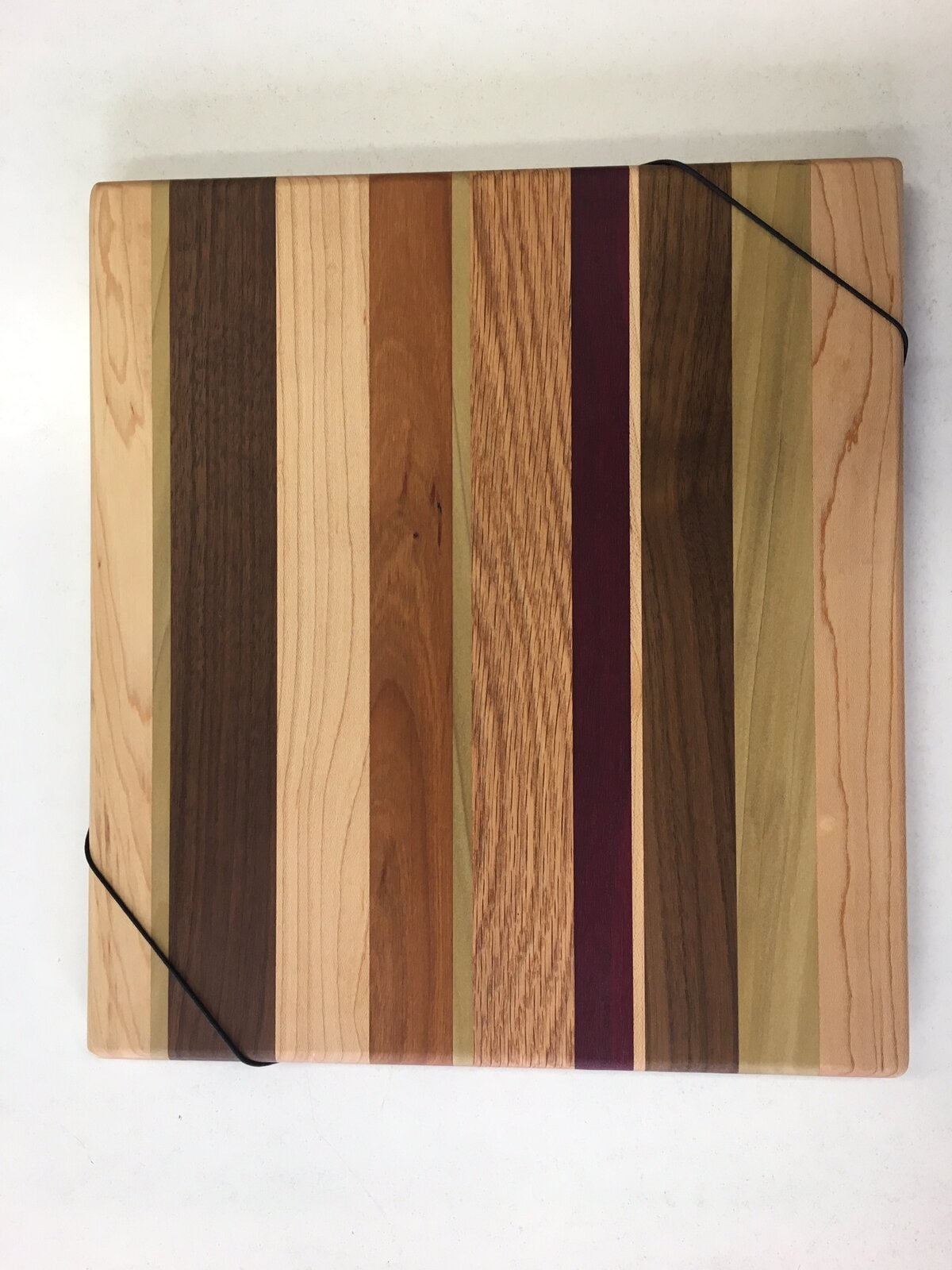

I make lots of cutting boards so a jointer has been helpful. I have a small 6" Rikon with helical Carbide cutters, it rocks. Start with zeroing your table saw to exactly 90 degrees. Use a magnetic digital angle finder. Buy a Frued glueline rip blade, not a copy. Cut slowly. Dryfit your cutting board and look for gaps. Plane all or the ones that bother you. Dryfit to see if it helped. Once satisfied, use good glue ie. Titebond three. Use good clamps like Bessey parallel clamps and full length cauls. Let dry overnight.
Remove excess glue, plane with your Shelix planer and drum sand or palm sand. Done
