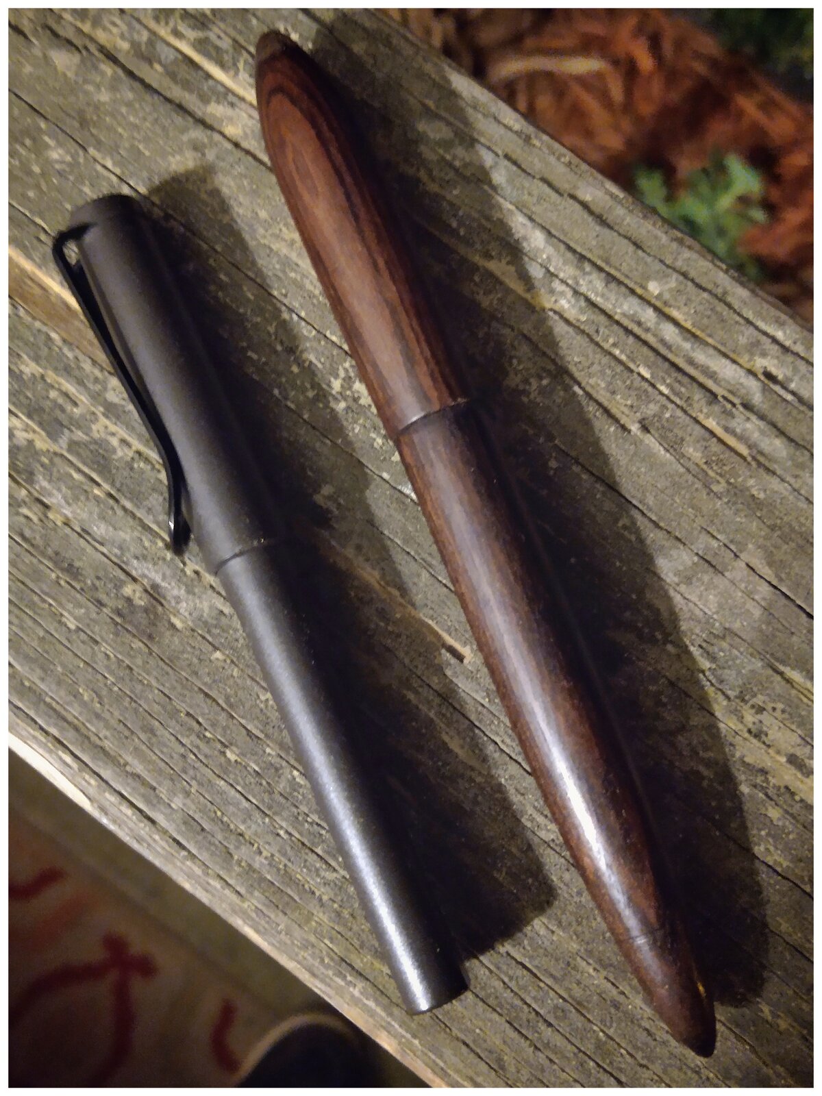

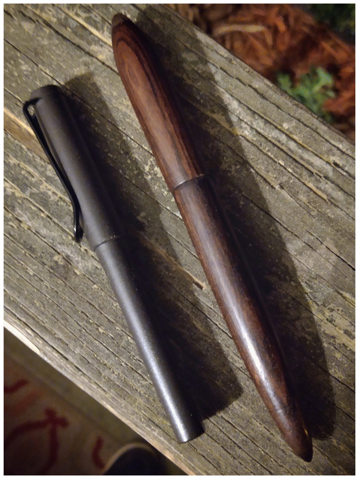

This is a cheap Speedball fountain pen, in a black walnut sleeve or "pen-casement" LoL
I did this one a while back, before I ever turned my first kit. I really wanted to get into pen turning and just couldn't wait.
The thing is MONSTROUS huge! Pictured here next to a Lamy Safari for scale.
