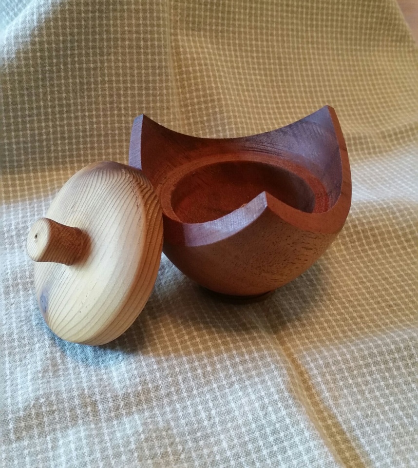

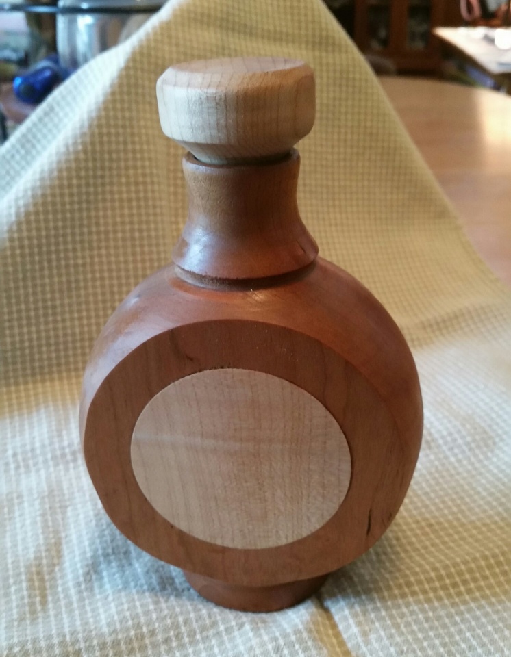

Aug 30-Sept 3, WoodworldTX in Dallas hosted Jimmy Clewes teaching a variety of projects. I was fortunate enough to attend his Friday session. I signed up because I wanted to learn to turn the tri-cornered box and I did learn to do that. That was just a morning project, though. He asked what we wanted to do in the afternoon and showed us a variety of options. We chose to turn a flask or canteen. This was one of the most fun projects I have ever turned. I used just about every turning skill I had and every tool in my bag. It involved turning between centers, expansion and contraction chuck mounts, jam chucking, hollowing, and precision measuring and marking.
The tri-corner box is made from a block of mahogany. The lid is Douglas fir. It's about 3.5" high and in diameter. It's finished with Danish oil.
The flask is made from a block of cherry with a maple insert and stopper. The cherry block started as 7"x5"x3". Finished dimensions, including stopper, are 7" x 4.5" x 2.5". I haven't tried it yet, but I'm told it will hold water. The maple insert is friction fit into the hollowing hole.
