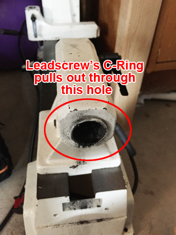

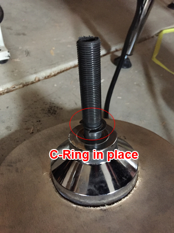

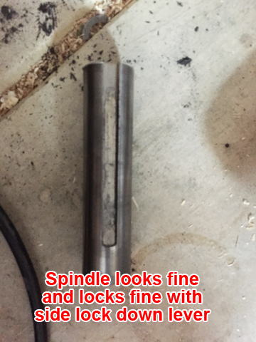

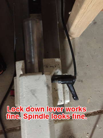

Thanks for the quick replies! Photos are a good idea, so here are a few. Hopefully you see what I mean.
Initially the leadscrew's C-ring catches on the tailstock's back, forcing the leadscrew to be inserted either from the front or back. Either way, the leadscrew backs out rather than remaining fixed while pushing the spindle forward. With sufficient (not much) pressure, the C-ring pops through the back of the tailstock. (Oh, you're correct on your clarification, Louie; however, I do not have the lock too tight or lose, the spindle/quill just doesn't advance.)
Not knowing exactly how it's supposed to work, I'm not sure what to repair/replace. Sure hope this makes sense!
Thanks in advance! ...j

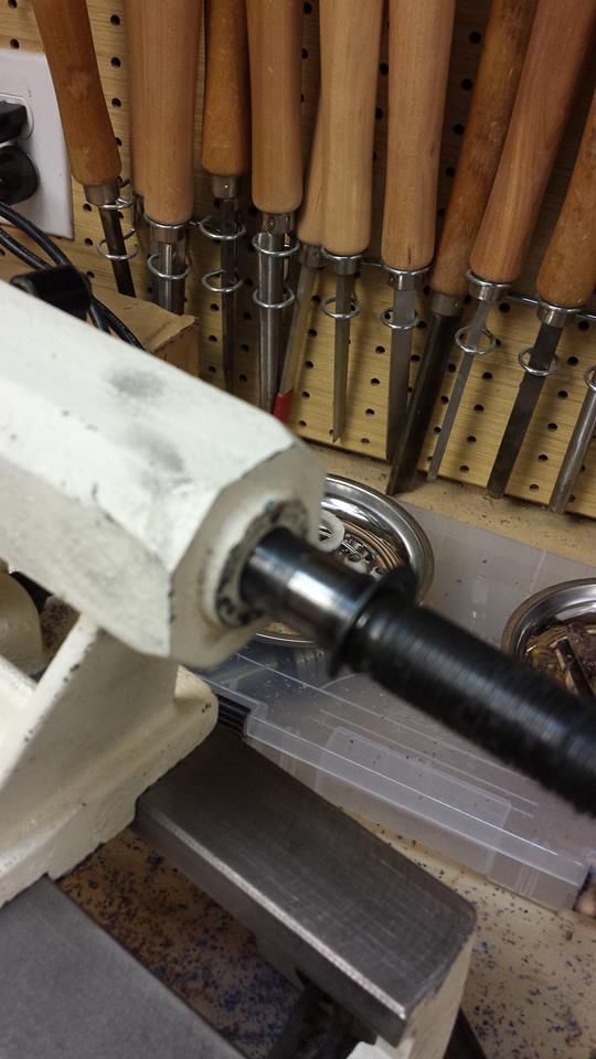

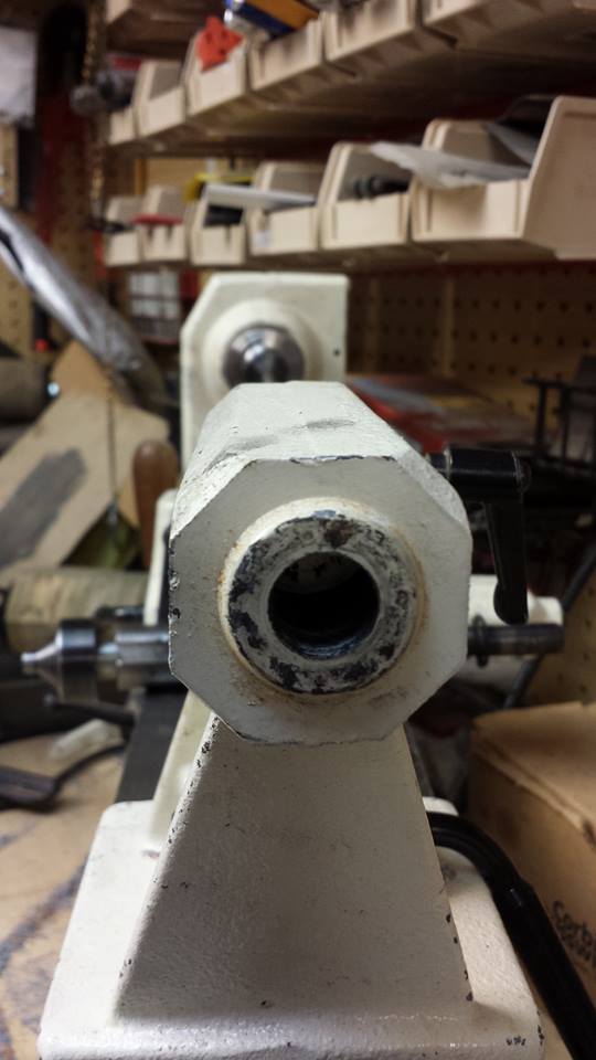

hmmm I went and took my tailstock apart. Now mind you, mine is an older model than yours and is the 1014 not the 1014i. It appears to me that the end of your tailstock casting is blown out. I am enclosing a couple pics, but the shaft going to the handwheel on mine is a tight fit into the casting. Sorry to be the bearer of bad news, but that is my opinion from a few thousand miles away. I bet you can get a new tailstock casting though. I looked it up on Jet JML-1014I Parts List and Diagram - (708376) : eReplacementParts.com and it looks like it is about $128. Is it worth that much to repair would be the question. If you do decide it is not worth repair, I might be interested in it for parts, depending on what kind of value it might have

You might also be able to have a machine shop insert a bushing into the tailstock and hold it in place with a set screw. I am just thinking outloud. the alignment of the shaft to the handwheel I would not think would be absolutely critical as there is some slack in the screw threads and the actual morse taper section is held tight with the locking screw. I am a tinkerer at heart and although I do not have machine shop type skills, I can visualize the possibilities for repair, but again, you would have to weigh the value of doing that as opposed to replacing. I guess I grew up where replacing things was not really an option most of the time, so I learned to repair as much as possible. :) :) Good luck to you and please let me know what you decide to do after you see the pics I posted

Now that it's been a couple weeks since I disassembled it, can you tell me which side of the tailstock the leadscrew's C-ring goes? I believe it is screwed into the quill and then inserted from the front (the headstock side), then into the handle on the back, right? That makes the most sense, but the diagram on ereplacementparts.com makes it look like the leadscrew is inserted from the back, so the C-ring would be on the back/outside of the tailstock.
Thanks again for your help! I'm looking forward to having this little guy back in action. ...j
That is why I love this forum. Always someone willing to help out however they can :) :)
You gave me a reason to disassemble my tailstock and clean it so it was a win win for me. It works MUCH better now. :) :)
Yes the C ring goes INSIDE the tailstock from the headstock end.
