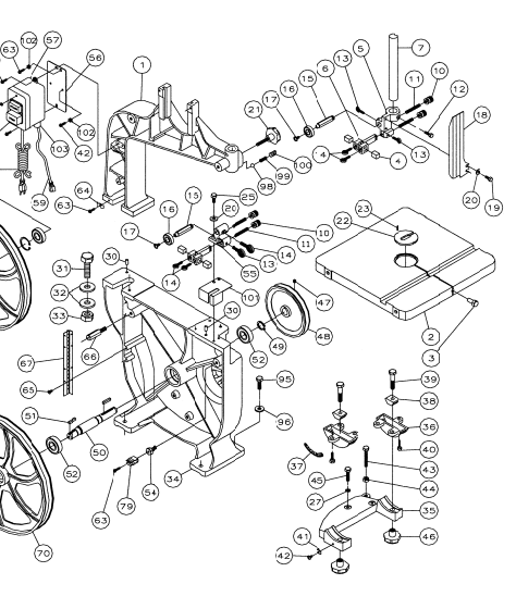

Randy there should be a washer between the knob and the trunnion. This washer helps spread the torque out some on the trunnion. There really is nothing more to the table top than that. The problem has to be there somewhere. The crack thing has high potential too.

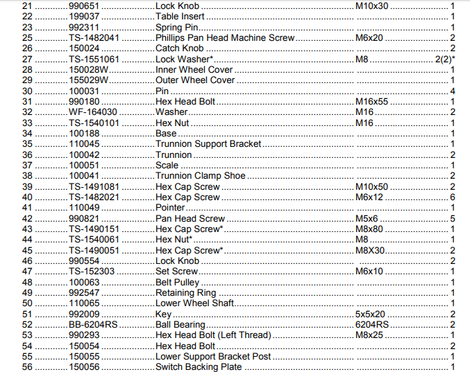

I don't know if this is any help but maybe.

Randy S, our local Ace Hardware carries fasteners that Lowe's or HD doesn't have. Lowe's should have a decent selection of metric fasteners; our store does.
