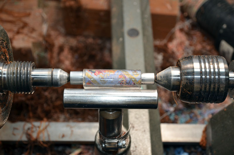

When I use the stock tool rest it looks like this.
The 2 washers on the threads is from Turners Select No-Lock Spindle Washer, it's there to stop tooling from getting stuck on the thread, and yes they are a pain to remove. I put two on to make it easier to remove.
The dead center is standard, the live I mostly use to align the tool rest so that yields flat. When working with bowls you really need to reach where the banjo can not go. So I use this.
They come in 2 sizes, WP019 6" and WP0210 9" S shape. If you notice one end has a big bend on the side which could be used for very small objects. There is other shapes to, like the WP0211 V shape
As for the clamp on the banjo I use a grizzly G7326 I found them to be more durable, holds more secure and breaks less.

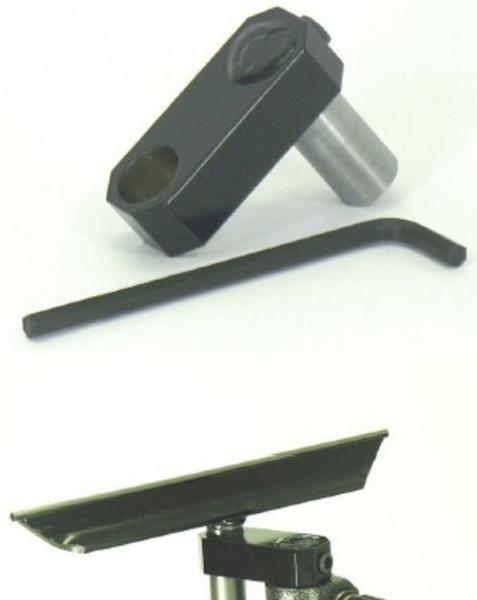

Is there some sort of attachment that will allow me to swing the rest closer to the center line?
Yes, it's called a "Dog-Leg" and is sold by Robust tools.
I own one and have used it many times. I originally bought it to use with a sphere tool, but have found other uses too.
I hope this helps.

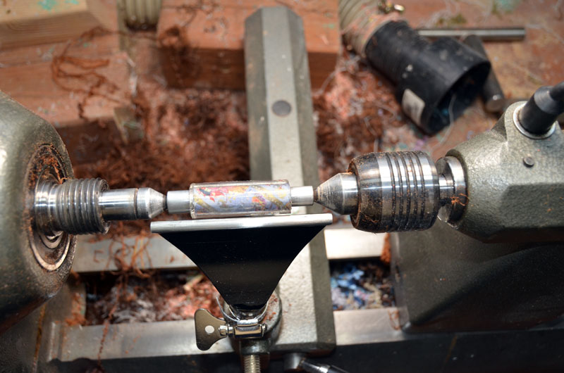

Here is the way I solved the problem.
3 1/2" rest from penturners products which I had been using with a 5/8" post on my Jet 1014VS. When I stepped up to the Nova DVR I needed a 1" post, John couldn't help there so I got one from Sorby.
4" Robust tool rest from CSUSA, works well but I do prefer the round bar.
