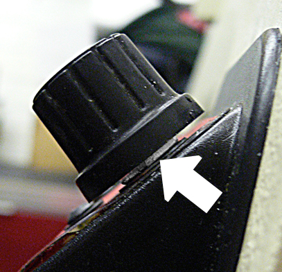

You can tighten the speed control knob. There is a thin nut under the plastic knob. I couldn't get the knob off so made a really thin spanner that slid between the housing and the bottom of the black knob and managed to tighten mine successfully.

Here is a close up pic of the nut you need to tighten if your speed control knob is loose. If you can get the knob off its spindle it would be a lot easier but mine seams to be stuck fast, hence why I made a thin spanner.
My knob wiggles around. The shaft too. Did yours do this before you tightened it?
Yes, the whole potentiometer wobbled around. They are installed from inside the switch/electronics housing. The nut is used on a threaded collar from the front to hold it in place, before the knob is put on. The actual knob usually just pulls off for access to the nut but mine refuses to come off. I don't want to put too much force on though for fear of breaking the shaft.
