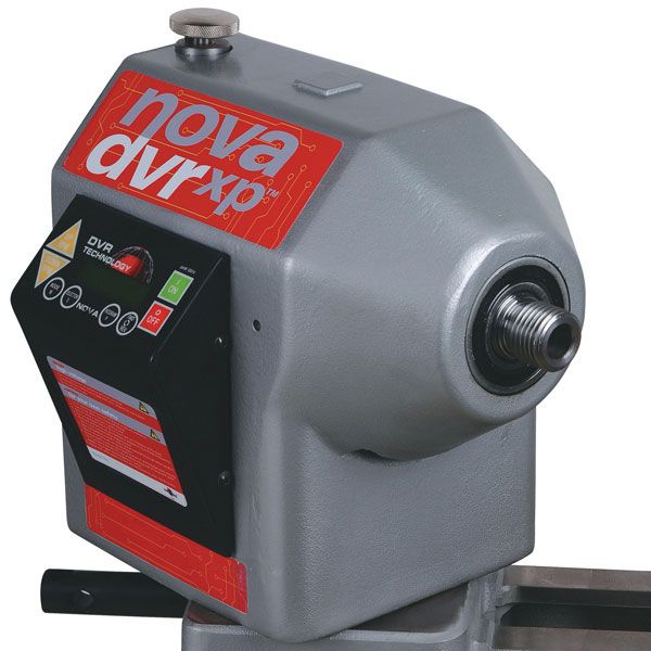

I was at the Atlanta Woodcraft store in Roswell this weekend and I worked on the Rikon lathe, which I would assume is the competitive lathe to the 1221 VS from Rikon, it was similar size and had Variable Speed, DRO and it was much nicer to dial in the speed on. I don't know the other specs on the Rikon lathe, but I am really wondering if I should have looked at it seriously in comparison to the Jet, it seemed like a really nice lathe....

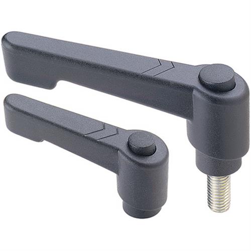

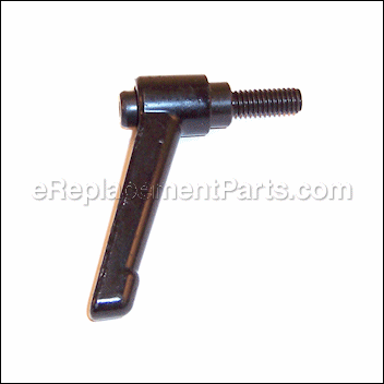

I am also not going to mention brand name substitutes as that would subtract from your original post concept. What has been glossed over by many, esp with 'china' comments is design details. Take the lock down screws for example.
Jet part, $17.43.
attachment.php
Grizzly part. $3.95
attachment.php
Same part, the grizzly part is beefier, less prone to stripping, easier on the hands and locks better. Much better design.

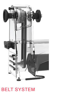

Also next time you are on the phone with jet ask them about using the lathe as a pen press. They will tell you to *NOT* do that as it can strip out the tail stock and bend/damage the locking lever.
The motor is located in a bad position that allows shavings etc to pool up on top of it causing over heating to happen, also damage the belt. With the position of the motor and the bed things will pile up in there and be hard to remove due to space issues. This same problem has been a very well known problem for some time and some companies have started to get away from the fail motor placement.
Jet
attachment.php
Non-jet
attachment.php
