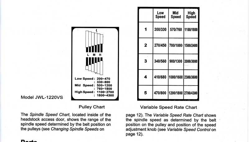

Also, the manual lists the speed from 250-4000, but does not break down the speed ranges with respect to belt positions. From the manual it looks like there are 3 belt positions. Can anyone tell me the approximate speed range for each position?

Here is a scan of the speed chart from my owners manual.
