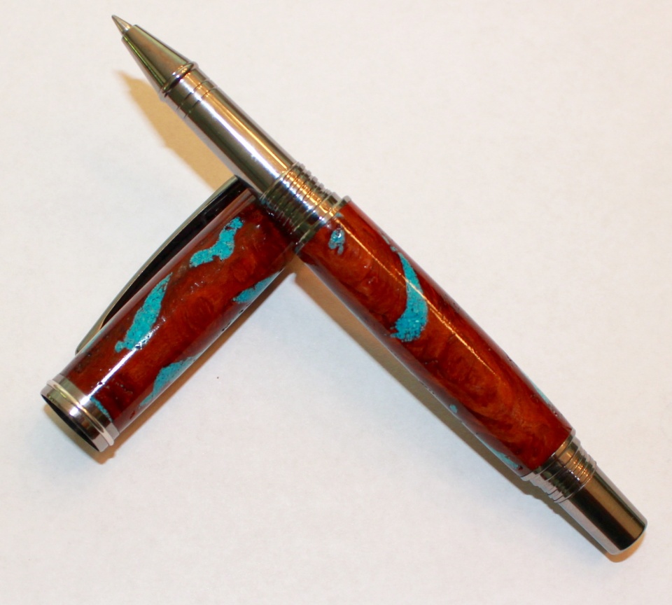

Another Possibility, Depending How Porous the Jarrah Burl Blank is, you might consider having it filled with a Casting Solution of your choice or one that is available to you.
If it is real porous, you might like to Colour the Solution rather than have large Globs of Clear Resin.
If you are not confident to tackle it at this stage or if you do not have a Pressure Pot, Compressor etc. then you may find someone close by who could do it for you.
