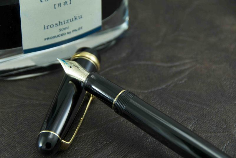

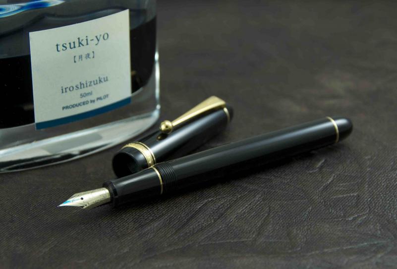

Digging up a slightly dated thread but here are a few pics of my little Pilot SF. I really like this nib... quite springy and fun to write with. The body is a little small for my liking and I'm thinking of pulling this nib off and trying to match it with one of my bigger Urushi bodies.
