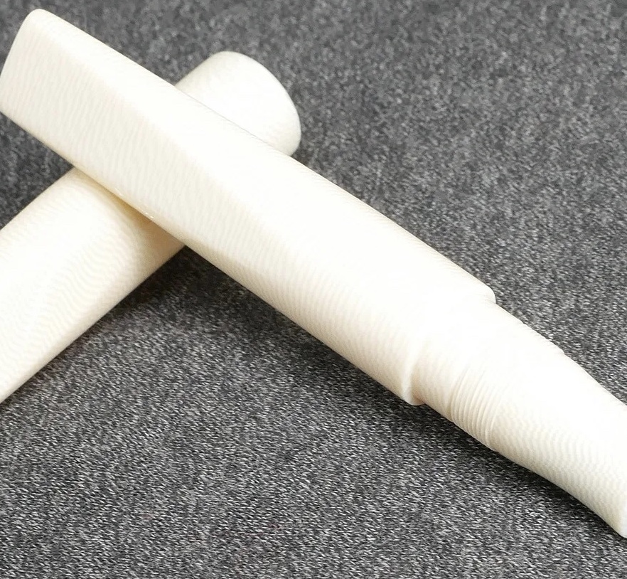

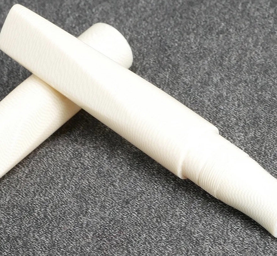

This was a crosscut piece I used a while back. I can't say I enjoyed it. I had shrinkage issues even after I rough turned/drilled it and let it sit, and it stains really easily.

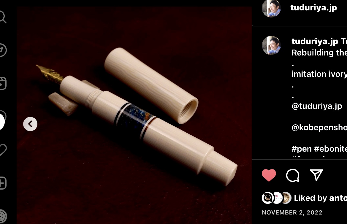

Here is one by tuduriya. I have seen several others that threaded. Not possible with the VF rod.
Even with a threading jig that some use on wood?
I've single-point threaded it just fine with a sharp tool; however, the brittleness of the material is a turn-off for me for use on threaded parts since the wall thickness of these parts on pens is typically pretty thin, so there's a good chance of the material breaking during use.
I can't say. I'm not set up to thread that way and would prefer not to have to.
