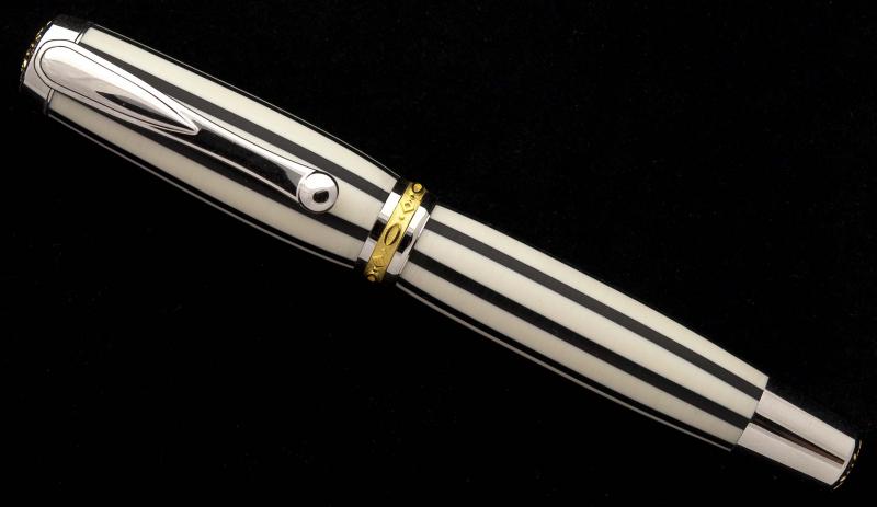

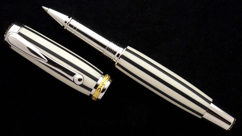

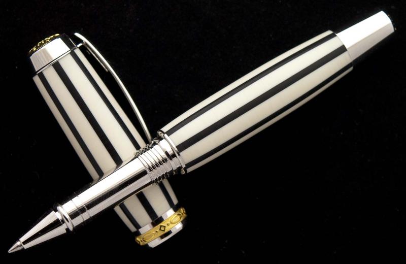

Made it this A.M. It's an ElMostro resin blank called Ivory and Ebony on a 22K Jr. Statesman Rollerball. I learned really quickly that you have to sand with minimal pressure on the sandpaper to keep the small particles of the black resin from getting embedded into the white resin. Other than that, I think the finishing went pretty smoothly:rolleyes:. Comments welcome but most of all thanks for just looking. Doc:)

I learned really quickly that you have to sand with minimal pressure on the sandpaper to keep the small particles of the black resin from getting embedded into the white resin. Doc:)
BEAUTIFUL PEN!
One way to reduce the sanding issue above is to apply some thin CA to the blank once you are done turning but prior to sanding the blank. Take one of those little plastic bags pen parts come in and put it over your index finger. Then apply some thin CA on the bag and hand turn the blank on the lathe while holding your finger with he CA against the barrels. Let it dry then sand lightly.
Thanks for posting, Eugene.
BEAUTIFUL PEN!
Eugene, I got a good result sanding lightly up to 600 grit followed by MM to 12000 grit as shown in the the pictures. However, I wanted to ask..do you normally use or recommend a CA finish on your ebony/ivory series of pen blanks after tuning and finishing either to 600 grit or even after MM.
Regards, Doc
