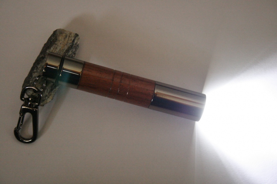

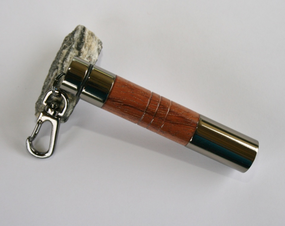

Maybe I should say I've made the light an Gun Metal LED flashlight from Woodcraft. It's a nice little kit and put out a good bit of light. I did not have a barrel trimmer big enough to fit properly in the tube to I took a sleeve from a PSI kit and put a few wraps of blue tape around it until it fit with a bit of resistance in side the tube and used a 7mm trimmer it worked rather well. The blank is Bobinga. All C&C are welcome. Thanks for looking

Great job Dan!
I've made trimmer sleeves for all my larger size tubes by simply turning a standard 7 mm tubed blank down just to the point where it slides into the larger tube. That way I can use my 7 mm trimmer on any size blank. I write the size on the tube with a sharpie so I can quickly grab the one I need.
