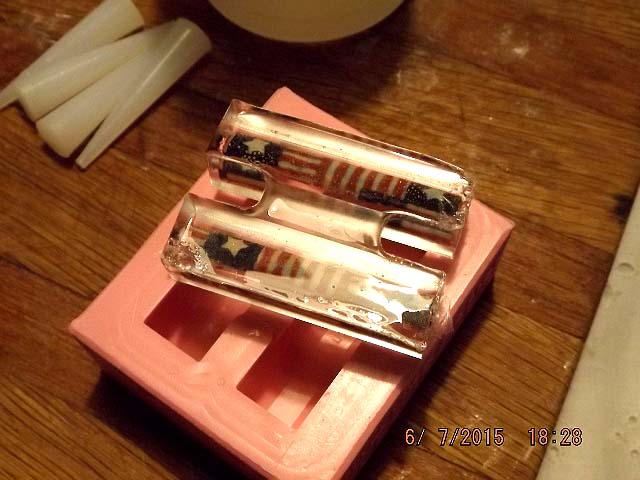

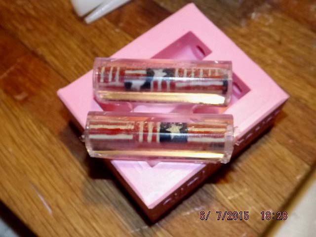

So far I am delighted! It is a big difference form the last time I tried to cast with out a pressure pot. Yes the compressor was hooked up and had been in longer than I intended as I was watching a dvd. Any way,, here are a couple of pictures of my casting. Only thing is, on one of them the fabric was coming loose but it is a lot better than the first one. There is just a few little bubbles in one corner of the casting but that will be gone after it is turned. when I took it out of the mold it flipped out of my hand and dropped on the floor. It didn't get broken, but so far I am pleased. Take a look.. Fay

Thank you. I'm so pleased with these. Next payday I plan to order another tube in mold from Fred Wissen and then I'll be able to do two molds at once. I don't have very much alumilite left so come payday will order some more and then I will cast more blanks and be able to try out the mold I built. The rack I built is too large for the pot but it should fit once I knock the corners off of it and maybe shorten it a little bit. I put a plate in the bottom of the pot before I put the mold in and it worked out pretty good. I wish the bottom was flat and not rounded as I'm afraid the resin could get spilled out of the mold before it can cure. So far I'm happy.. Fay
