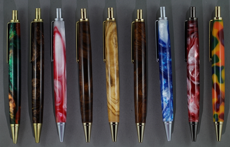

I like long, single-barrel pens in order to show off beautiful blanks.
Recently, I made a batch of 10 ballpoint pens using the PSI Slimline Pro kit.
I made them, as I have shown before, omitting the centerband and brass tubes.
With this minor modification they become single barrel (about 4.2" long) pens.
I already gave one away to a granddaughter so that leaves 9 to show.
The three in the middle are wood (Olivewood in the middle surrounded by two Rosewood burls).
On each side is a triplet of "acrylics", five of which were cast by another IAP member many years ago. . I would like to acknowledge him, but I can't remember his name. . They polished up so beautifully ... I think they're PR . . The one on the far right is a commercial blank named "Carnival".

I was a little nervous leaving out the brass tubes at first but I have made enough of them now that I have gotten over the nervousness. . I drill the blank at 15/64" ... just big enough for the refill to slide smoothly ... and then I make the pen just a bit on the fat side ... about 0.540" in the middle. . So far, so good ! . For the wood ones I make sure that I use very sound wood ... no burls for sure.

Awesome pens Mal - I really like those - great display of the blanks. You said, in your reply to Brotherdale, "For the wood ones I make sure that I use very sound wood ... no burls for sure." but two of them in your description are Rosewood burls?
I am going to have to try these - not familiar with these kits. Without the tubes do you glue the parts in? If so how do you change refills?

Teodor ... Thanks for your kind words ! .. As I think I said, there is a kit involved ... the PSI Slimline Pro kit.
I use all parts of the kit except the center band and brass tubes (no tubes at all in mine). . I have also done some resizing of the hole and final diameter (see one of the above posts).
Keith ...
Thanks ...
You surely caught me here .. :redface: .. Rosewood burl is the exception !!! . . It is very sound compared to many other burls ... in fact, I often question whether it is a burl at all, lovely as it is.
Yes, I do glue in the parts. .. Changing the refill is just the same as for the complete kit ... the nib has a screw in coupler that glues into the blank leaving the threaded end protruding. . I enlarge the hole at that end to be a bit larger than the 15/64" (mentioned in a post above), but just for the required length, to accommodate the coupler. .. Hole size at the top of the blank also has to be enlarged to accommodate the click mechanism, but only for the required length (see another post in answer to Brian G ).

You can certainly do as you have with the centerband, keeping the brass tubes as well.
With regard to the click mechanism, it does need a "stop" to hold it at its bottom end, which in the complete kit (and your method) is provided by the top end of the center piece. .. In my method, the main hole through the entire blank is drilled to 15/64" to just allow smooth movement of the refill. .. But the click mechanism requires this hole to be enlarged to a size "M" for the top 1.67" in order to accommodate both the click mechanism and the top finial kit piece. .. The click mechanism requires a "stop" at its bottom end. .. The top finial kit piece holds the mechanism in from the top. .. That finial piece is glued in, as is the nib coupler at the nib end. .. Hope that helps you complete your pens .. if you need more elaboration, don't hesitate to ask.
My reason for eliminating the tubes and down-sizing the hole is to avoid painting of hole in acrylic blank (brass tube show-through), and at same time strengthen the barrel a little bit (I also increase the outer diam.). .. My method is not totally successful for show-through at top end, but it does help ... and no barrel breakage so far due to weakness without tubes.

Outer sleeve (of the click mech.) ... not clear to me why you have to insert from the nib end ... but yes, you would have to do that before pressing in the center band ... in your method.
I insert the click mech fully assembled from the upper end ... can't see why it would crack for you. . I cannot insert just the outer sleeve because the next smaller pieces will not go through my 15/64" hole (clearly would have to go in from the nib end).

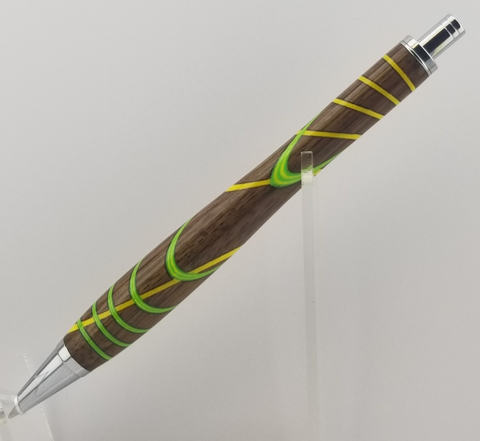

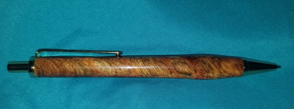

Beautiful work there Mal! The slimline pro pen and mechanical pencil modified removing the center band is my every day carry. It is a nice solid kit and without the band really shows off the blank. I replace the tube with a new one cut to the appropriate length never thought about not putting the tube it at all. I will have to contemplate this. This is the last couple I made.
John

Thanks for showing your pens, John. . I like the way you shape them ... just a little different from the usual.
I particularly like the segmented one on the right, and how you have made the yellow and green "rays" . . I have actually been thinking about doing that kind of segmenting ... you got to "publish" before I have even made any !!! . Congrats ... beautiful work !!
I think that type of segmenting is best done with the brass tube in. . Certainly a long blank is the best 'vehicle' for showing it off !
Thanks, Mal for the kind words. Hope I did not steal your thunder with the segmented pattern. As for the shape I really like the slight bulb at the nib end it makes it very comfortable in the hand. I would agree that it would need the tube to keep it all together and a long blank is best.

... but how does omitting the brass tube(s) affect durability and longevity ???
Honestly, I don't know :rolleyes: ... I think that in many cases the brass tube is overkill and a nuisance (creates the extra work of gluing and back-painting). . The wall thickness in "my" design is about 0.15" = 3.8 mm, each side of center, so I am not very worried unless you are going to drive over the pen with a Mack truck or drop it from the Empire State Bldg. . The wood ones would be of most concern but I am pretty confident about even them. . I have recently been using some strong exotic hardwood burls (Concinna, Corrugatta, Brown & Red Mallee, Desert Iron Wood, Rosewood, Cocobolo, etc., etc.) ... I have no hesitation giving them to my grandkids or selling them to new customers. . The beauty of the long, uninterrupted finished barrel is so impressive that I have no problem giving a lifetime replacement guarantee because I just love making them. . And they are quicker to make than the tubed pens. . The only slightly tricky part is getting the hole of the right depth (1.70") at the top end to accept the click mechanism and hold it from sliding down too far.
