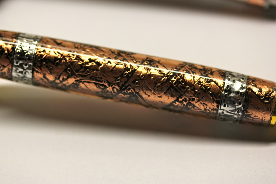

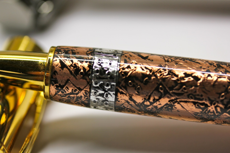

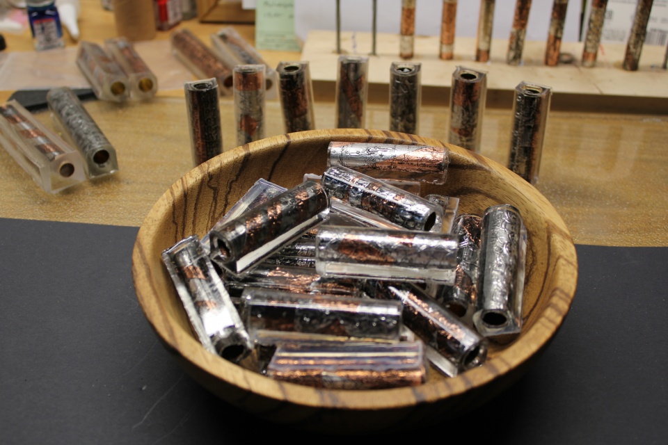

Hi John.. I'll throw your thread a lifeline :wink:

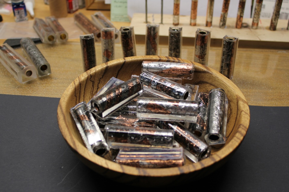

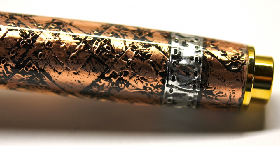

First: Foil Blanks. Very easy to work with the seam - because you don't try to hide it typically.

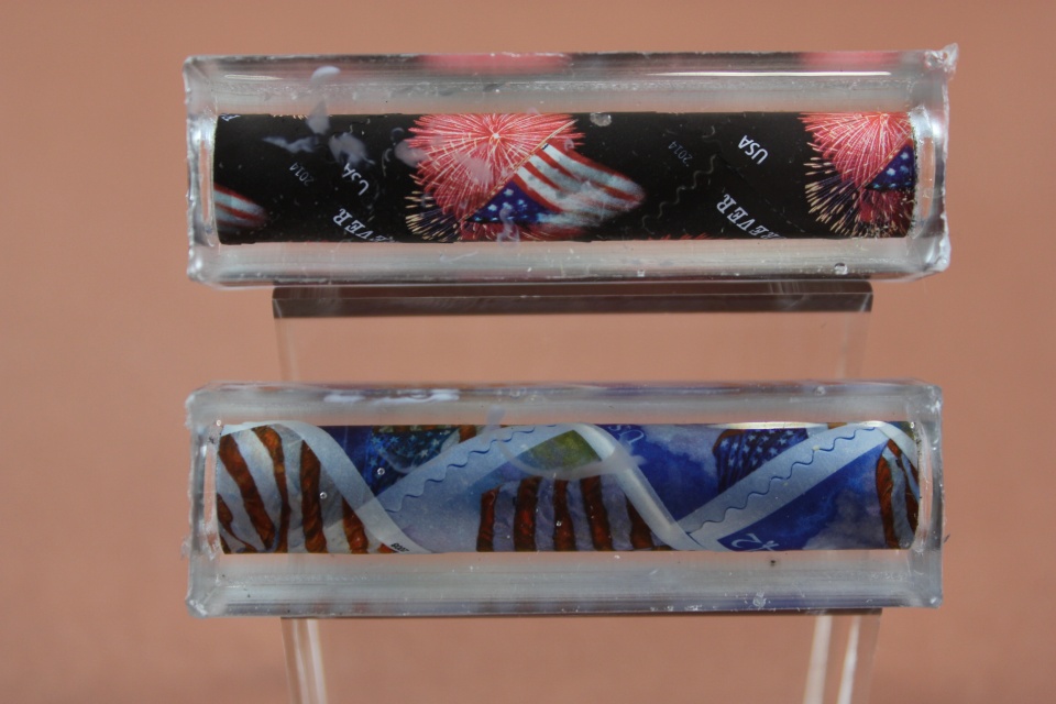

Second: Stamps with perforated edges. You can cut the perforations off, or try to match the perforations. With a slightly rounded blank, this will result in a slight mismatch. If you turn a straight blank, it will look much cleaner.

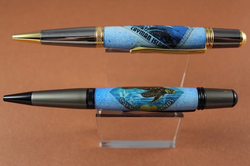

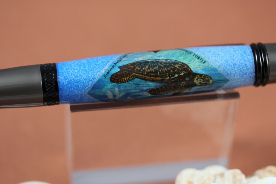

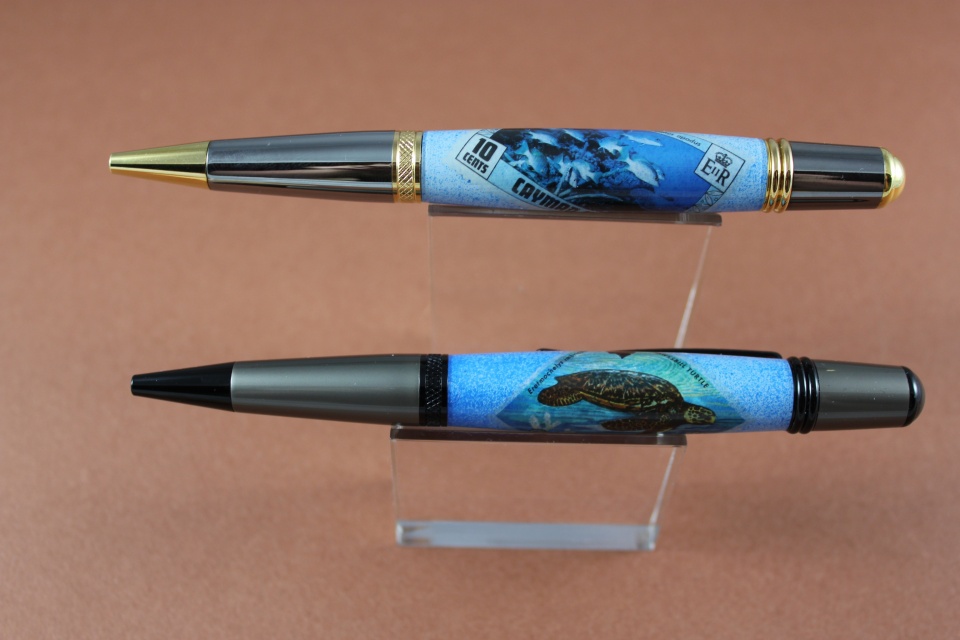

Third: Stamps again. Here, the background was painted to blend in with the stamp background colors. A two-tone paint: (1) Basic Blue; (2) speckled white. Both from an ordinary enamel spray can.
The "seams"/edges are pretty faint. So, try to use the background paint at times.
