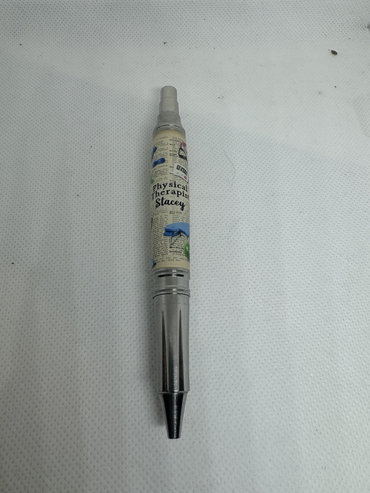

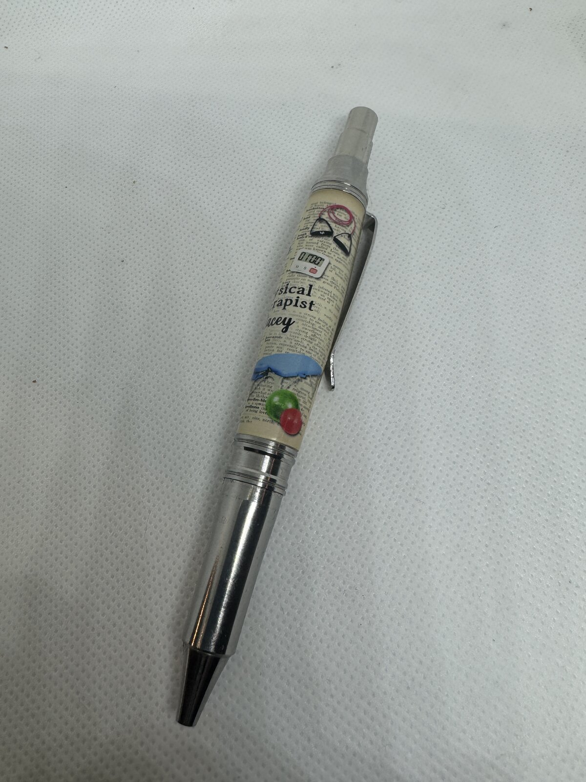

Michelle Bagley at Drop Anchor Creations has a physical therapist blank. For the one I made, I asked Michelle to add my PT's name to the blank. I paired it with a McKenzie Pen Works Liberty click which uses the aforementioned Schmidt SKM192 all metal click mechanism.
Apologies for the poor photos.
