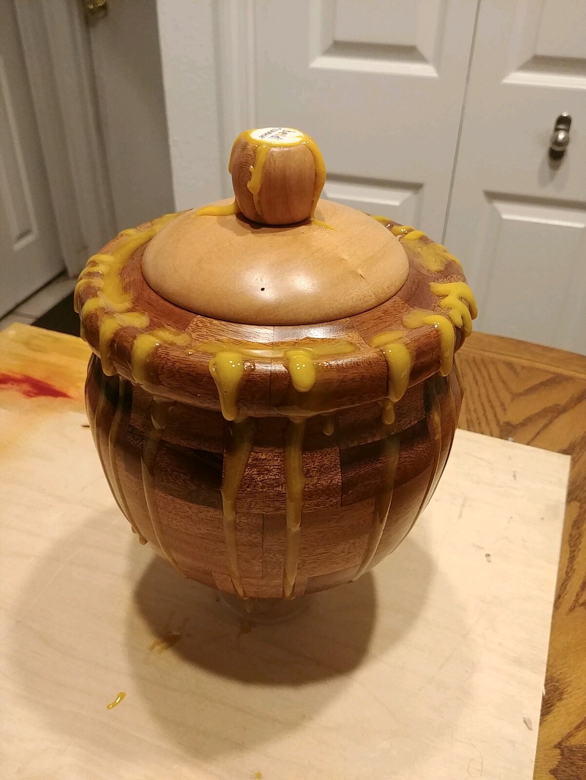

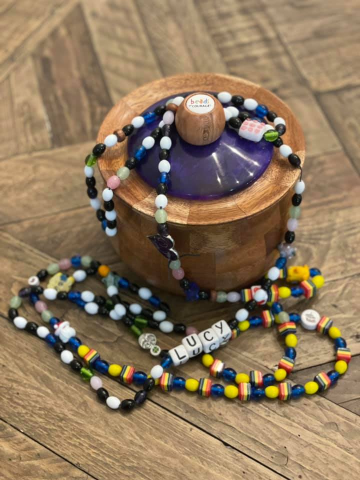

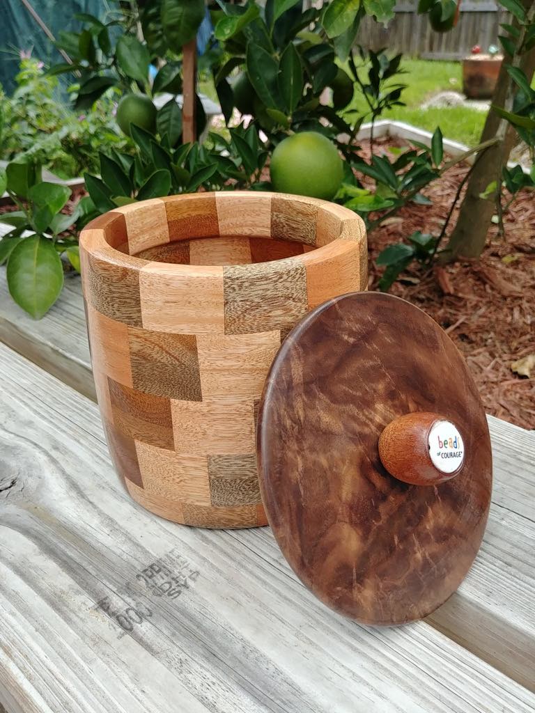

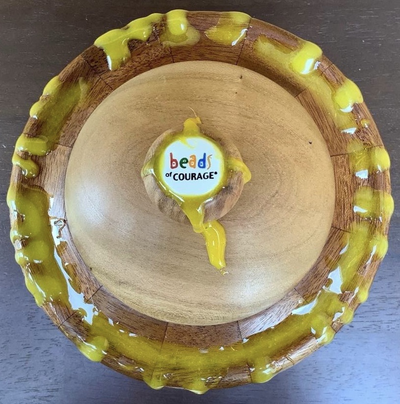

If you are looking to segment bowls or vases and such I would highly recommend the sled above by Peter Marken it is a very well made sled. I purchased none this past summer and have used it to make several Beads os Courage boxes.

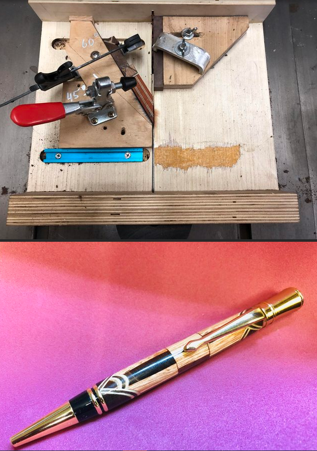

By the way here is the pens that went with that type of blanks.
View attachment 348359View attachment 348360
No offense taken and thank you for the information. Your pen is absolutely beautiful!

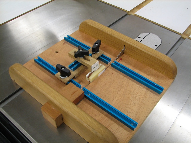

Actually, mine is for the table saw (as I recall). I have found that the rigid thin kerf TS blade gives a more precise cut than the bandsaw jigs I have made. (which should let you know that I've made more than one before settling on this one, which I haven't used in a couple of years). Bandsaw blades tend to deflect when cutting. I tend to jump in with both feet and figure out a way to do something then store it away knowing that I have the technology and can pull it out when needed.

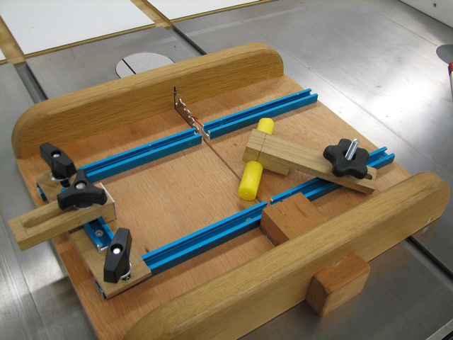

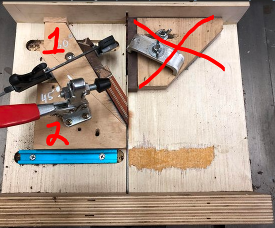

Looking at all of the "commercial" jigs mentioned for sale I don't really see any of them being workable for "our" purposes. It would seemingly take just as long to modify any of them I had to pay for to suit my purpose as it would to build one from scratch with stuff laying around in the shop. Some of them are $200! My cost was $0. The ones made DIY are "purpose" built for one purpose...segmenting pens, but useless for almost anything else.
I'm glad it worked out for you. As the old saying goes... "You got time or you got money". I unfortunately do not have the time.
Understood, YMMV but I think it would take you just as long or longer to modify a commercial jig as it would to just build one from scratch. The two that I posted are both made up of only 5 or 6 pieces of pre-cut wood. If you look at the top one and eliminate the thin-cut maker on the right it's only a small sled, 2 clamps, and 2 pre-cut pieces of wood. (one cut at 45 degrees and one at 60 degrees). #1 is the only moveable part. #2 is permanently screwed to the sled and you don't need the blue track I have on there. Probably about 2 hrs work. It's gonna take you at least that long to make your first segmented pen (after 2 or 3 failures) as there is going to be a learning curve when it comes to actually making the pens.
