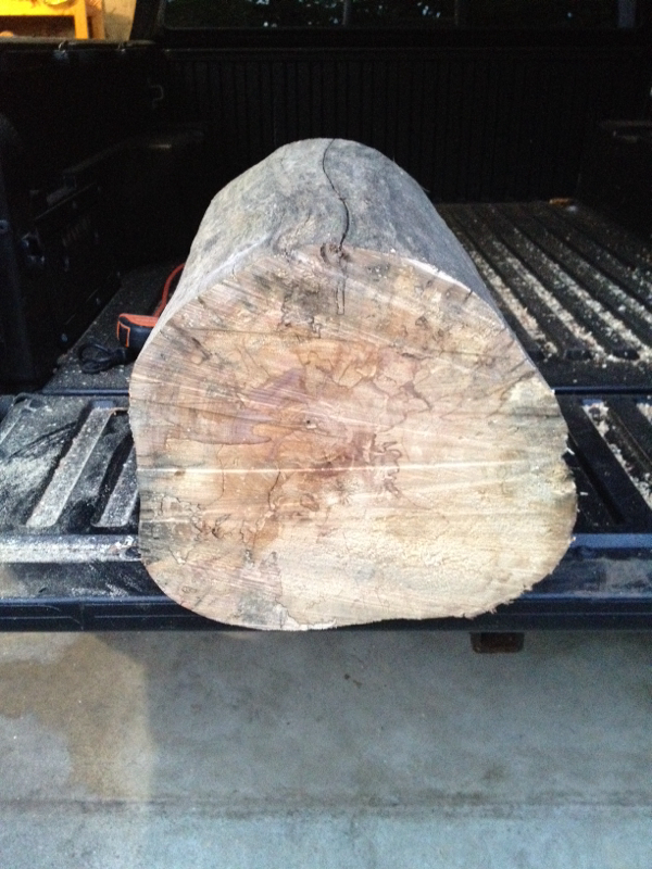

Found this 15"X 25" log cut down the street when a neighbor lost a diseased tree. I cut one inch off the end to see the texture. It is obviously spalted and soft. The question is as a realities newcomer who is hooked on this hobby/addiction how much outlay should be made or not to make this workable as pen blanks.

The wood on a pilot cut of 1" inch looks dry not green possibly spalted and dry rot.

Not all spalted wood created equally. Spalted wood left on the ground or left rotting in a tree too long pretty much useless. Fungal decay left to do it's work, will result in the piece of wood just crumbling in your fingers.
So until you cut that log into slabs and pen blanks no way to tell looking at a picture.
If get some decent slabs cut into blanks try drilling if get that far without wood crumbling try Ed's procedure. I would keep you CA glue handy while turning also.

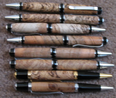

Have turned a lot of spalted wood pens without using CA glue and been successful. Can only remember completing one needing CA glue due to chipping while turning. Wife ended up with it, but gave it away.
