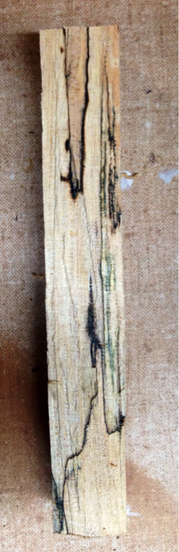

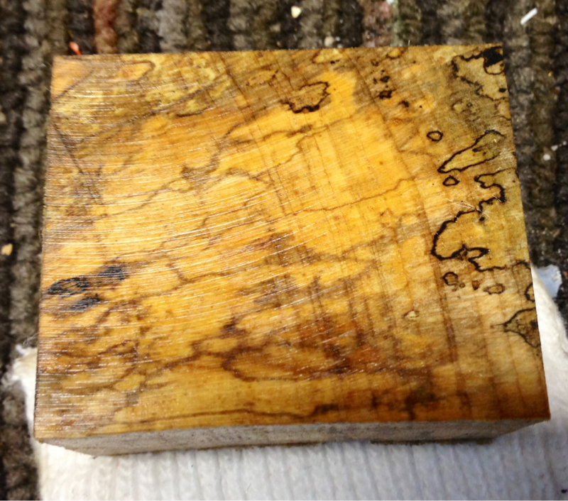

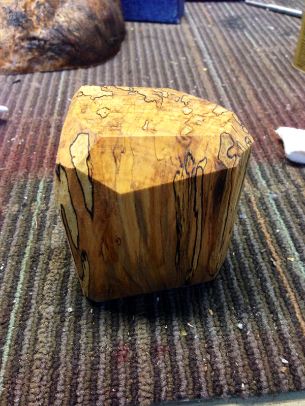

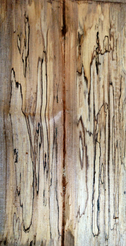

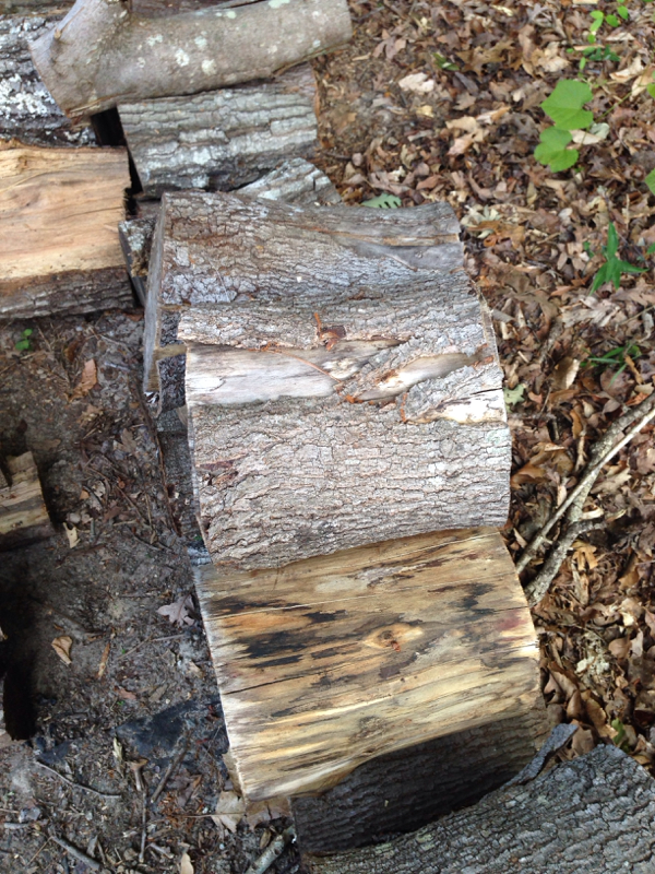

This is kind of a multi question thread. I have been lazy and left a tree cut up on the side of my property too long and when I was chopping it on the log splitter I ran across a lot of spalting. First, I do not have any idea what kind of wood this is so if any one has an idea, please let me know. Second, is this worth cutting into pen blanks? Third, if it is worth cutting into blanks, do I need to do anything to it to stop the rot or will it just remain at the state it is now because it is in my climate controlled shop? I am going to try and add a few pictures of some I cut up and put a little shine on so you can see the grain. Thanks for any replies. Aaron

Aaron; Looks like a maple. There are a lot of good blanks in that piece. The fungi needs heat, humidity, and moisture to continue growing. If you have it in a climate controlled shop you are stopping one or more of these needs, and the spaulting should slow and stop. There are several ways of getting the most out of this wood. You could cut it up into 3/4 inch thick slabs, sticker the slabs, and cut into blanks as you need them. Cut into blanks, sticker them, and place a weight on top to keep them from warping in case there is any moisture left in the wood. Next you could cut into blanks, dip the ends or the whole blank in wax to seal it and keep it from cracking. Last you could cut into blanks, stabilize, let dry, and stack. This will remove the air in the blanks and replace it with a hardening solution making it solid and easy to turn. Any wood left over you can send to me. Jim S
