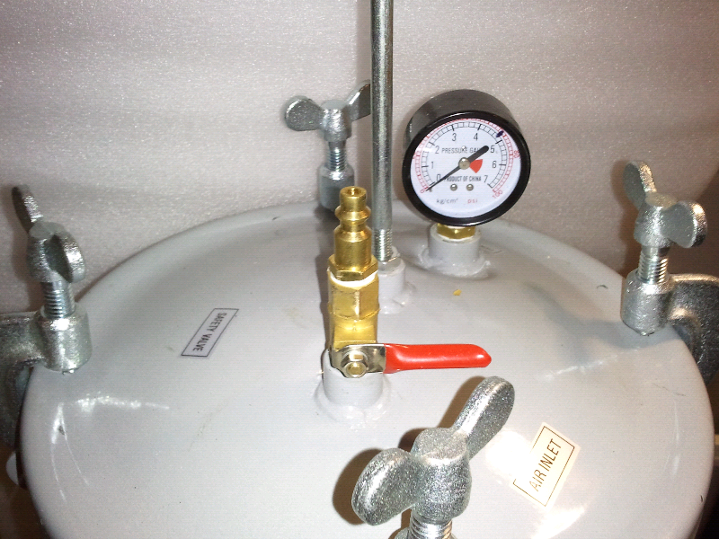

Hi, so I finally fought my harbor freight pressure pot and fittings to start casting, just want to know if this set up is correct?? Also I don't know how to start casting?? I bought some bottles of alumilite and some resin saver molds I also bought a small scale for measuring the alumilite . What else do I need and what is an easy thing to cast and familiarize with casting ?? Any tips/ pointers are well appreciated. Thank you in advance.

Man I hate to do this to people but you need to do some reading and use the LIbrary here as well as use the search feature. Type in the words that correspond to what you want to know. It would take too long to explain and I am sure things will get left out. Don't be in a hurry. Read and be sure to read about the dangers in using those HF pots.

Erik, there are several different ways to set up the HF pots, I prefer less joints/hardware but your set-up will work for pressure. The HF pot will work fine as long as you stay within the pressure limits. I have some older pots that were rated at 80 psi but I believe the newer ones are rated at 60 psi. These pots get a bad rap but if they are set up properly they will work just fine.

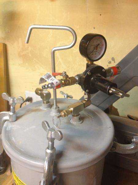

I just bought my second harbor freight pot but I stripped all the fittings from the top and bought a valve, inlet, and gauge and it holds 65 lbs for a 24 hr period, no problem. I gotta say though, I got the idea from Curtis(Mesquite man)

I've read that many people use the hf pot with no problems I even checked the hf website for reviews and even there some people use them for casting with success , I think as long as I follow their safety directions I should be ok . Btw thanks for uploading the picture that sure helped.

I "would not" have "any" presure pot with out a pop off size no higher than recommended for the pot. I am looking forward to hearing all the fun you are having.
"Not" how bad your injuries are from taking chances with this.Do have fun.

Seamus, what does the inside of your tank look like? Do you make any modifications to prevent a blast of air disturbing the resin? I apologize if this is a stupid question, I just thought I heard something like that mentioned once. I have yet to set up my old Craftsman (made by Devilbus according to Curtis) pressure pot.
Thanks!
That is a great question Lenny! Believe it or not, I dont have anything protecting the top of my blanks. There is a "T" on the underside of the lid(inlet port) so as the air comes into the pot it shots to either side of the upper portion of the pot. With that said, when i first started using the pot i would open the valve wide open and let all of the air inside(at 150psi, that is a lot of air really fast), and have since stopped that since i had many failures that I couldnt figure out how they kept occurring.
Now what i do is, open the valve slowly and let the pressure build up gradually. Since doing so my failures have dissappeared!
