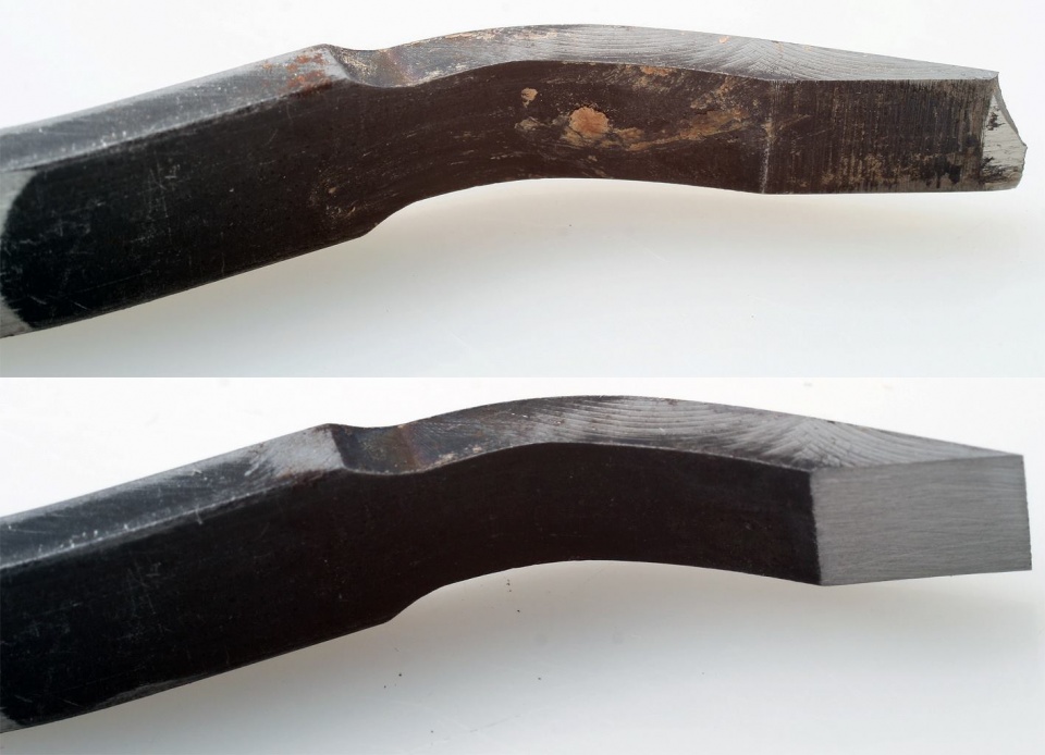

First the chisel is a new skew in HSS steel that I recently bought in a set.
attachment.php
This is how they come from the factory. Yes it can cut but it's like most things, some assembly required.

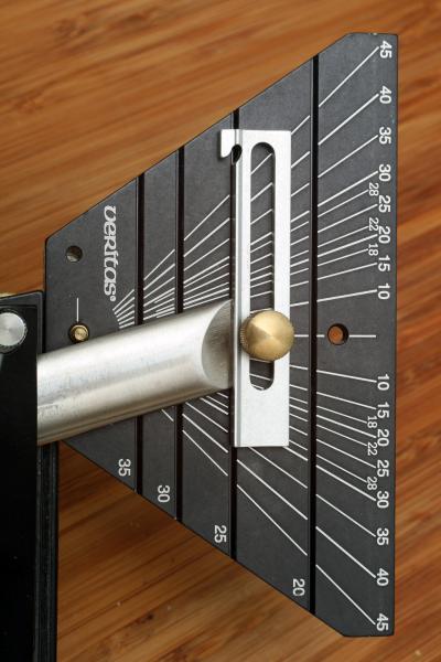

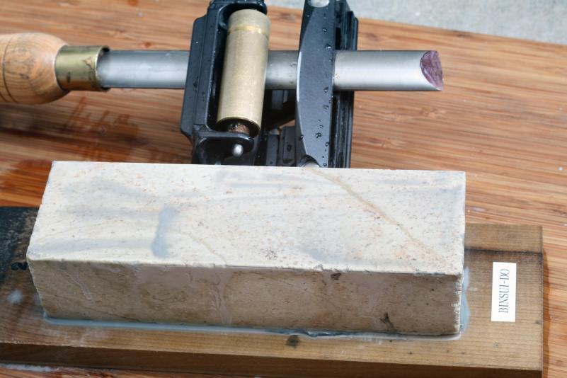

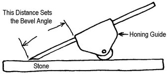

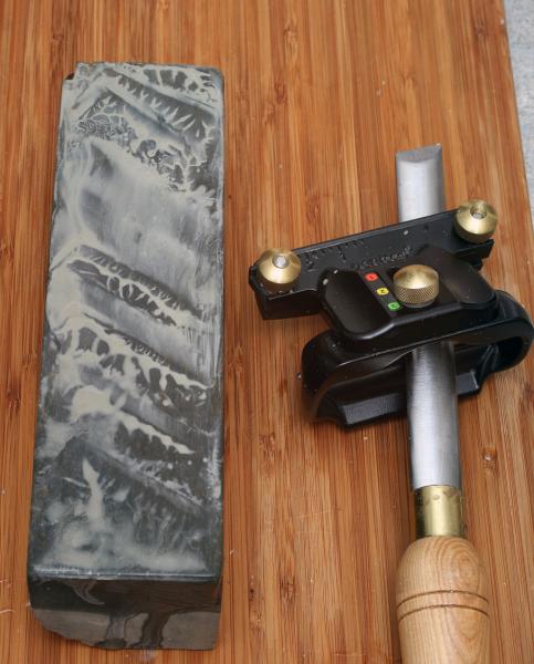

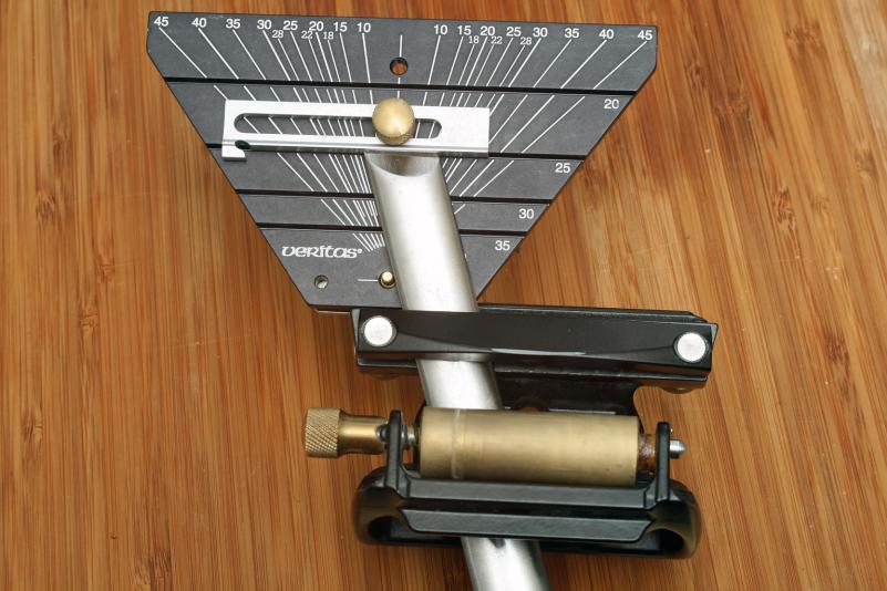

Here we have my Lee Valley MKII hone guide with skew registration jig in place.
attachment.php
attachment.php

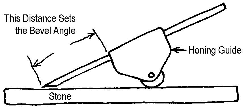

The secret to sharp is consistency. So do yourself a favor and buy a jig of some form.
attachment.php

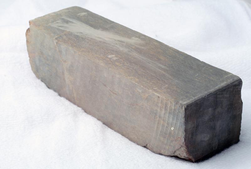

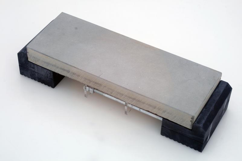

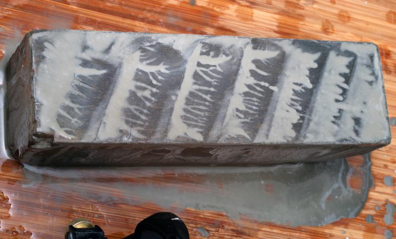

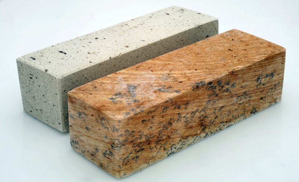

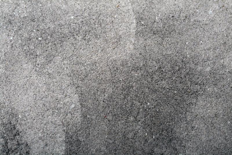

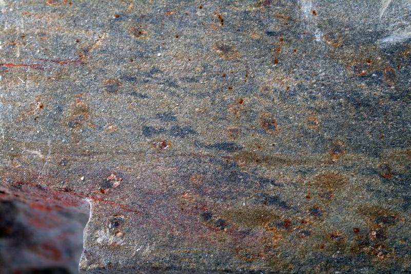

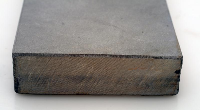

Oh yea this is Aoto, Blue Mountain natural Japanese stone. Approx 2,000 to 3,000 grit range, 5-10 microns. Or so they say. This is a very very fine sedimentary stone and the slurry from this feels like a film. Using this stone literally feels like washing a chalk board, it is smooth and silky. Stones like this is what gives Japanese waterstones that sexy appeal and that calm serene flair.
attachment.php
attachment.php

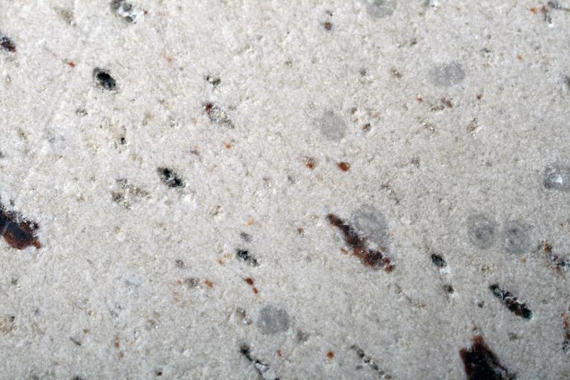

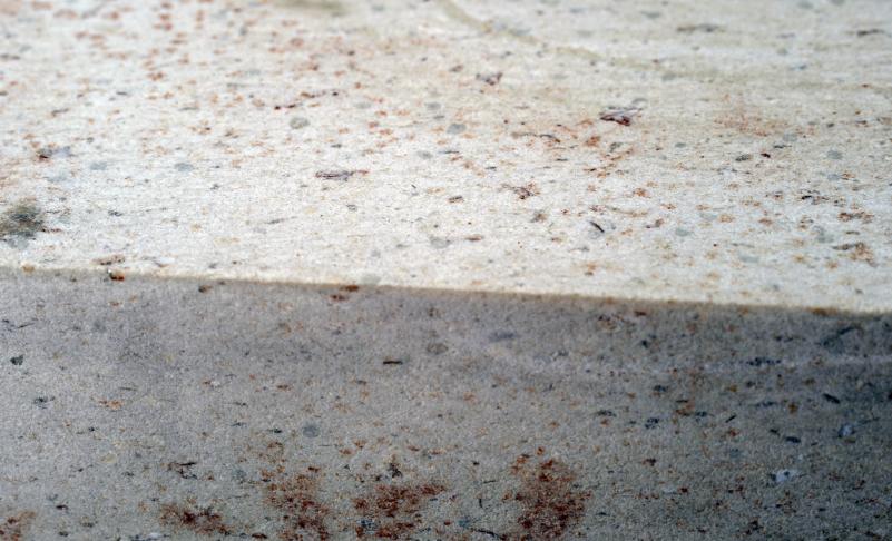

Slurry is made by rubbing another stone on top of the big one. In the above 2 photo's I used 2 types of stones, Omura and Nagura. The white color one (top) is the Nagura, that is around 6,000 to 8,000 grit there about. It helps to remove the finer sediment in the stone. The Omura (bottom) is more of a grinding stone, it is a more coarse grit stone around 150 grit, it brings out the larger grit so you can get a good range of grit from the same stone, try that one with sandpaper! It also flattens the stone. The color here you can clear see why it is a blue stone.

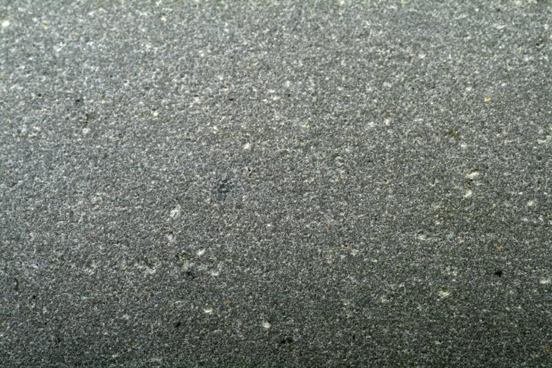

Notice the Su holes or voids, the pockmarks in the stone face, this is gas bubbles that was trapped when the stone was forming however many years ago (read million/billion) They serve several purposes, it traps and holds water and sediment that has broken loose. It can also trap and hold metal shavings from the tool so that must be cleaned off from time to time.
attachment.php
attachment.php

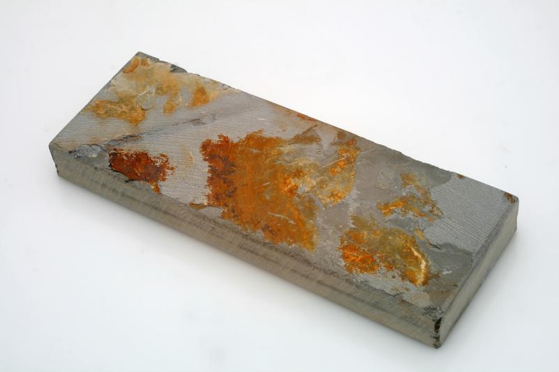

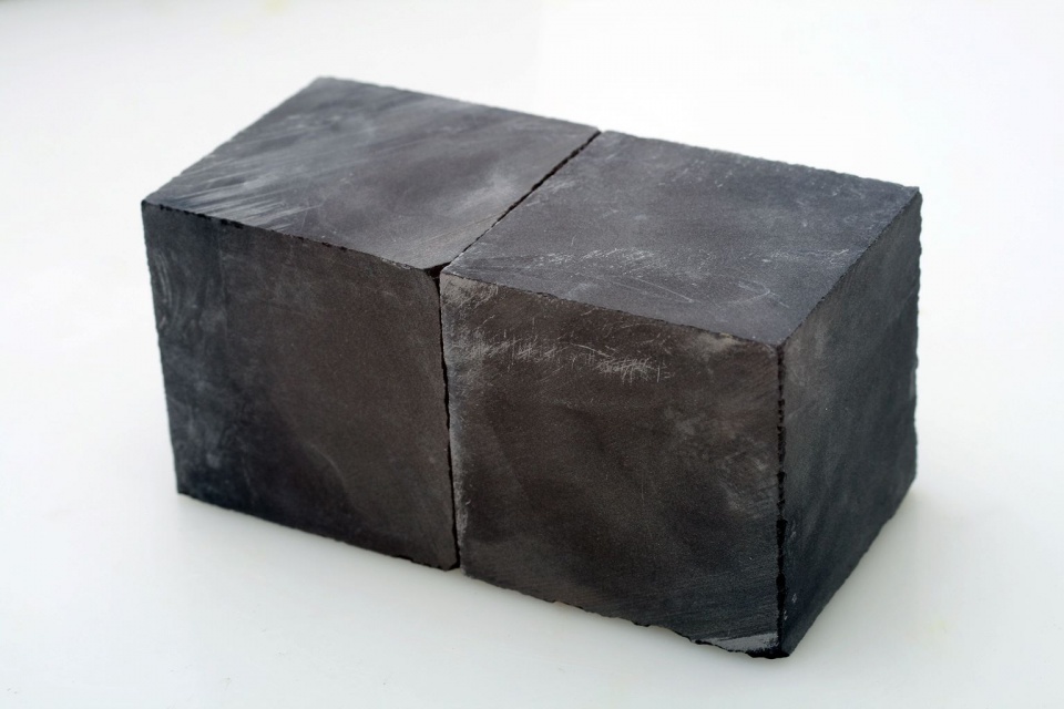

This is a natural Japanese Binsui Stone, approx 300 grit, 60 micron. The slurry from this feels like sandpaper, this particular stone is one of the more advanced stones and not beginner friendly by no means. This is a somewhat coarse grade sandstone.
attachment.php
attachment.php
attachment.php
attachment.php
attachment.php

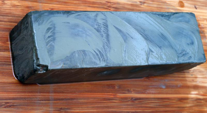

Here we see what the old vs new slurry looks like. The dark is filled with metal shavings from the chisel, some stones like kitayama they leave it on the stone face, others in the slurry like this Binsui.

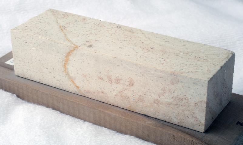

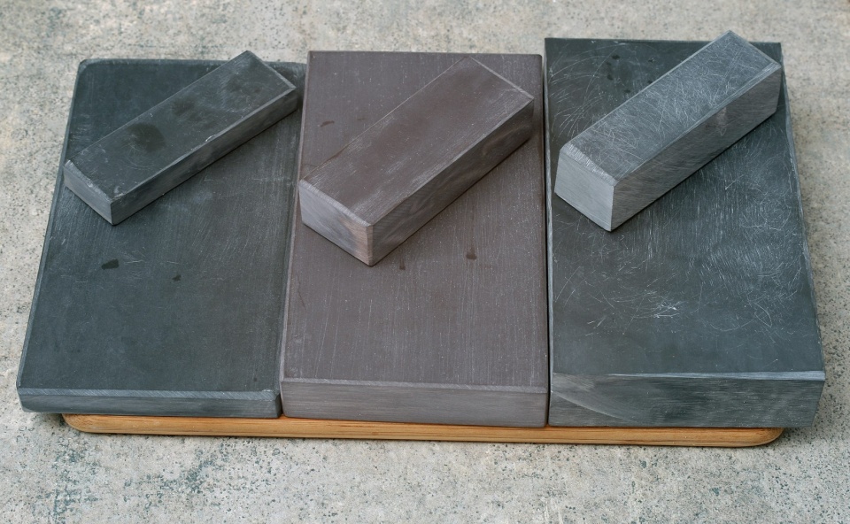

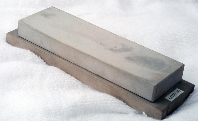

These two is a natural Japanese Kaisei Stone, approx 500 grit, 35 micron. This is a very fine grit sandstone. This stone is a VERY stupidly fast cutting stone. It is over very quickly and you can do some serious metal sculpting with the right work flow. This is like Ao-to (blue mountain) but cuts much faster. Both of these are a dream and a pleasure to work with.
attachment.php
attachment.php
attachment.php

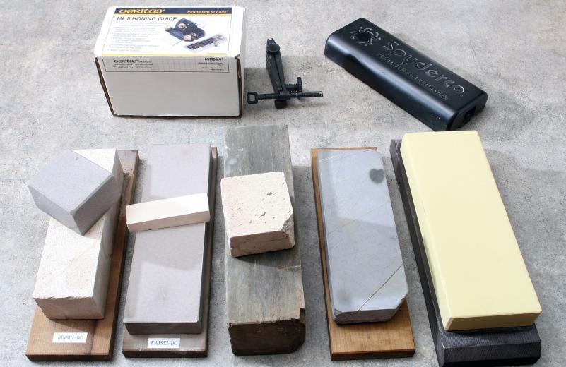

This is a small sample of stones that I have so far. In the back is my MKII hone, a knife hone and the spyderco sharpmaker. The bottom row is Binsui, Kaisei, Aoto blue mountain, Uchigumori and kitayama.
attachment.php

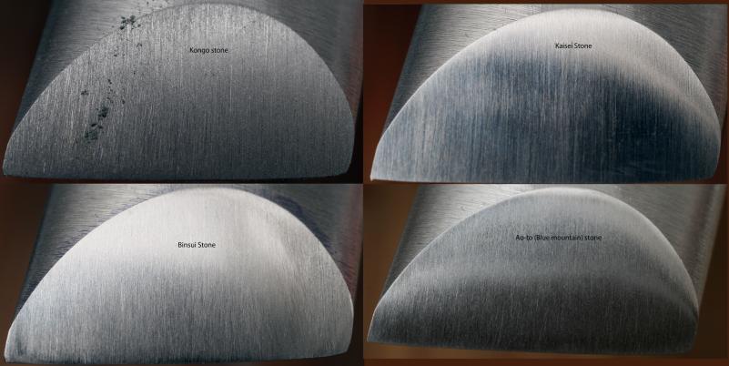

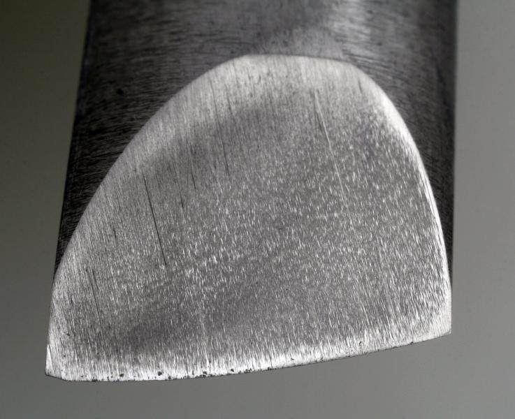

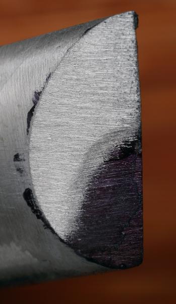

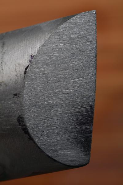

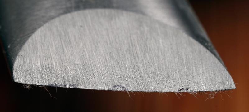

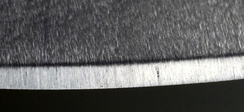

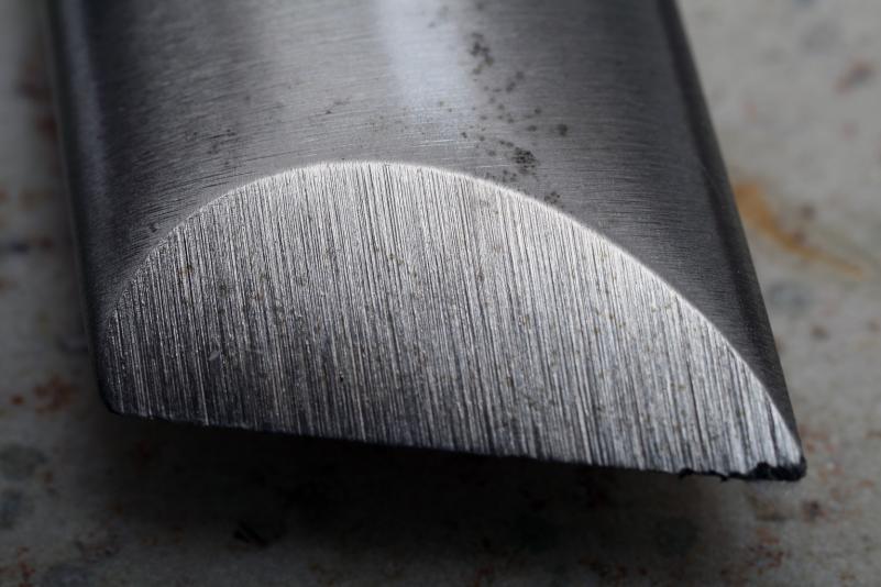

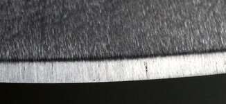

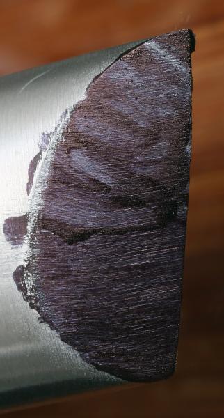

Now lets look at the results they do on the chisel.
Above I posted the starting look of the chisel. Here we have after using the stones.
attachment.php
Image is slightly on the small side but enough to barely make out some problems that I encountered along the way. The most notable is Kaisei and Ao-to needed more truing work, need some more Binsui work as well as there are a few scratch marks still that could be removed. However after using Kaisei there is a very sharp edge, after using Ao-to you can shave with the edge.

I have purposefully left out the final polishing work that is mostly needed on knife and sword surfaces for visual effects. I have added some aspects in but I wanted this to be mostly about sharpening.
As for the type of stone and the type of steel is a very great important factor to consider when you pick which stones to use. Same holds true for man made synthetic stones, if they do not match the progress will be very slow going.
Also all stones requires some type of soak, some just need to wipe water on it with your hand and others need to soak in water. This helps soften them up. What you are looking for is water retention, soak the stone long enough that water will stay on the surface. Synthetic stones with bonding agents need no soak time and wiping them with water will do. Remember each stone has it's own personality and you have to listen and read the stone to see what it needs.
The biggest question that most will likely ask is 'why sharpen this way when 10 seconds on a grinder will work' The answer lies in the fact that a) this is a HUGE stress relief b) it is soothing c) it allows you to sharpen in ways you have never seen before d) you really get to know your tool and e) it is fun and enjoyable.

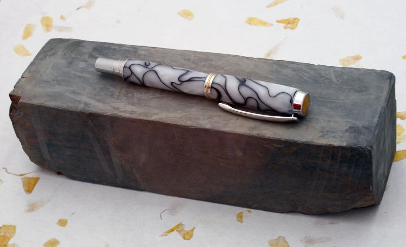

This is a gent on my Blue mountain stone.

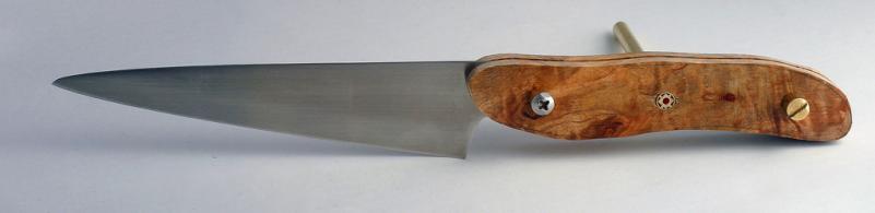

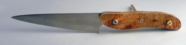

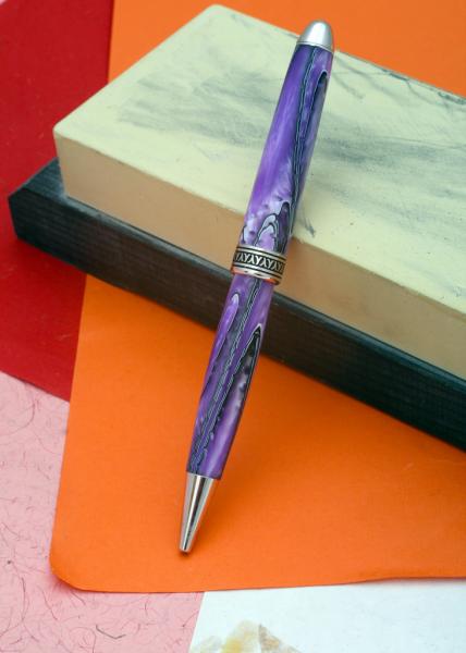

This is a rhodium euro in grape fury that I made.

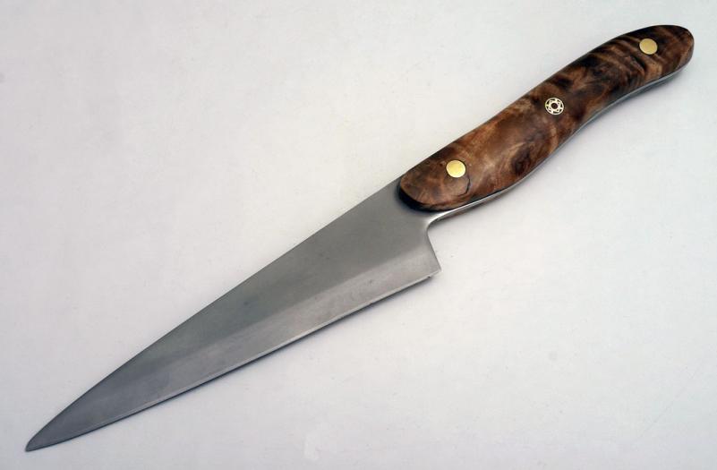

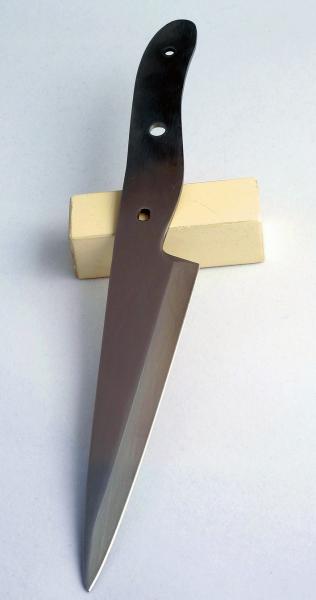

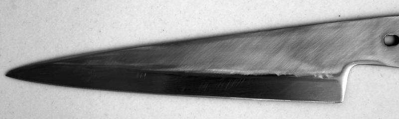

Here is 3 images from a knife that I made. The blade is one that I bought from a knife supply company. The blade also is flat with no contour and I wanted one on there. Here I used Kaisei and chu-nagura and koma-nagura then bead blasted it.
This is the blade at the start.
attachment.php
This is the blade after the kaisei stone.
attachment.php
This is the final blade structure after nagura. The stone it is resting on is a nagura stone.
attachment.php
Oh and final finish.
attachment.php

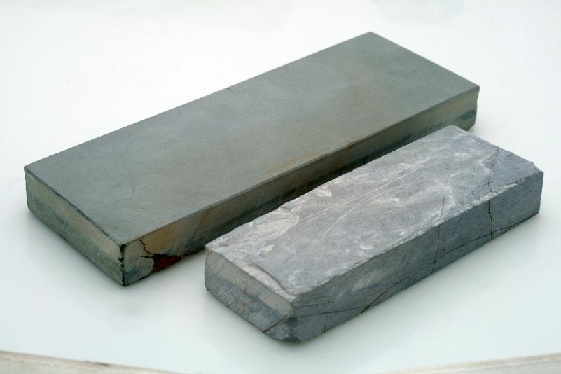

The three brackets is knife, tool, razor. The difference is hardness, not to be confused with grit size. Stones that are suitable to yield you very fine grit being Awashi, Karasu and Hon-yama. There are synthetic stones that is in this range but they don't come close to the real thing. Kitayama is an 8,000 grit finishing stone, meaning it is the LAST stone you use even if it's 20k grit.
Before I start one thing that I did neglect earlier was some stones benefit from a stone holder. There are various styles available. Many stones will already have a wood base they sit on and the rest you are likely to need a holder not only for movement but support of the stone to prevent breaking, cracking and the like.

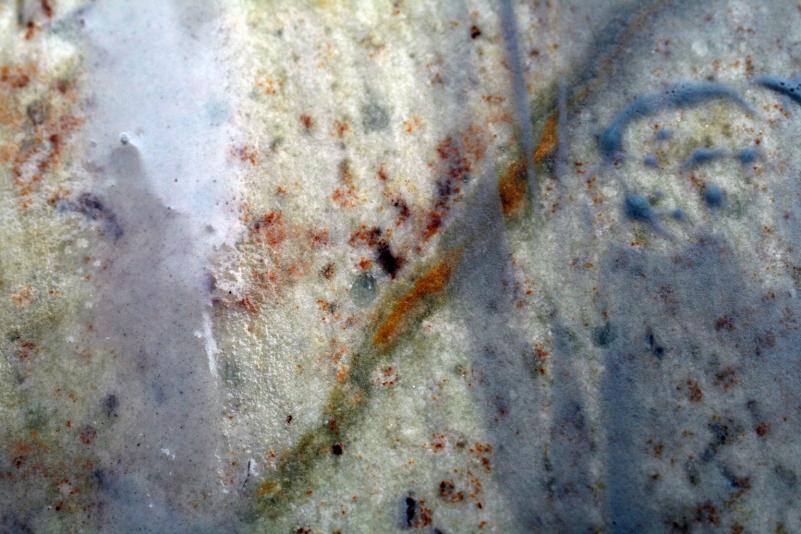

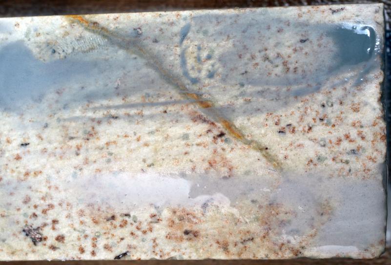

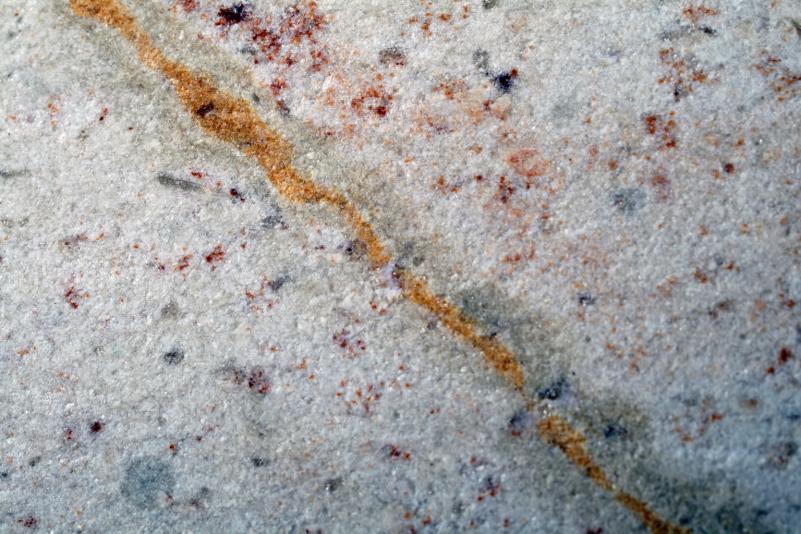

Ok. Say hello to Hon-yama Awase Toshi (Hon's mountain finishing stone) This stone is approx 0.5 to 0.75 micron, 10,000 grit size, somewhere there about. But for the most part that does not really matter, it's more about what it can do for us. Long story short this stone is very aggressive. This particular stone is also softer which means more knife and tools rather than razors Working on this stone is pure amazing. Think of this stone as a block of hardened chromium oxide, Linde C compound, Moor white ceramic or similar buffing compound, cept this stone does not wear much at all but does a hellacious job on sharpening and yields a pleasant patina . This is also in the buffing region.
attachment.php
Earlier I posted Uchigumori which is remarkably similar in layout to this one. While Uchigumori is 4,000 grit this one is around 10,000 grit.
attachment.php
1:1 macro shot, the width here is not quite 1/2" wide.
attachment.php
Note the inclusions on the bottom.

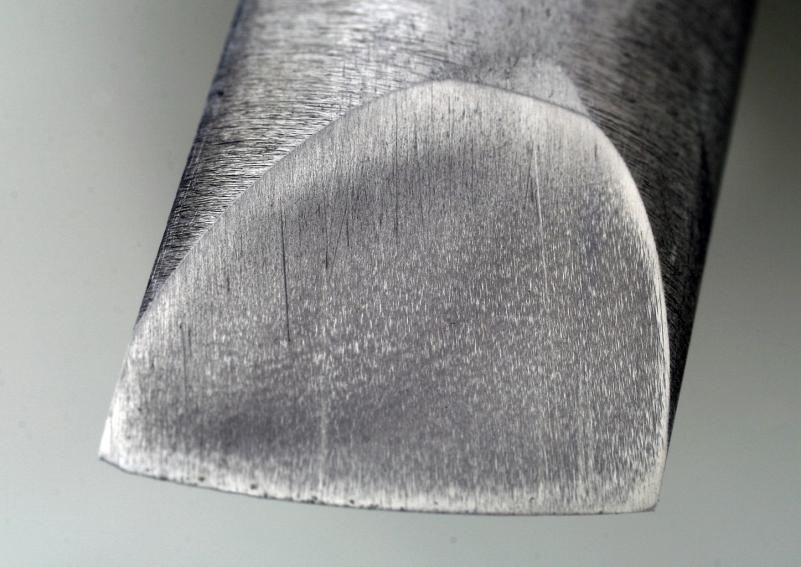

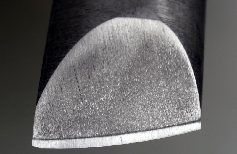

Now, After sharpening a 1/2" oval skew that I have (this is from the Benjamin's Best Midi set) I was able to shave with the chisel. Not just any shave but hair popping sharp.
This first one is after Hon-yama. There is a unique patina to the metal. Also worthy of note is the deep scratches going top left to bottom right. Since this is more of a false edge I left it, besides you would really have to look for it to stand out. Second note is the cutting edge itself. That part needs some attention.
attachment.php
attachment.php
After a micro adjustment on the jig to form the cutting edge this is the results. This is also hom-yana still.
attachment.php
Zoom in shot, this is around 0.16" wide.
attachment.php
Keep in mind to the back slope is useful in chip clearing as well as eye candy/visual appearance. On this project the chisel is 1/2" wide and 1/2" slope which had to be changed. I used a 25 degree bevel and an 18 degree skew. This chisel has never been this clean and was one of the first chisels I started out on several years ago.

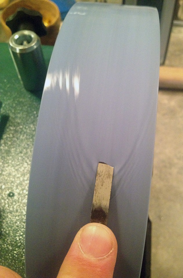

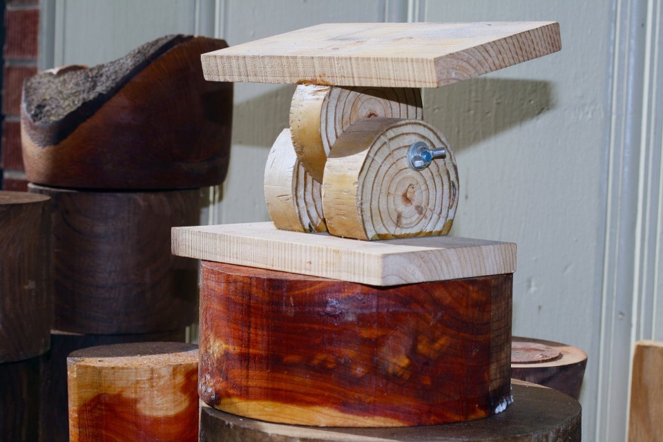

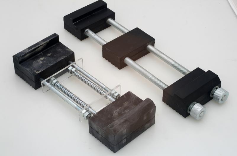

Jigs need not be complicated nor expensive. They serve one purpose, hold at a consistent angle.
Some low-tech solutions are just as viable as very costly solutions so don't overlook those options.
Here we have a 'low budget' jig that I made for a bench grinder. I used scrap 2x4 and 4x4 pine. The 4x4 was turned round and sliced into 3 wedges, then one section sliced off into a D shape. Glued to the flat 2x4 for the top and bottom. The angle is adjusted by a lag screw

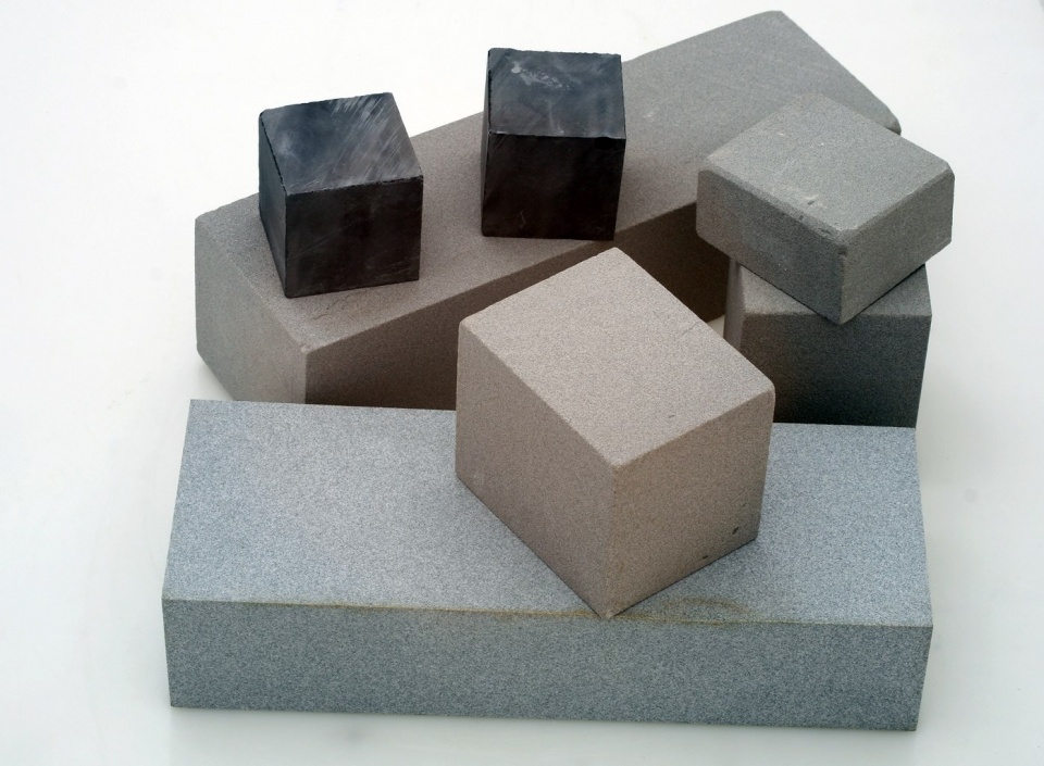

Some additional stones
attachment.php
Tsushima Natural (top left 2) 6k-8k grit, rest is Omura, bottom front is man made Omura. 150 grit

Tsushima is more of a slurry stone. Omura is mostly used to grind other stones and more used in sword polishing. There are several grades of Omura in the photo, each has different hardness but the same grit size.
Wet grinding.
This is not a modern approach, been around several hundred years and not much different except there is a motor, smaller wheel and package. No heat buildup and not labor intensive makes for a good setup.
attachment.php
before/after sharpening on the wet grinder.
attachment.php
One key part of sharpening is cleaning the chisel, BEFORE it comes in contact with the stone. You want it as clean as possible, no oil at all.
Other things to consider is slate. Some slate makes excellent stones. These are Welsh.
attachment.php
