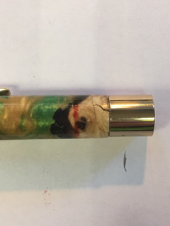

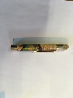

I just bought this gorgeous blank from Ankrom Exotics. Took my time turning it and finishing. Then for some dumb reason I went to press it together with the nib installed on the adapter. It cocked to the side and bent the tube and broke the blank.
I mended it and glued it as best I could for now.
The only idea I have come up with so far is to take off about 5/16 in and use a Fisher Space pen refill. My concerns are that I am taking out a beautiful part of the blank, and it may look kind of stubby.
Any other ideas?
The red line is where I would have to cut back to for the new refill.

Put it back on the lathe, use a parting tool to take off the cracked part, down to the tube. Remove the same amount from the other end of the tube and insert a "feature" piece of opaque acrylic--green would look great, but brown or black would do, depending on what you have available.
One rendition of an "oops" ring.

Thanks Ed. You had time to help me out and get my order shipped out this morning.
I will keep an eye out for something that will complement the color in the blank.
For now I am just carrying it as is and keeping my options open.
I'm kinda leaning toward using the shorter refill.
