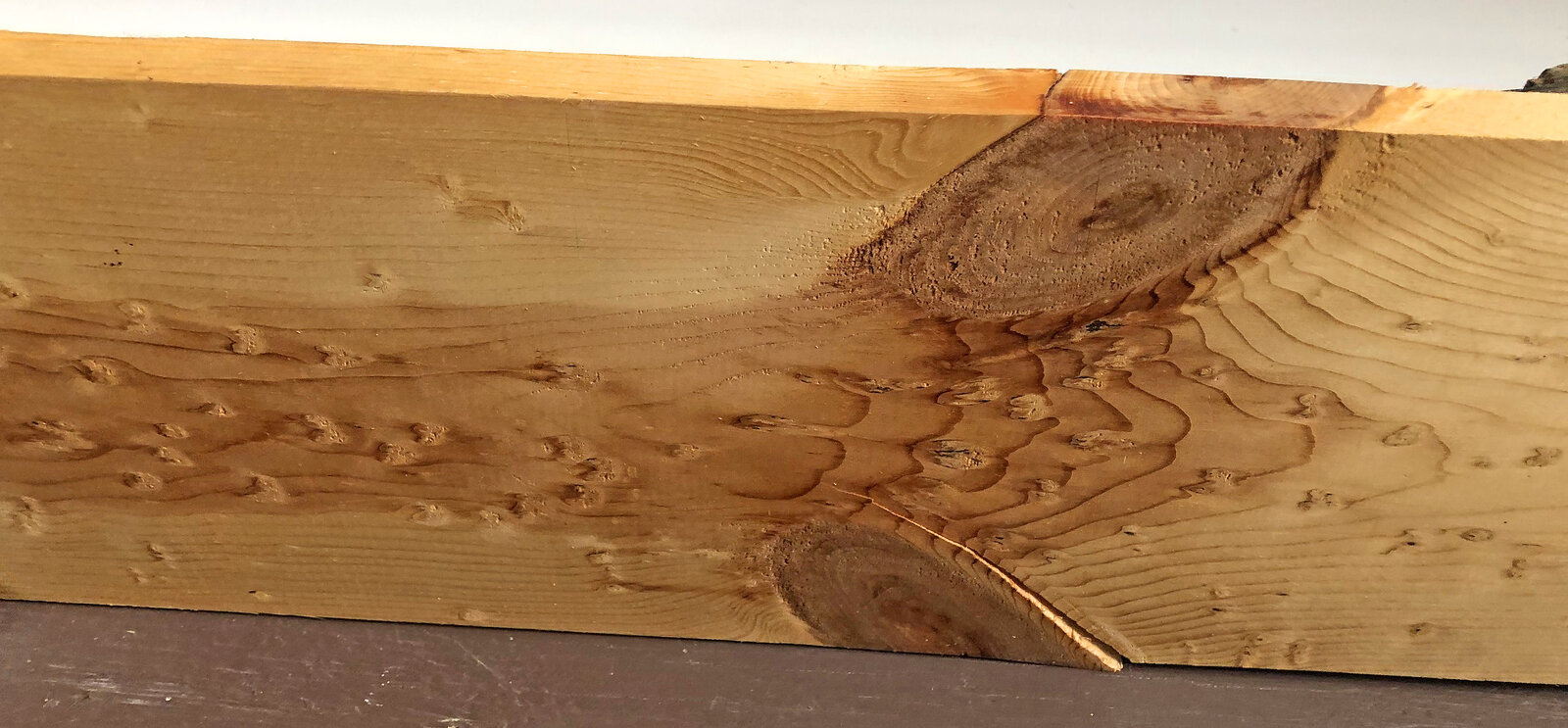

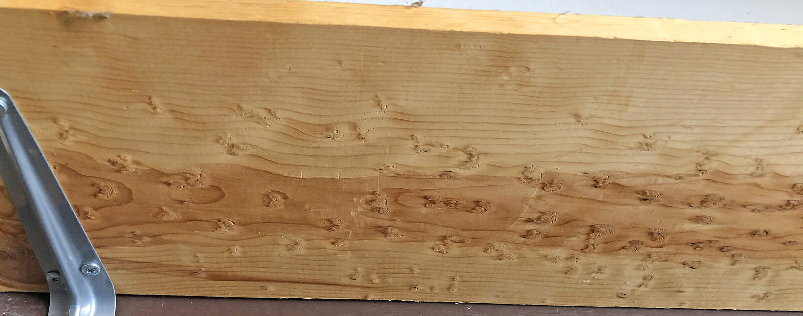

Here are the pictures. I suppose I will need to buy a new board and pull this one down to cut it into blanks. - Dave
Yes , sometimes a person has to make the difficult decision to buy a replacement board . Given the 8 inch width , you have quite a bit of scope for experimentation . I certainly wouldn`t cut the whole thing up immediately . Try lengthwise , xcut and angled on the sapwood portion to start . Just turn them cylindrical , sand and finish as you normally would , see what you get and go from there before starting a pen .
