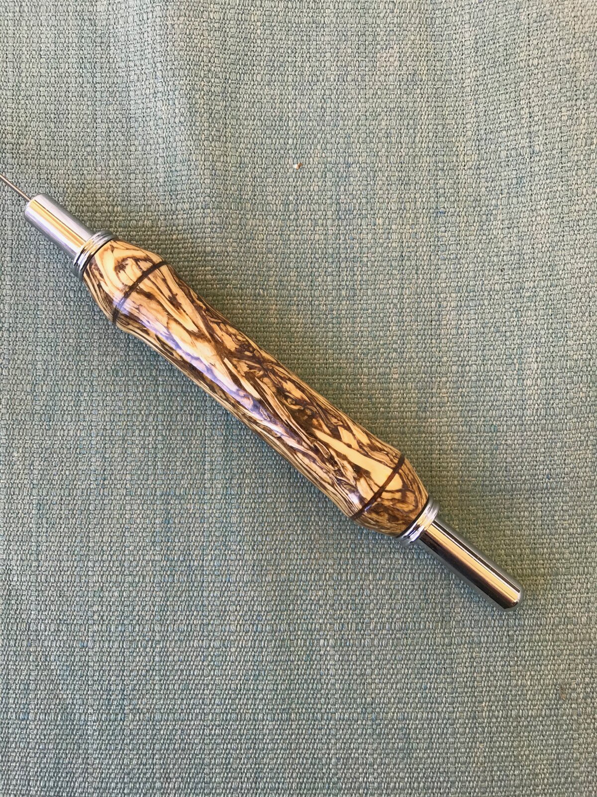

My good friend. Jim gave me couple blanks of Hemp wood of which one I turned as a seam ripper. Lot of problems working with hemp. wood starting from drilling and keeping alignment of the hole, Drilled on lathe with collet chuck got it done but not easy.. Turning is a new experience as the wood fiber require several soaking of CA to get a half way round blank. Now when blank gets to size then there is more CA sanding work need to do for building up a smooth non ripple finish.
For me I would pass on this material and there is so many great timbers out there to turn. Just my twelve cents worth.

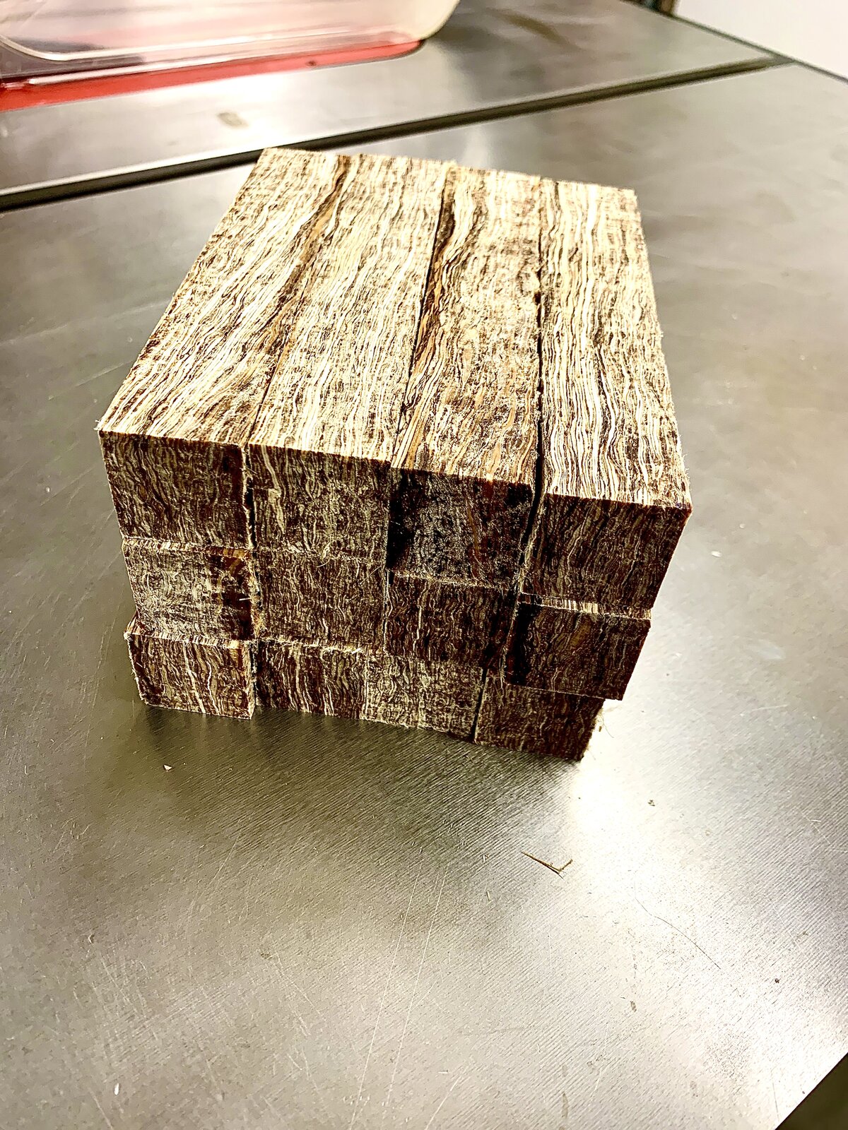

I'm currently stabilizing a batch of Hempwood blanks. I'll report back if it makes any difference in how they turn. It is indeed a difficult composite to work with. Not for the faint of heart, for sure!
I have stabilized several and it does help keep fibers together. still need super sharp skew on the shear mode.

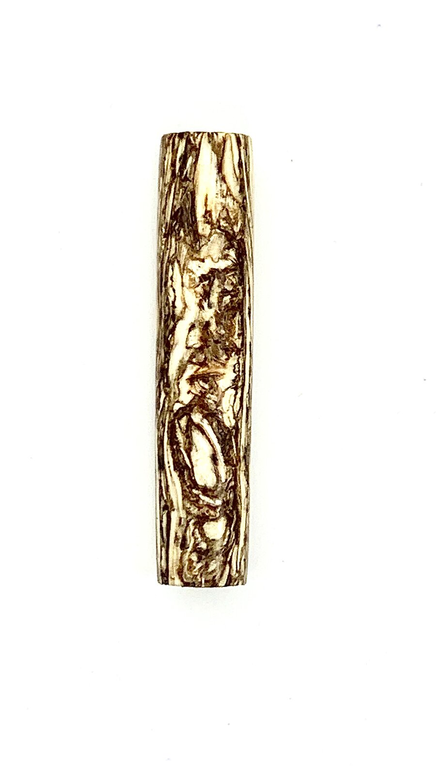

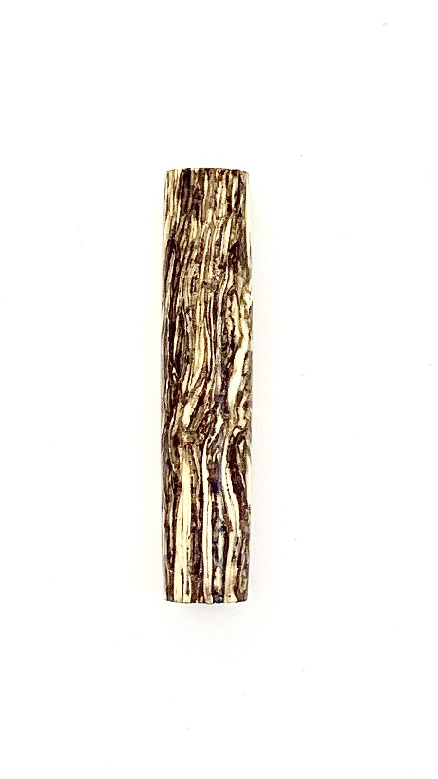

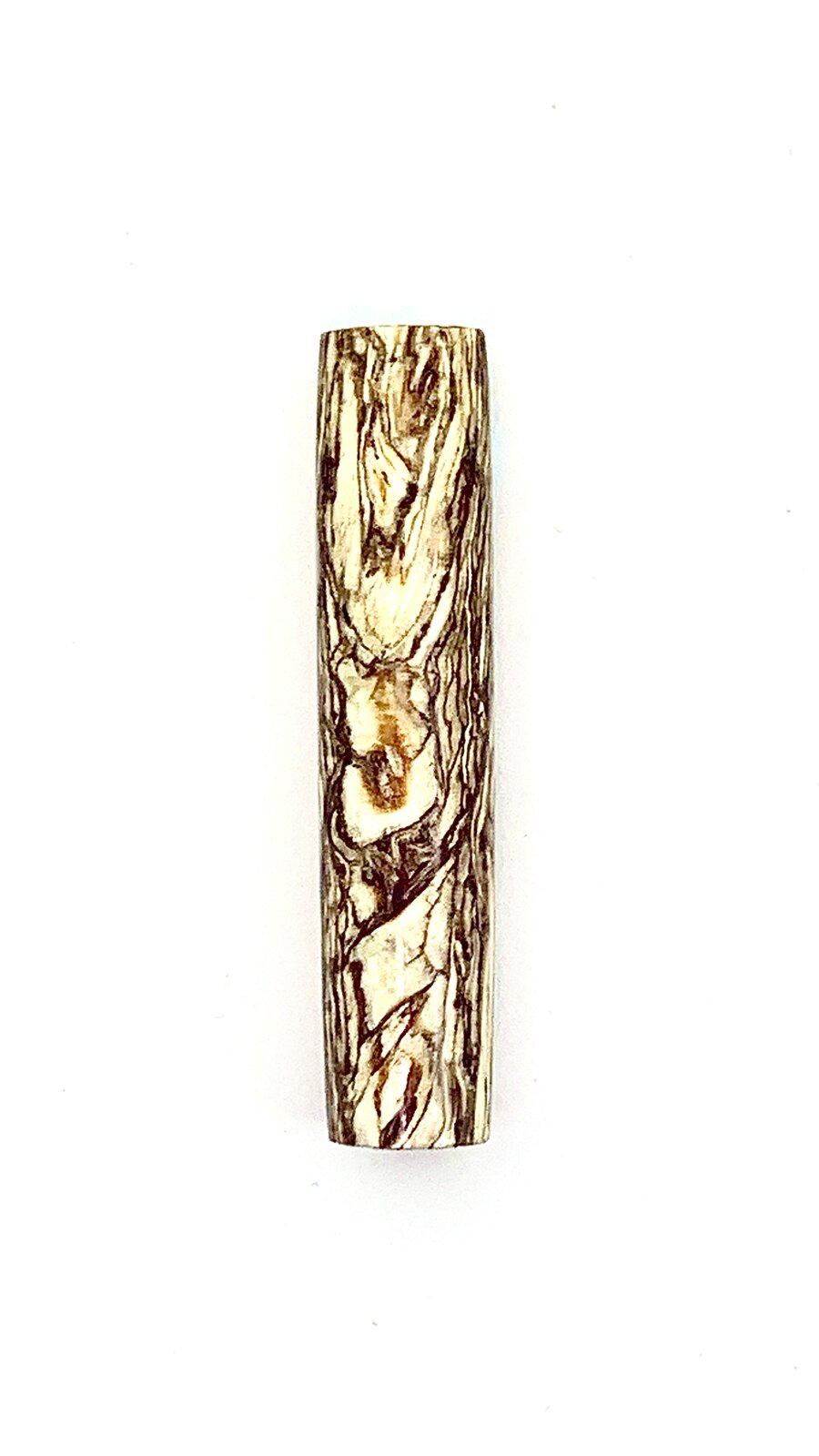

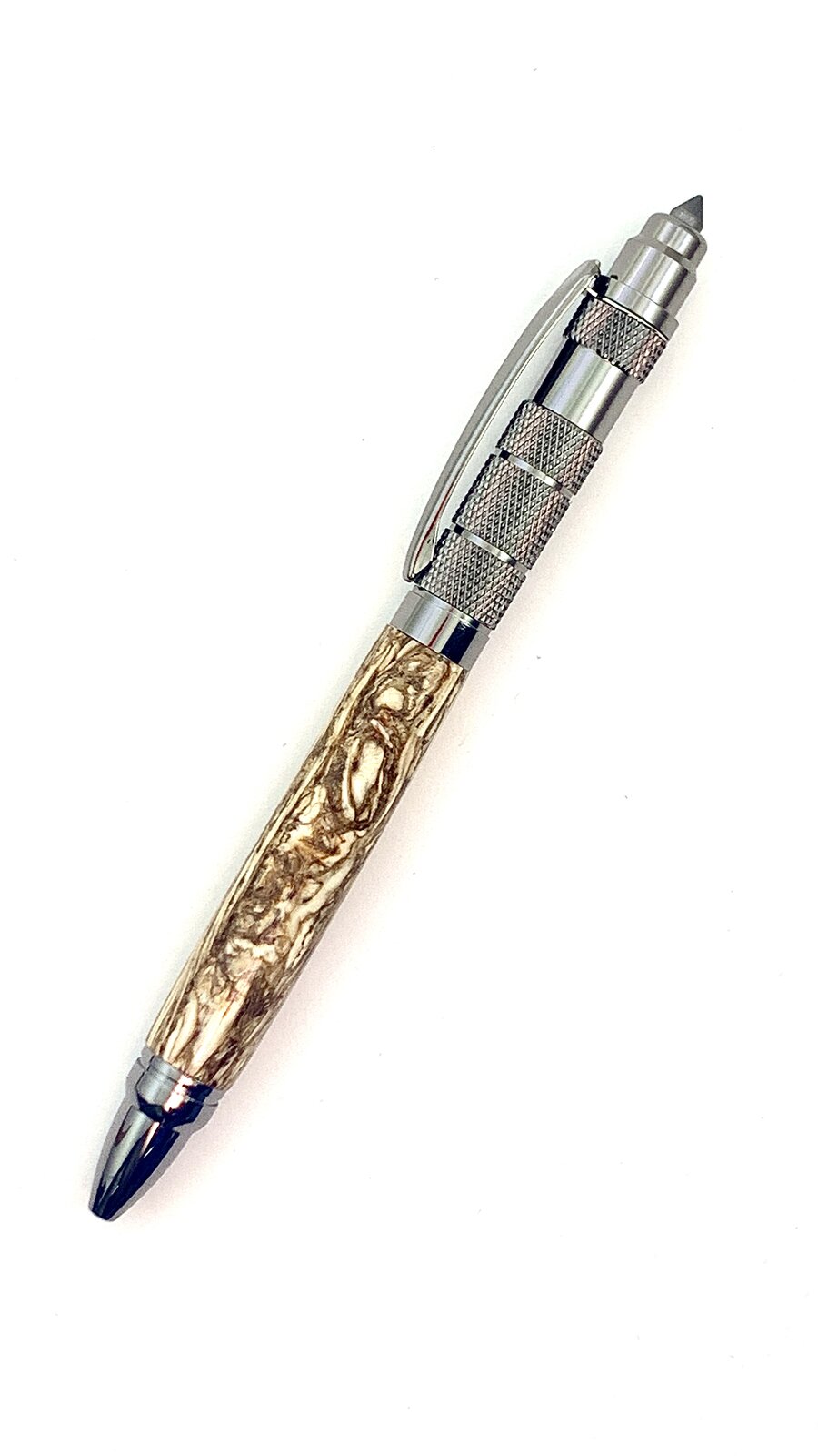

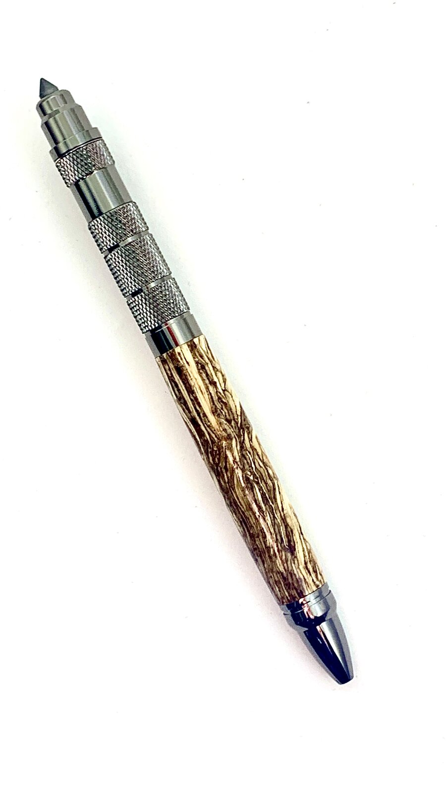

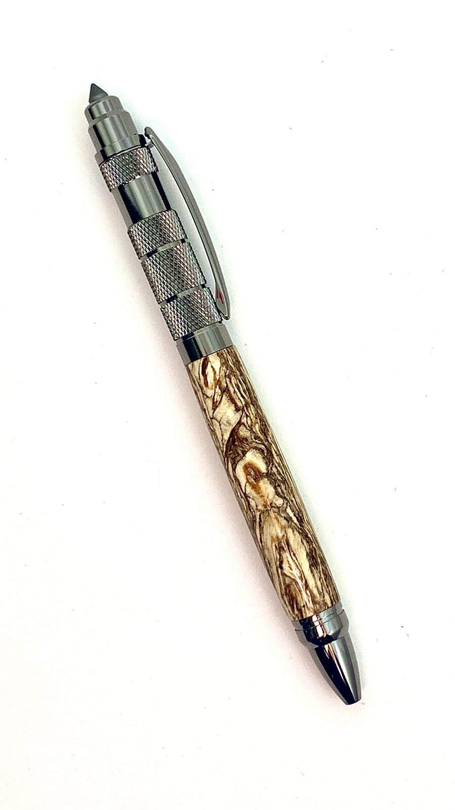

I turned some of the stabilized Hempwood over the Memorial Day weekend and it was a successful endeavor! It's critical to start from the middle of the blank and work out. Razor sharp traditional tools work best and slow, methodical, thin cuts produce the best finished product. I sanded from 220g all the way to 600g, followed up by applying a GluBoost CA finish followed by a Micro-Mesh wet-sanding and then a six step Magic-Juice polishing regimen. It produced a glassy, hard finish as you can see from the pictures.
Stabilized Hempwood blanks are now available in my Etsy shop by clicking here:
