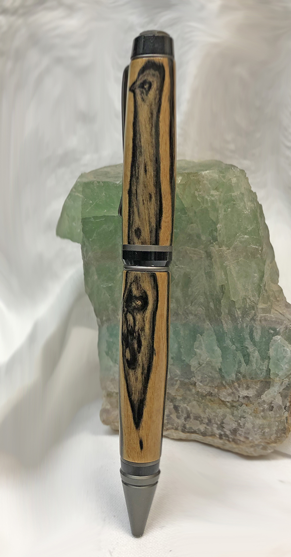

I was going through some of my pens recently and found that one of my favorites has developed a crack. It's not a horrible crack, but still it's a crack. I made it in October 2020. I don't know when the crack appeared. It is a gunmetal Cigar style and the blank is Black and White Ebony.
I am planning on knocking it apart to sand down and re-finish the upper tube which is the one that is cracked. I don't know how long it will take for the crack to worsen or re-appear, but I am going to give it a go. I've always liked the pattern in the blank. It reminds me of an Ostrich or some kind of bird with a long neck.
Wish me luck.
Dave
PS The thought of cracks developing has kind of put me off on using Black and White Ebony (or any Ebony) in the future. It is such a cool wood though. In addition to the Black and White Ebony from Laos, I have some Gaboon Ebony from Africa and Mun Ebony from Laos which is considered critically endangered and is no longer exported.

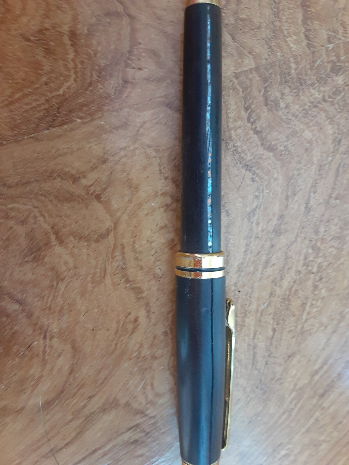

I made this pen out of ebony, at least 20 years ago. I made it my daily carry. Within a few months, both parts cracked. At the time the upper tube was a hairline crack. The bottom tube was worse. I had some crushed turquoise product from Craft Supplies that I filled one of the cracks with. Here after 20 years the repaired crack is still good, and the upper crack has opened a little more, Glad I still have it, but it did take a while to find!
