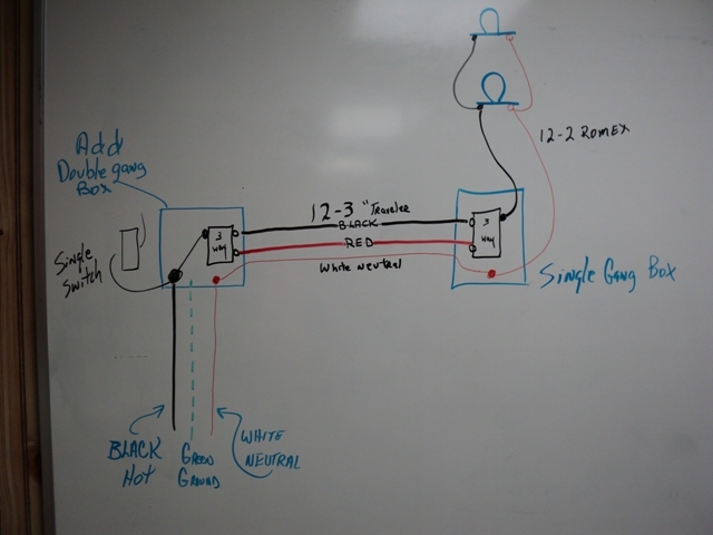

I want to hook up a 3 way switch to my garage lights. I have a single swirch now my the garage entrance from the house. I want to put a switch by the back door from outside. The power is feeding into a switch (from the bottom of the box) for the security light by the backdoor out of the top on one side. Then from the left side it goes to the garage light and down to the switch from the house. Hope this make sense. I can incl pictures in the morning. I googled some diagrams of how to do it but my situation seems to be different. They all show pwr coming either to a single light or switch. I understand about the 12/2 and 12/3 wire and 2 gang box. I am just confused how to add a 3 way and have pwr go (in two directions) to both lights.

3-WAY SWITCH
Disclaimer: Follow all local codes & use box connectors and/or conduit or
BX Cable if indicated.
1). Add the double gang box where your existing switch is and a single gang box where you want the other 3-way switch.
2). Run a piece of 12/3WG Romex from the double gang box to the single gang box. (Again: Use conduit if required by local code.) We will call this wire the "Traveler". Then, run a piece of 12/2WG from the single gang box to where you want the 1st light (probably a 4" octogon box).
3). Use wire nuts & connect a short black wire from your incoming power
source (black is supposed to be hot, check with a meter) to the different colored screw of your new 3-way switch.
4). Connect the black wire of the "traveler" to one of the other silver colored screws of the 3-way switch. Connect the red wire of your "traveler" to the other silver screw. Also, connect the white wire of the traveler to the incoming white neutral of your power source.
(obviously also connect all of the green colored or bare grounds together and ground all devices)
5). At the single gang box, connect the black wire to one of the silver colored screws & the red wire to the other silver colored screws.
6). At the single gang box, Connect the Black wire of the 12/2WG (going to your light) to the different colored screw of the 3-way switch and connect your two white wires together with a wire nut.
7). At your 1st light you connect the Black & White wires to the device and then you can run another piece of 12/2WG romex to your second light and connect the two wires there. Again, don't forget the bare or green ground wires & ground each device.
hope this helps.....Again, follow all local codes & if in doubt, call a qualified electrician...
Correct!
If he wants, I have several switches lying around, I thought about actually taking a picture of them with the wires connected correctly....:cowboy:
that's what I thought. He'd have to tie all the black wires so both switches would have thier own power.
