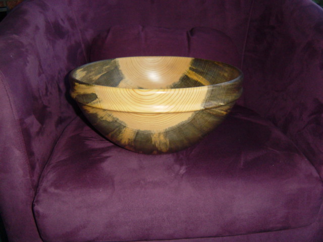

When I do my salad bowls with the same finish I use a non selulose sanding sealer 1st and then 3 coats if this to a high gloss shine. This one is a semi gloss.
