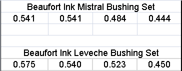

The Mistral and Levech use same tubes but different bushings. I've turned 2 Mistrals and they are quite nice; in fact I would have to say they are my favorite writing instrument. They are way thinner than the Dayacom 12.5/10.5 series, and feel better in the hand than Baron/Sedona. When I can get to my computer I'll be able to tell you which is thicker Mistral or Levech.

I checked by bushing chart for the Beaufort Ink pens, and this is what I have:
From this, it would appear the Mistral is ever so slightly thinner than the Leveche. Of course it is also about twice the price. Given all that, to my eye it is about the most elegant writing instrument available to us turners. Check them out at Turners Warehouse - and no I'm not associated with TW, nor do I get paid for any endorsements, Chad is a nice guy with whom to do business.
DrD

Thanks for all the replies, I’m going with a Mistral in full Rhodium. That’s one nice looking pen and is exactly what I was looking for.
