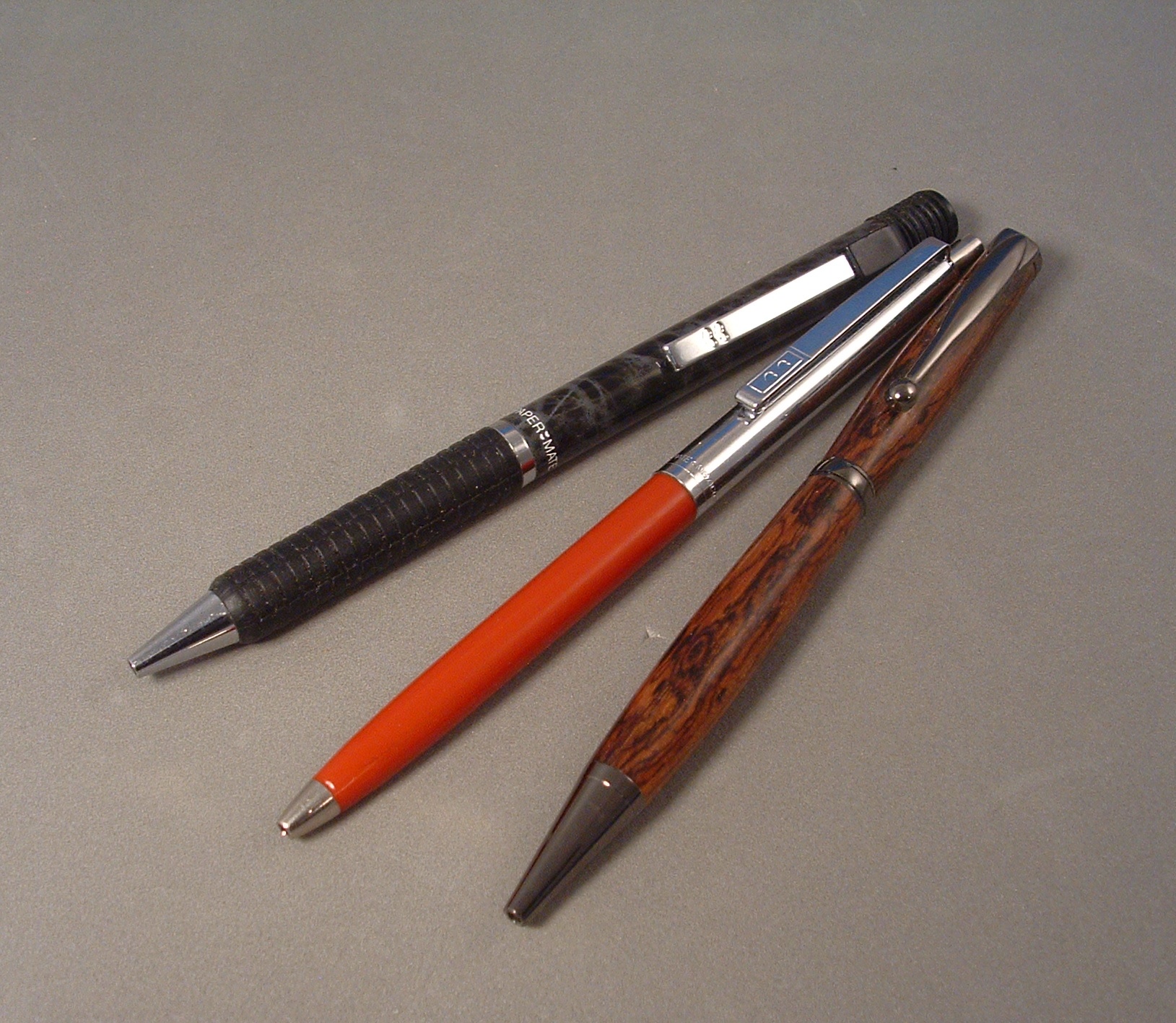

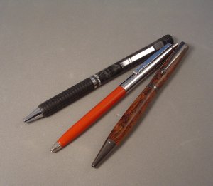

Paper Mate seems to have been making some slim clickers for over 30 years. The 2 in the picture are good examples. In fact, the pen in the middle is the pen my wife carried in her checkbook for over 30 years before I was finally able to make one that she cared to replace it with. :smile:
The pen on the far right is a slimline like the ones I make and sell now. That is what I'm hoping to find a similar kit to but with a click mechanism.

I hear you Smitty. The pen in the middle takes a standard Cross type refill but the other one takes a refill I'm not familiar with.

In the middle kit is part of the click mechanism the actual barrel? I have seen a couple where it is.
If you find one let me know mayble I'll try to list it in my store.
Smitty - that pen is a manufactured by Paper Mate, not a pen made from a kit. I cannot tell much about the click mechanism...and SWMBO won't let me disassemble it :-)
It is by far the slimmest click pen I've ever seen and the click mechanism is very robust and was used a lot by my wife for more than 30 years. I just wonder why something like that is not available as a kit. I'd love to see a really good quality click pen available as a kit but I guess there is not one available.
I wondered because I have an idea that the barrel is also part of the click mechanism. At any rate good luck with your search.

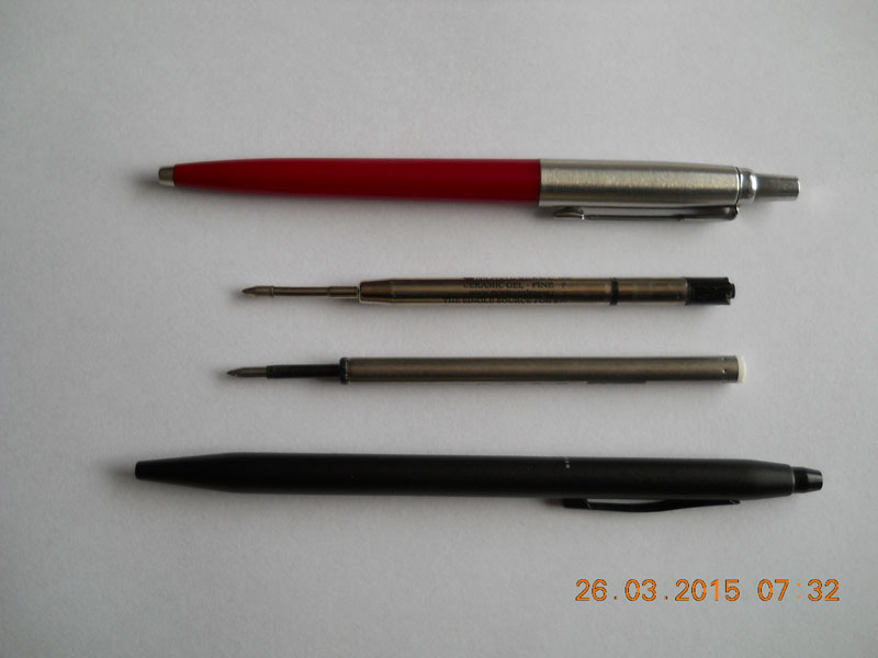

This pen is roughly 5.3" long, a Parker Jotter is about 5.05" and one of the first stock slimlines I built is 5.15". The gel refill from the Cross is 4.01" long and .225" in diameter compared to a Parker refill at 3.875" and .22" respectively. The inside diameter of the Cross' cap is just over .275" and the outside diameter is .325". The inside diameter of a slimline tube is .25" and outside diameter of a finished pen is .33".
All this tells me that a slimline sized pen with a click mechanism using a Parker style refill is doable. It all depends on finding a suitable click mechanism... unless I'm missing something.

Why would or should a slim click pen have to use a Cross style refill? Amongst the many pens in my collection I have a Cross Click Gel pen.

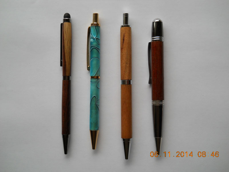

I have taken apart a number of those giveaway pens that you get from real estate agents and others, and even in the mail from charitable organizations asking for donations. Those pens are incredibly cheap to produce, extremely simple in their design, and usually extremely reliable (except perhaps for the refill life).
I even substituted a Parker refill for the cheap refill in one giveaway pen and the mechanism works, with no modifications except a minor enlargement of the end hole where the refill tip exits and retracts.
There is no reason why a pen kit maker such as Dayacom could not adapt such a design to a 7 mm kit format, with minimal parts size change only.
The makers of those cheap giveaway pens have obviously done some clever design engineering and are making a lot of money in selling their cheap pens by the billions. The Dayacoms have to know all about those designs. The designs must be protected by patents.
There is another factor too. The kit pen industry seems to be driven by manufacturer push and not by market pull. Take a look at all the "different" new pen kits that have appeared in the last few years. There is really nothing new in them conceptually. A skull on top; a different bullet design on the bottom; a differently-shaped center band - but the same (marginally functional) old mechanism inside. And we all have to buy a couple to try them out. They know we'll buy their kits whatever they produce.
If we all stood up and demanded a re-engineering of the mechanisms, including a 7 mm clicker design do you think they would listen ?
But no .... we buy whatever they put on the market. Pen turners are at the mercy of the pen kit manufacturers. We're wimps.
I've only checked 4 or 5 of the many out there but none of the ones I checked had a click mechanism that would fit in an 7mm slimline tube. I believe that is the problem that no kit maker has picked one up. There is not likely to be a patent problem patents last only 17 years in the USA so those mechanisms (the ones I saw were all pretty much the same) are going to be in the public domain - at least most of them will.
I have been wondering myself for a long time why there is no slimline clicker.
I have come to the conclusion that it might be a matter of patent infringement.
Good points Mal. I know I have to try out the new designs to see if one might be what I'm looking for. And the designs seem to all have at least one thing about them that I don't really like. It seems like they have someone designing their pens who does not know much about making pens and what makes them appealing. I've tried giving my input but it seems to be ignored so they must have some people they rely on for input but not the average pen turner.
One great example is the new American Patriot roller ball pen from PSI. I absolutely love the smoothness of the threading, but I cannot find a comparable capped pen with less of the bling that would allow me to make a nice functional roller ball pen at a reasonable price. Now granted, I have not tried out all of the various roller ball pens that are available on the market, but that would take a lot of time and expense just to find one that is acceptable as far as both appealing in looks and dependable in function. There probably is one out there but I'm still searching for the perfect combination and have not found it yet.
And the lack of a good clicker slimline pen kit is still just baffling to me.
