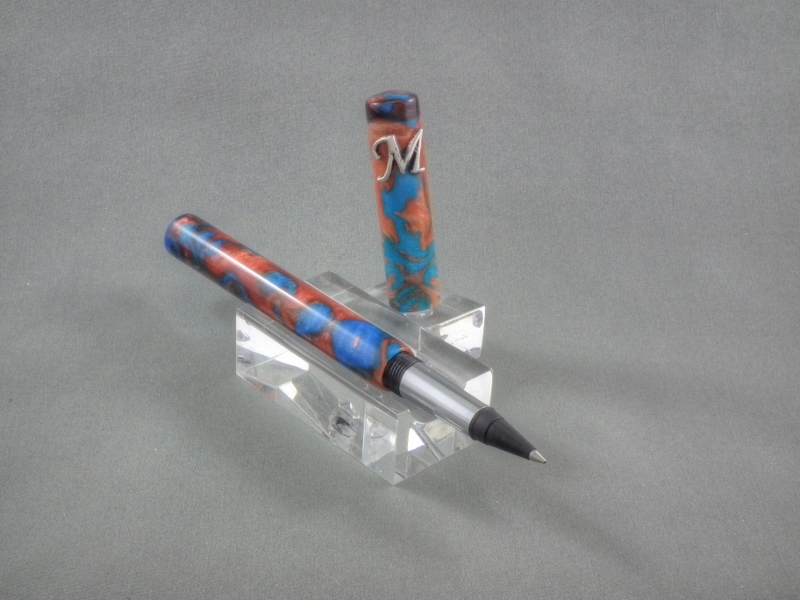

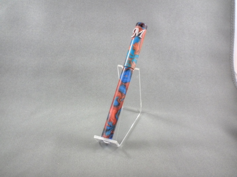

Here is the pen I did for Mack. This was made using a Baron fountain pen kit and adding the roller convertor.
As you can see, I left off the shoulder ring from the barrel allowing a smoother transition to the thread portion. Care must be taken so as not to crack the end when it gets very thin.
On the cap, I left off the the center band. I needed turn the inside edge of the cap a little so that it would ride over the barrel edge just a bit. Like two opposing chamfers coming together. Then with a with a little tweaking to the diameter, I was able to get a balance so that the transition from cap to barrel was fairly smooth.
