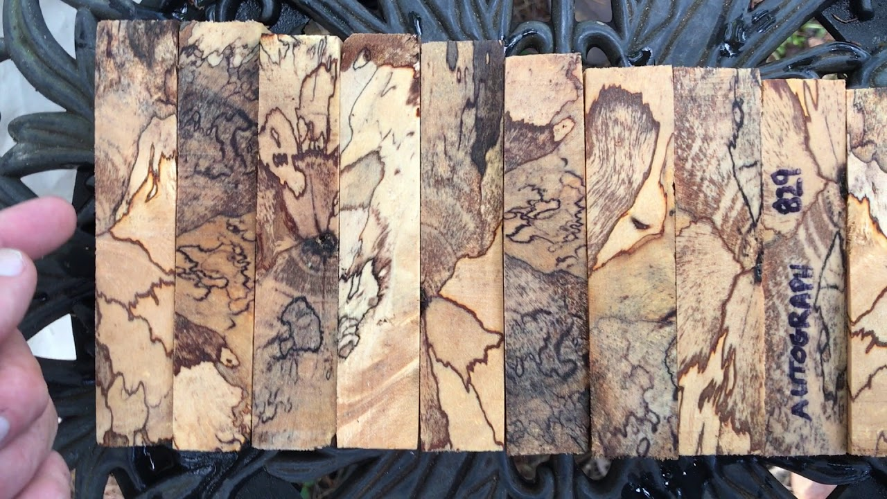

darrin1200
Mar 17, 2010
1,856
Lyn, Ontario, Canada
@darrin1200
If possible, Darrin, could you please send me a reference link to the picture you are referring to.
Some pics referenced by others above are quite different from the wood than I have in mind and which has been marked as "Signature".
Hey Mal. I tried going back in my history, but could only find a couple of the pictures. This is one of them. Spalted Autograph Tree
magpens
Feb 2, 2011
15,911
Canada
@darrin1200
Thanks, Darrin.
Several of the pieces in your picture are very similar to what I have.
In any case, it has been adequately confirmed that "Signature" is indeed an accepted name for a wood species.
That is really all I wanted as an objective in starting this thread.
