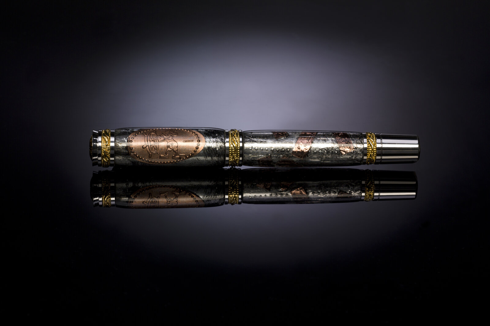

Been making this one and demoing it for years now ...
Crushed penny ....

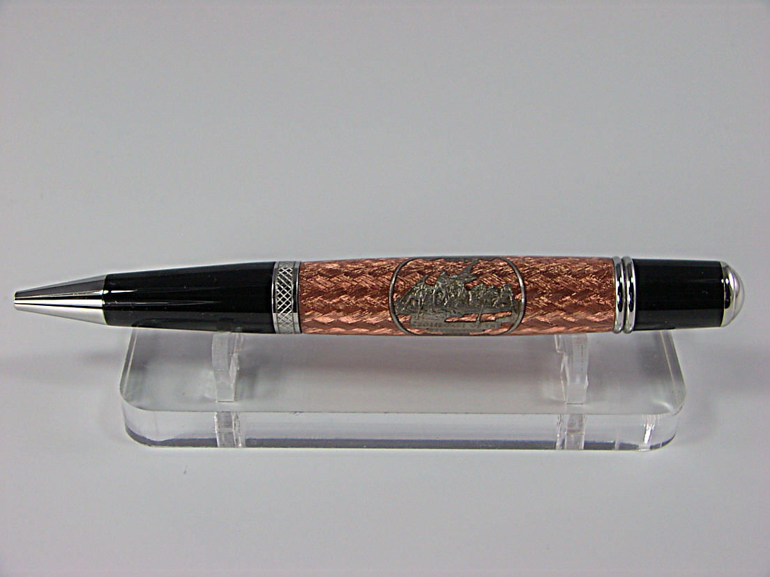

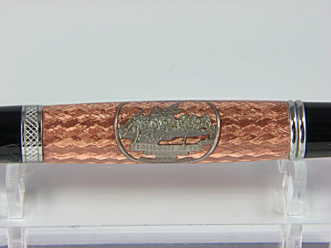

I know several coin cutters beside Seamus that do it and it is sold on itsy all the time as jewlery. I use to cut dollar bills into puzzles but that got expensive so now use motion picture fake money that looks like the real thing. These are very popular at my shows. I cut all denominations now instead of just the one dollar which I was limited to. :) Cutting up a hundred dollar bill to get $20 is not cool.:)
Seamus did this New Jersey coin for me as a bet he lost when I bet him I could cut a quarter in half down the middle. He did not think possible well I showed him. :) I sent him the blank and he cut the quarter and mounted and cast.

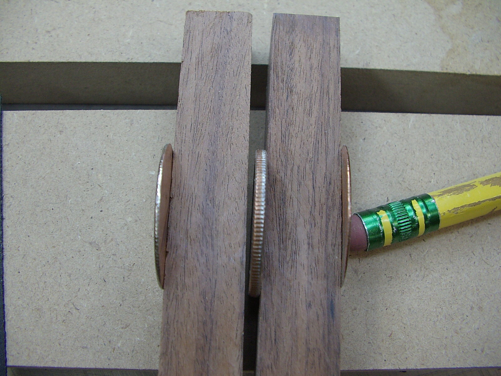

John, if you don't mind, how did you cut a coin down the middle?

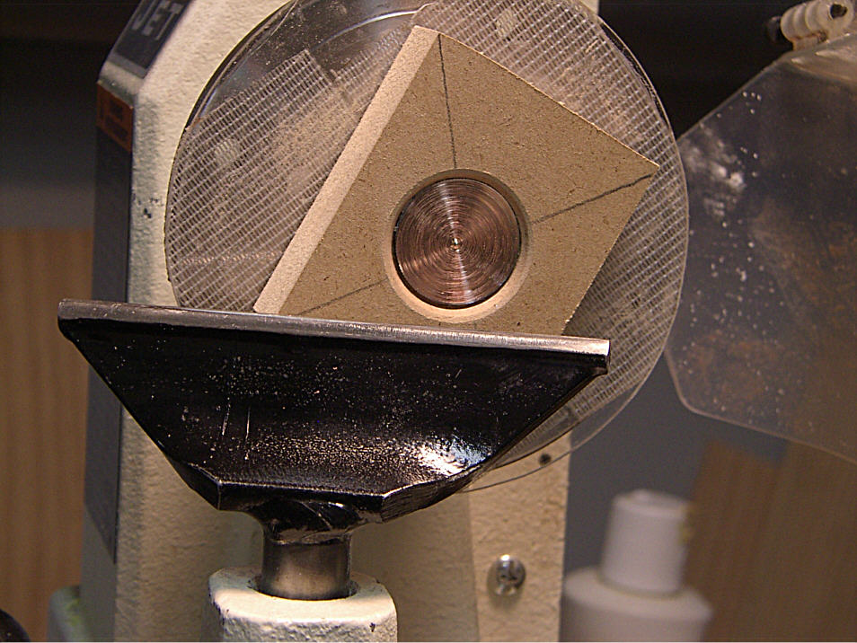

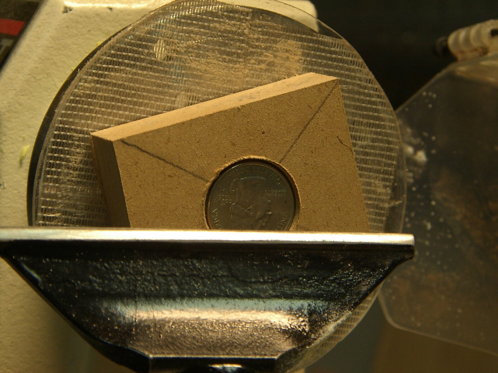

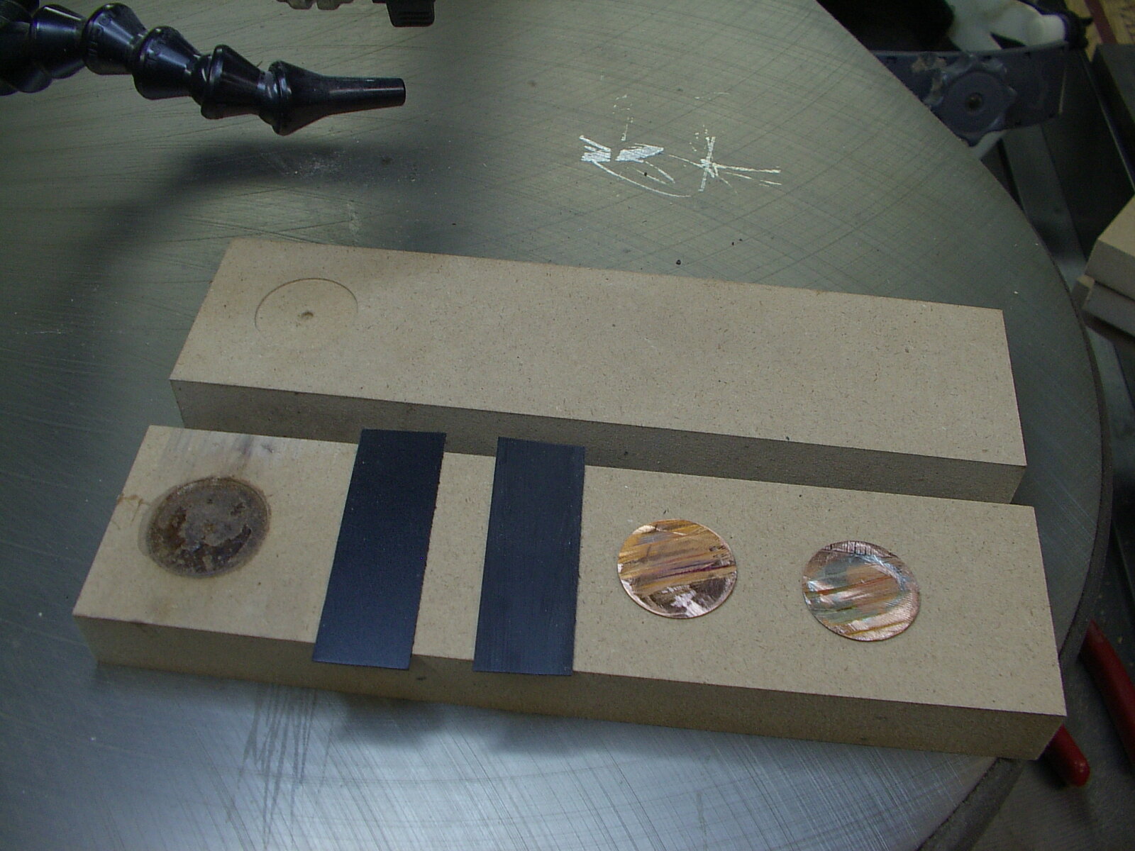

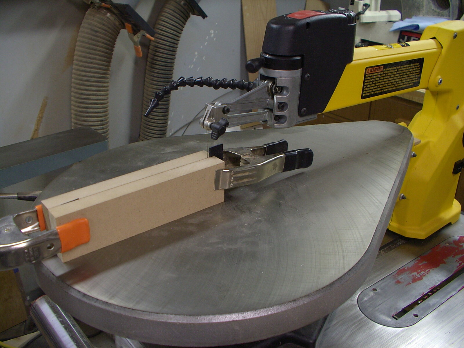

Hello Alan, I used a scrollsaw and jewelers blades. Probably about 5 blades if I recall. I did it using my Dewalt 788 saw. I could have used any of my RBI saws too but chose that one. The key was figuring a way to keep the quarter straight and true as I cut it. Found out there is a lot of junk metal in them Probably would have been better to cut a silver one but they are worth more. I included a few photos. I also included a photo of a quarter on my lathe. The discussion Seamus and I got into was a easy way to thin down a quarter. This is what he needs to do when he cuts his quarters in order for them to wrap around the tube easier. The lathe method is definitely the easier and quicker way. Anyway he and I did a friendly bet and if I lost I would send him some of my copper wrapped blanks and if he lost he would wrap one of my blanks with a NJ quarter. We sort of both won.:)
