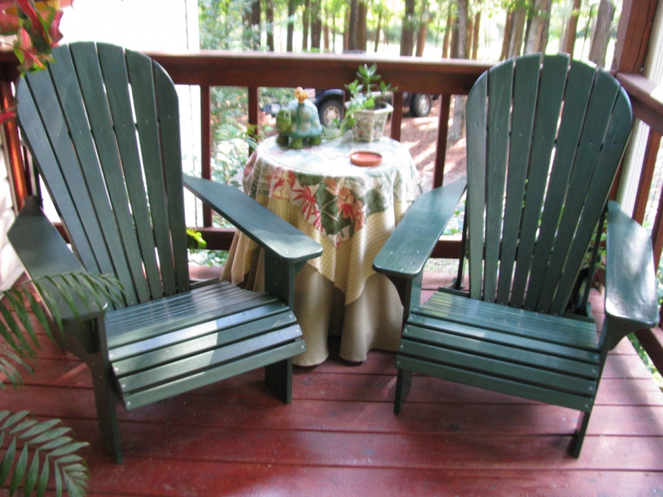

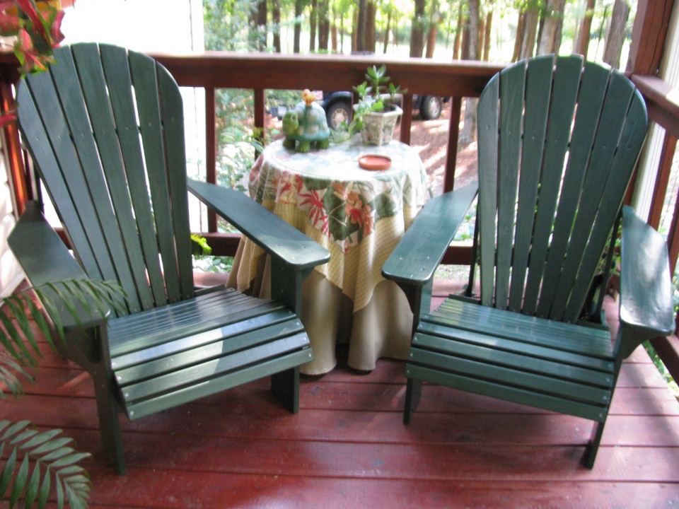

As to the chairs, Have not sold them yet, but they are a dream to sit in.
And Ed, I was born and raised in Kenosha, I really would like to get back up there again. Thanks again

Still love your chairs!! Nice work!
I HAVE to ask!!!
How, in the world would you SHIP that Adirondack chair, if you sold it!!!!
Beautiful pieces!!!
ED, I have a plan for a very comfortable Adirondack chair I would be happy to send you. A man with your talent should have no problem building a few of your own. If I can do it, anybody can.

I think every carpenter or wannabe carpenter has made those chairs. I can still remember working on them when my father built a couple when I was a youngster. I inherited my Dad's woodworking genes for sure.
