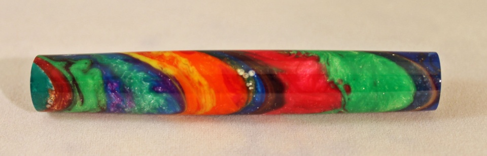

I feel some amount of frustration with every pen!! It seems I constantly create new lessons learned and have to relearn old ones. Go slow and make sure your tools are sharp!! And, this piece looks an inlace acrylester, very hard to work with and very chippy!!! My wife and I turn and we have more trouble with this material than any other. I have had inlace blow out on the drill press, chip out completely on the lathe, and chip out completely on a buffer. Attached is one inlace pen that needed two lower pieces to complete. It has great color though and if you can complete the pen it is worth it.
