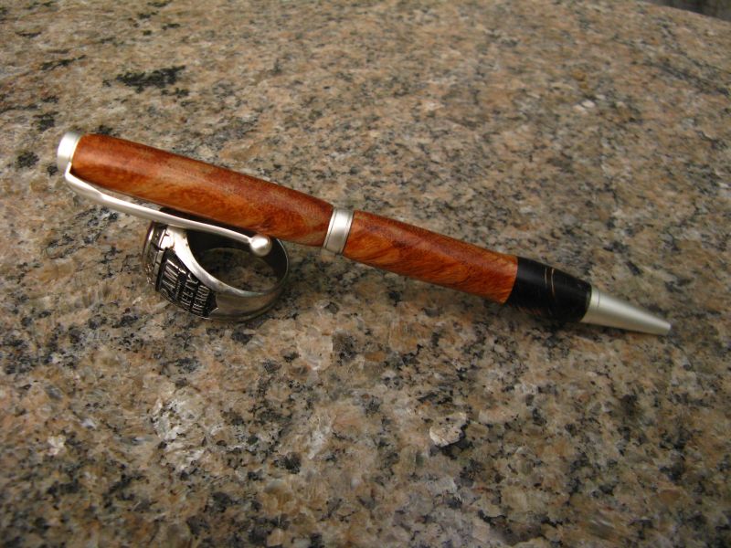

It was my first pen, a slimline, 2 days ago. I'm mostly showing it to learn how to post photos. The photo was a little hurried as I had to hurry to the restaurant to give it away to my favorite waitress.
The wood is red oak and ebonized red oak.

Used apple cider vinegar and some steel wool?
Looks very very nice ... should have entered some of the SE contests!
I used vinegar (h2o will work) in a peanut butter jar full of old rusty 16p nails. I recently watched Al Furtado use steel wool and vinegar on something he was turning. It doesn't get dark enough for me that way. I soak it overnight then dry in a toaster oven. It does get iffy, I've ruined more than made it. I try to turn off some of the black to get some grain patterns. Like I said, it gets real iffy.
