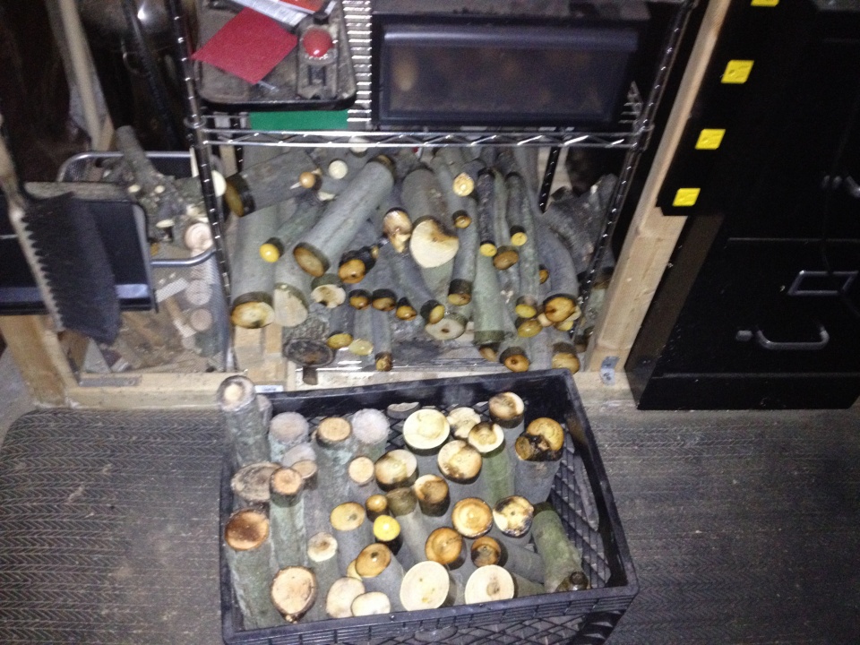

Is fig wood safe to turn?

Hello, some friends of mine had a fig tree that didn't bloom this year. New trunks sprouted from the roots and they cut down the old growth. The limbs were straight and a few inches thick. They gave me a pile. I cut the wood to manageable sizes and waxed the ends. I read that the sap can be an irritant. Has anyone turned fig? Anything I should know?

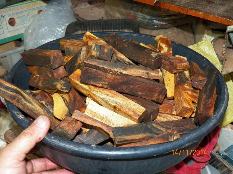

I'm working with some fig wood, at the moment, I'm processing the main trunk that has been in the weather for about 1 year, the cracking and spalting made it useless to get full size clean pen blanks out of it (only a few) and the rest shown ideal properties for casting, and that is what I'm doing, with all wood stabilized (pic attached) and the first batch of 24 blanks cast with yellow and black carbon, they are finished but not yet photographed...!

Thanks for the information. I have attached a picture of the limbs after processing. I have others cut down to 4 feet with a diameter of about 4 inches. I waxed all of the ends to slow down the moisture loss and hopefully prevent cracking. It is stored in a cold garage.
