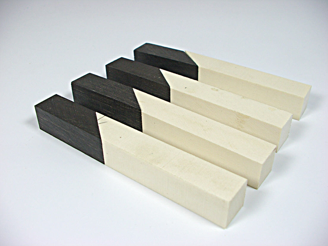

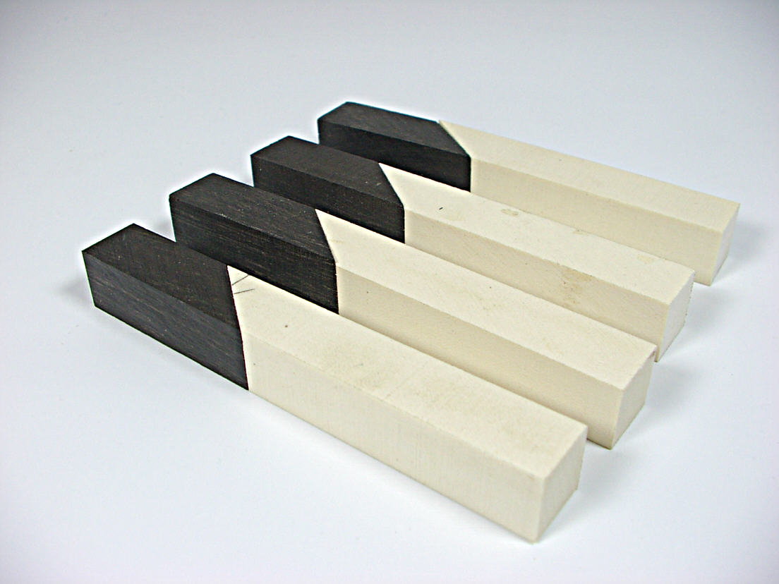

I did a fair amount of ebony early on and used it in basic segments such as this one:
I never had any problem with CA soaking in, and I didn't bother cleaning with acetone to make it stick. My method of applying CA was with an applicator because paper towel (PT) absorbed too much of the CA and it took 20 or 30 coats with PT to build up as much as I could get in one or two with an applicator such as foam or plastic bag or something similar.
The problem I had was that in trying to separate the bushings from the blank with that much CA - the CA would lift up off of the ebony blank on one side when the bushing snapped. One way to prevent that was to score the CA at the bushing / blank line, but that didn't always work. The best way for me was something totally new - turning between centers. Once I did that, I had no problem with building up layers of CA on oily ebony.

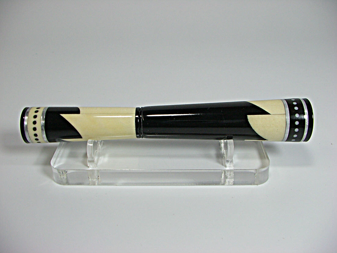

I use gabon ebony alot and never have a problem finishing it. Here was the last example I made. Gabon ebony and holly.
