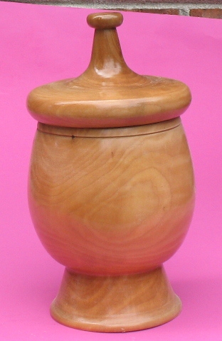

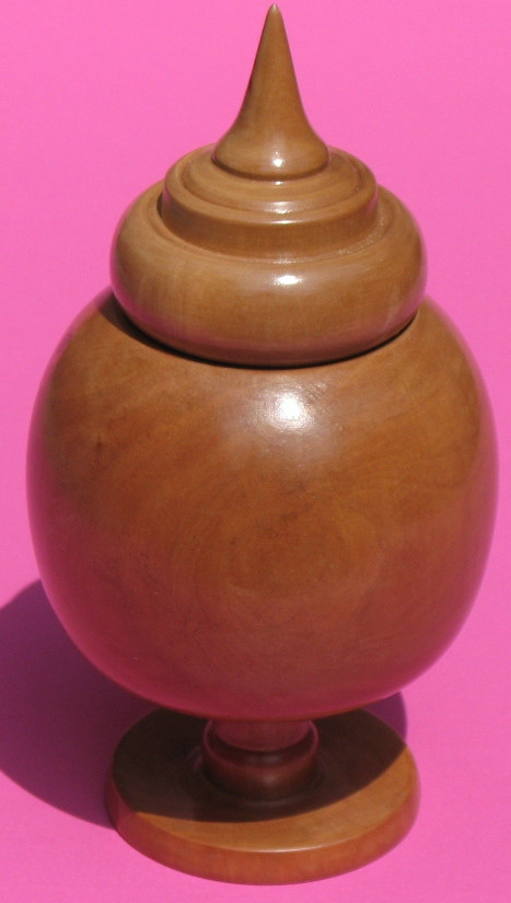

I have turned a lot of different item from Dog Wood color can vary a lot. JMHO, don't need to do anything fancy with Dog Wood, people impressed with seeing something made from a tree they know or own. Have made and sold several plain Dog Wood pens, unfortunately none to show today.
Finishing with different clear film products will produce different results. Here are two Dog Wood boxes, one finished with Shellac and the other Water Base finish. The darker of the two started out an offset turning but due to flaws in the wood plan changed.
I say keep it simple think will enjoy turning Dog Wood, best of luck!
