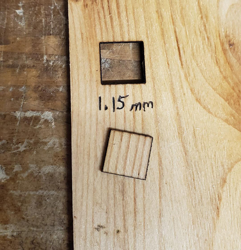

So here is a depth of cut test I did. This is with the 3.5w standard laser. This is a 1/2" square. I burned it at 100% laser power and 100ms burn time. The first burn did cut thru the top and bottom lines but not the sides. So the second test was at the same settings and set to burn 2 times. The cut is a 1.15mm thick veneer. I would bet that the 7w would have cut it in the first pass easily. The 20w probably burn thru whatever is under the veneer. Lol

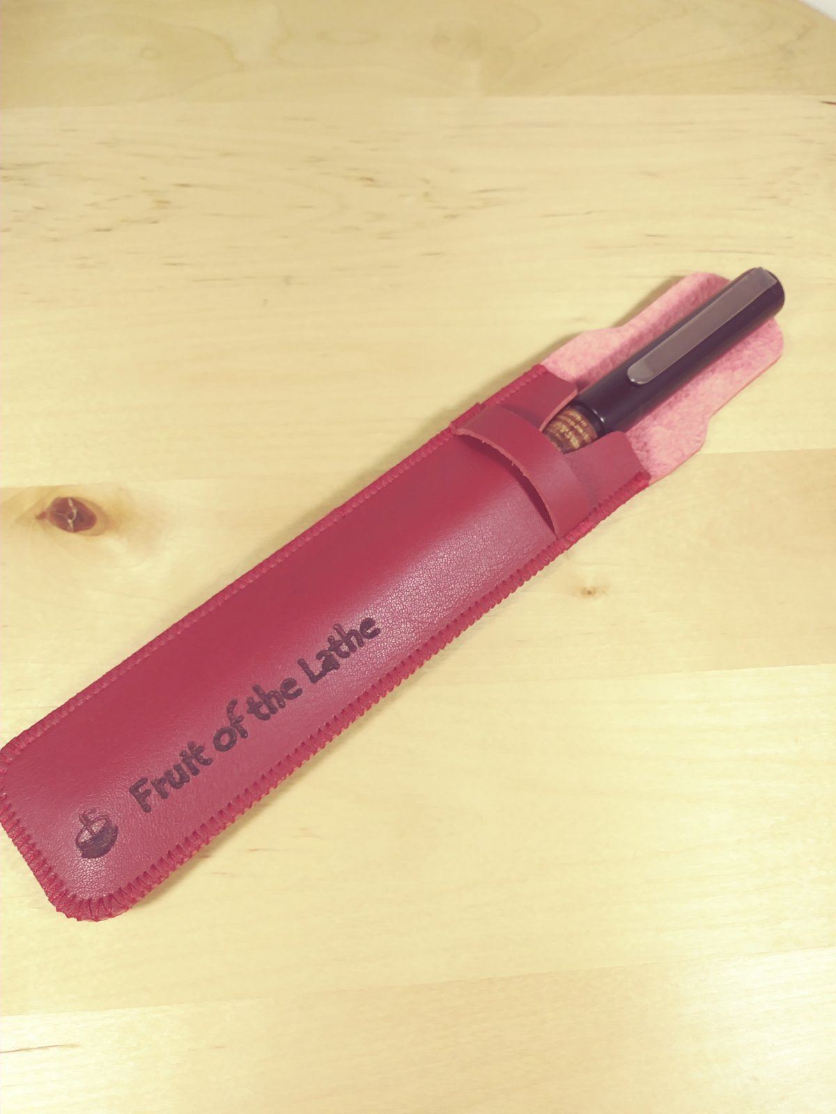

I have the 20W. There's no problem dialling back the power to 10% and shortening the burn time to reduce the effect - I've successfully engraved a wooden pen barrel, cork "drink coasters", and leather pen cases. It can also cut Mylar sheet.

Found the leather pen case photo ...
