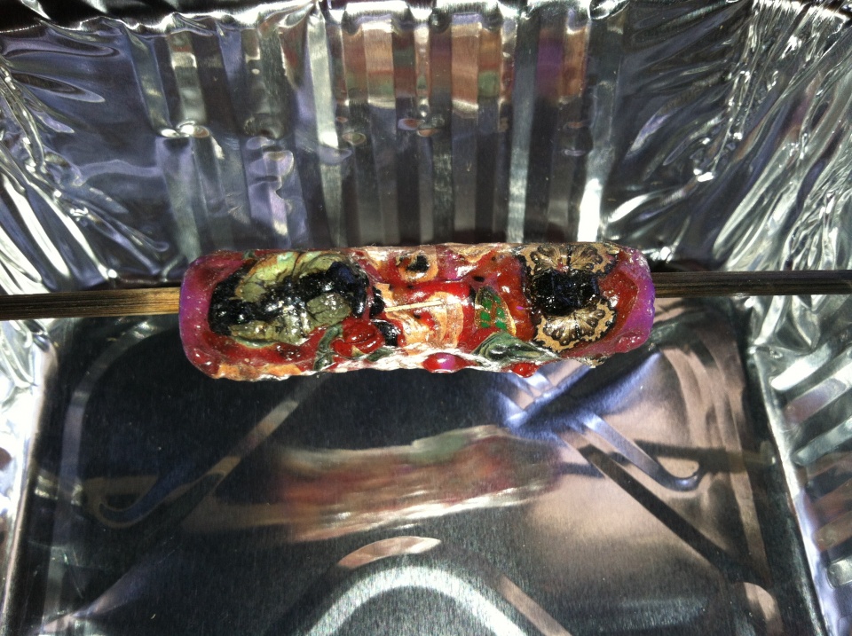

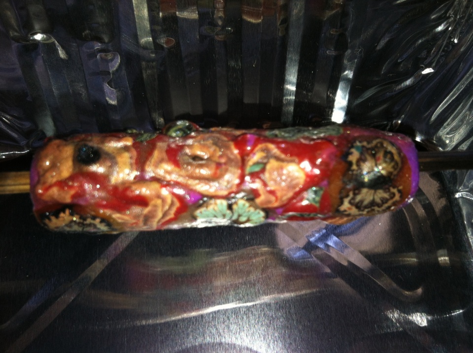

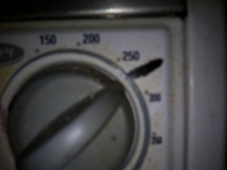

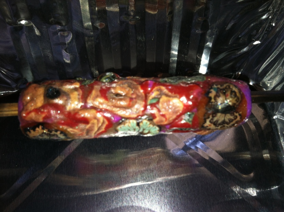

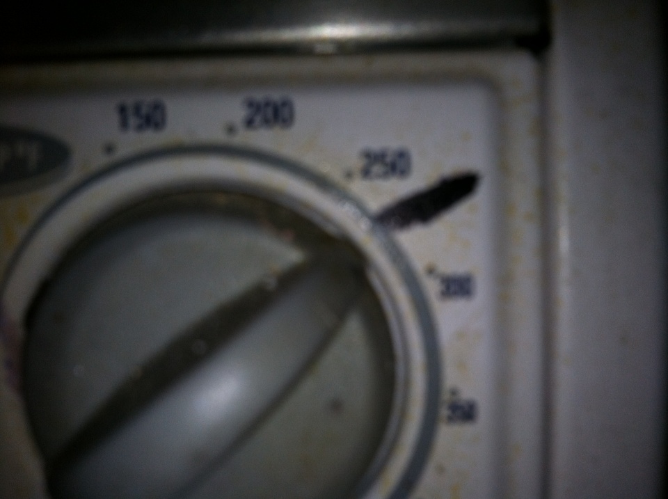

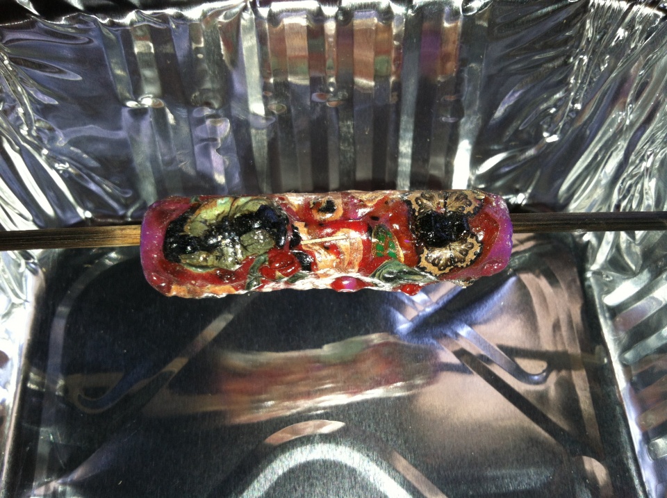

I had a clay blank that I made with some canes. It was Scuply and Kato. I baked in the toaster oven at 275. It started smoking and the blank started melting.. Maybe the oven temp really wasn't 275? The dial was between 250 and 300. Also I got in a hurry and didn't cover it (dumb mistake).

The problem with a toaster oven is that the material is too close to the heating elements, so that the overall temp of the oven may be 275, but the radiant heat may heat up the surface of the product much higher. You need to use a bigger oven where you can get the material farther away from the heating element
I bought an oven thermometer and find that I have to use different dial settings on my toaster oven depending on the air temperature to get the oven temp I want. I turn the oven on and wait for the temp I want to register on the oven thermometer (adjusting the oven temp dial as needed) before I put anything in. It saves a lot of heartache.
Ed
I have had a couple of toaster ovens -- one was off 75 degrees F from what the dial indicated. Thermostats in toaster ovens (especially low cost commodity models) are not a precision device -- and tend to get worse with age.
A better oven thermometer will likely cost more than the cost of a second hand toaster oven.
It is not uncommon for even full size household ovens to have air temperature variations of +/-50 degrees or more even if the average is at the set point. When the element comes on the interior temperature exceeds the set point and when off, it goes below. Only a good scientific oven will hold temperatures in a narrow range. That being said, if you shield the clay with a cover of foil, you should minimize chance of burning.
First thing I can see wrong with your setup is the pan you have your blank set in. A 4 sided deep pan like that reflects and consentrates the heat back up toward your blank like a reflector oven would do. 2ed you need air to circulate around your blank. Cut a V groove in two wooden blocks to hold your rod and blank off the surface. You should also use the metal rack to keep your blank centered as much possable inside your oven and to allow air flow. 3ed Tin foil under and over your blank to reflect any hot spots away from your blank. 4th Go to Walmart and buy a oven thermometer, the stand up type, ($10) and place it inside the oven. Preset dials are never on the money. When your oven temp. reaches the degree you want, mark your dial for that setting. And last, I think 275 degrees is a little high, and unless you are doing a thick casting, 30 minutes is to long. I bake my polymar clay pen blanks at (true) 250 degrees for 15 minutes and remove them hot and submerge in cold water. Now you can dry them off and bring them directly to the lathe and turn. If they seem a little soft, return to the oven for another 5 minutes or so. I do a lot of inlays that require 2 heating cycles, one for the base color, and one for the inlay itself. Once your first heating cycle has been reduced back to room temp, and your inlay has been applyed, another 15 minutes of bakeing does not harm the blank. Jim S

2. Again use a thermometer. I had to turn down my dial about 75 degs. to get 250 degs. Do this before you start cooking your blanks.

I cure my stabilized blanks in a toaster oven and use as multimeter with a thermocouple thermometer. Toaster ovens are notoriously poor for temperature control. Your setting could be off by as much as 50-75 deg.
When I first started making PC pen blanks I acquired 2 used toaster ovens and when I baked the first batch of golfball blanks I set the control for 275 and the timer for 30 min. When done I allowed the oven to reach room temp before opening the door and, walla! the blanks were brown as in toasted. I made another set and fired up the 2nd oven and, with n oven thermometer in place, baked another batch. This one came out perfect. I looked over the first oven and realized that it had two sets of numbers, one is Fahrenheit and one Celsius. Yup, I was running a lot hotter than I knew. I'm sure no one else would make that silly mistake, would they? Sculpy (which I no longer use) at 275 and others at 235 FAHRENHEIT.
