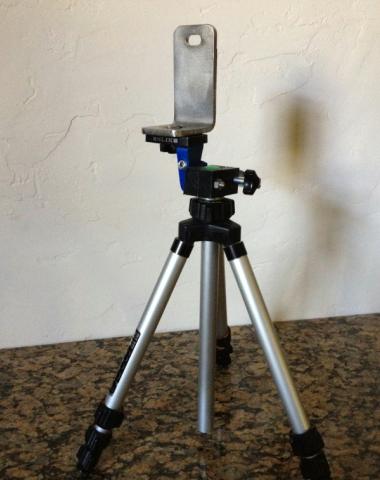

This is the front view showing the adapter mounted on the tripod.
attachment.php

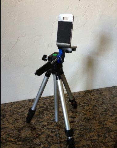

A back view showing the piece of foamy use to protect the phone.
attachment.php

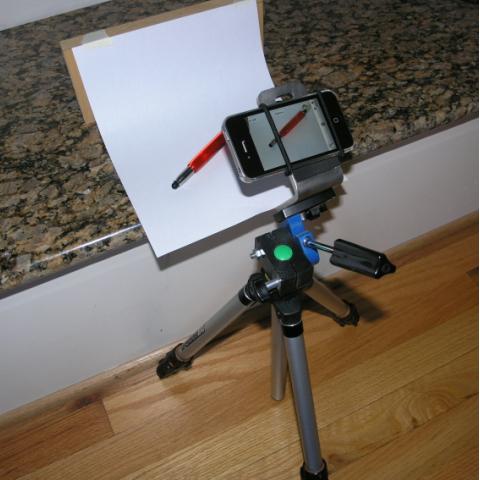

Here is an phone mounted to the adapter. Note the bungee holding the phone in position.
attachment.php

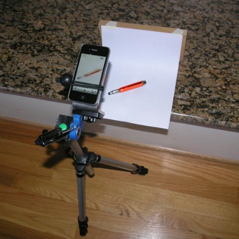

The phone mounted in landscape position.
attachment.php
