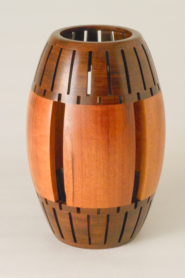

I made a segmented vessel from ipe, and it is hard. It was chippy while turning, but after enough sanding it looks good. Tigerwood was used for the center. Both woods came from extra flooring.

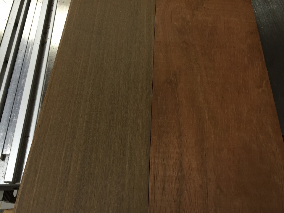

I have a friend who does exotic flooring and I have both Ipe and Brazilian Cherry - not the same - I will try to find them tonight and post a picture!
Right Keith, I made a mistake and should have called Ipe aka Brazilian Walnut.

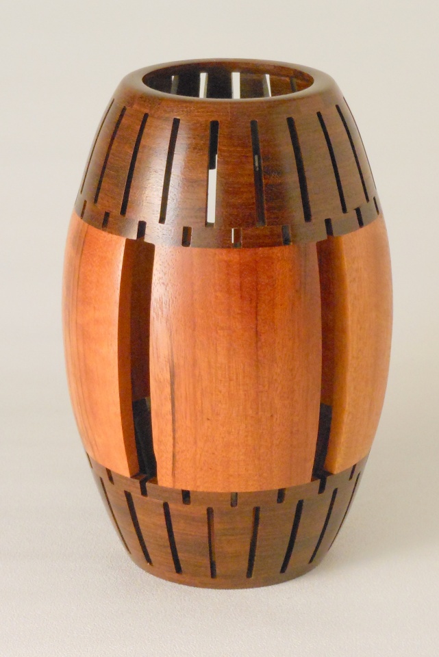

Jeff that is a beautiful piece. Excellent segmenting and turning. The woods work well together. You have to post more of your work. I love looking at work like this that is a true segmenter . Not to take away from those that use the ringmaster but this is what it is all about. Excellent.

Here is a picture of Ipe and Brazilian Cherry - Ipe is on the left

Jeff that is a beautiful piece. Excellent segmenting and turning. The woods work well together. You have to post more of your work. I love looking at work like this that is a true segmenter . Not to take away from those that use the ringmaster but this is what it is all about. Excellent.[/quote]
Thanks, John. I started my addiction doing segmenting, and still consider it my main work. Pen turning started as a whim, and I got sucked into the abyss. I will post more segmenting work as I can. My website got moved to a different server, and the java scripting isn't supported. :frown: I am in the process of setting up new picture pages so they can be viewed. :rolleyes:
Thanks, John. I started my addiction doing segmenting, and still consider it my main work. Pen turning started as a whim, and I got sucked into the abyss. I will post more segmenting work as I can. My website got moved to a different server, and the java scripting isn't supported. :frown: I am in the process of setting up new picture pages so they can be viewed. :rolleyes:[/QUOTE]
