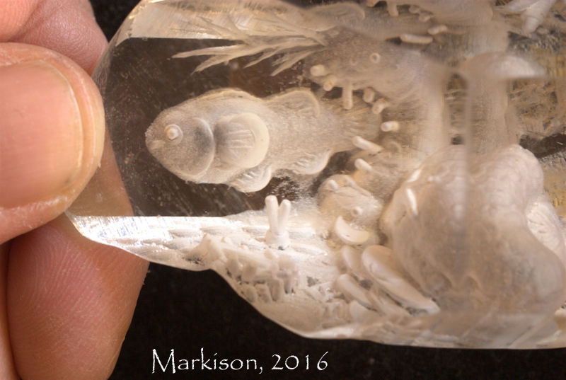

Coral reef seascape with amphiprion percula (clownfish), sea anemone, sea star on brain coral, sponges, and a little crab approaching the foreground

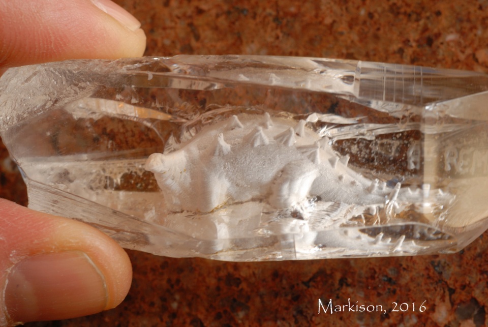

Stegosaurus

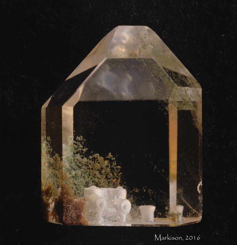

Reading chair and table with fossilized moss inclusion
