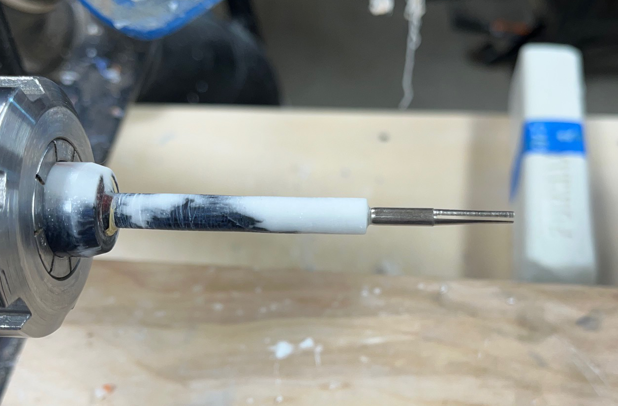

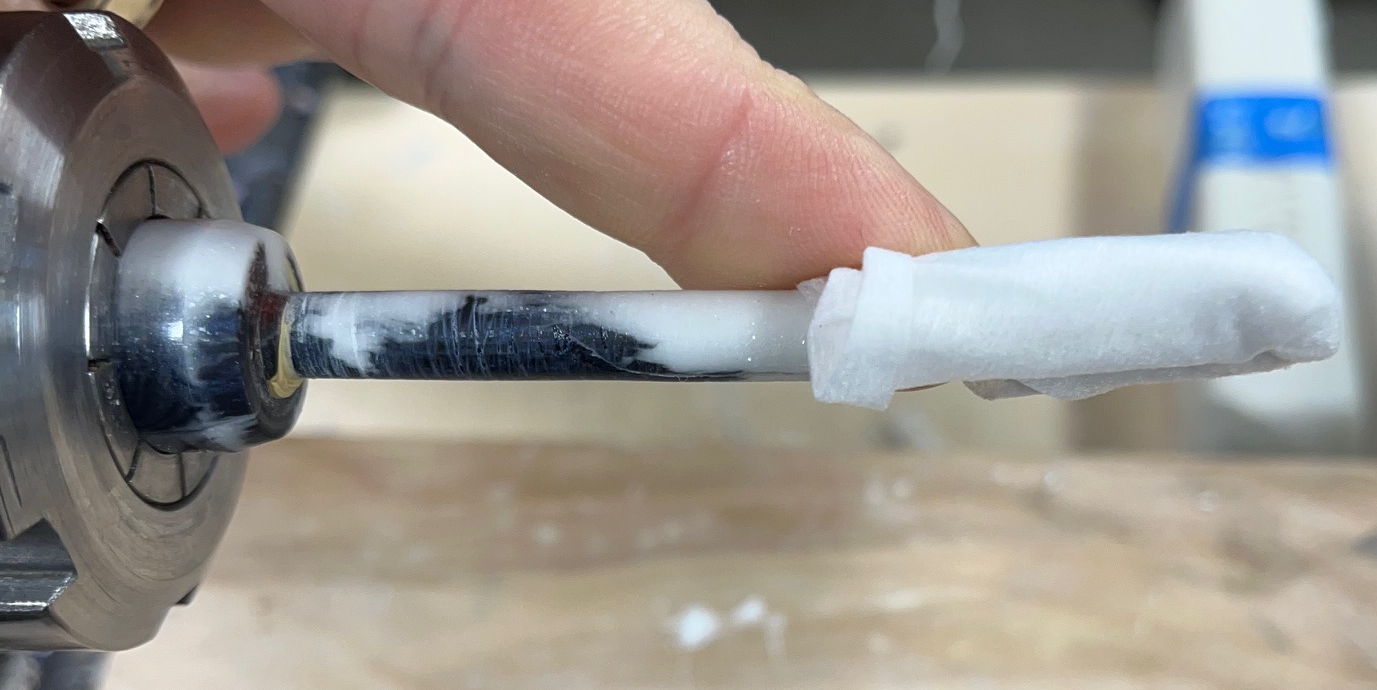

I made a tool using a Foredam split mandrel. I wet sand with Mirka Goldflex soft foam-backed sanding sheets in 400, 600, 800, and 1000 and then move to 3M wet dry paper for 1500 and 2000. The foam-backed sanding pads really help me get even sanding. Then I apply 6 steps of magic juice using gun cleaning cotton cloths attached to my mandrel. Then I use Caswell buffing compounds extra fine and fine on a small buffing bit. The whole process takes me about 1 hour per part. It is a real pain and sometimes I feel not worth the effort. The problem comes once everything dries and I see a hazy spot or area. Then I start over again.

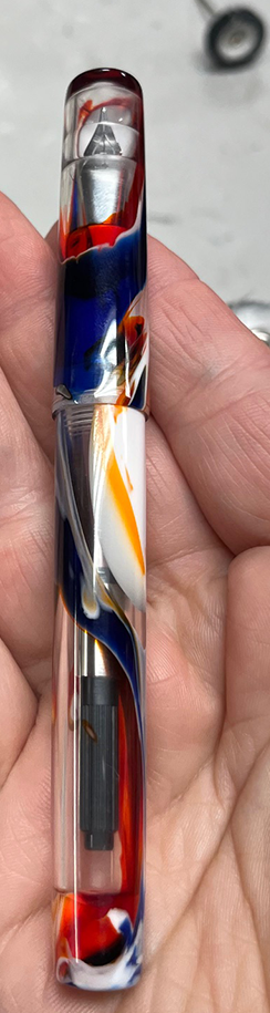

The pen below (exterior not buffed yet) is on its second time through these steps, and I almost have it where I want it to be. Once it dried I noticed a little haze on my step drilling in the cap. I am going through these steps again on my cap tonight. This pen is a commission, and I think going forward, the most clear I will do is an ink window. Trying to get a whole pen perfect is too much work and my price needs to go way up.
Wow! It looks amazing, that is a beautiful sight to behold.

I only use the wet/dry sandpaper because Mirka doesn't make pads with grits above 1000. Zona would work very well, too.
