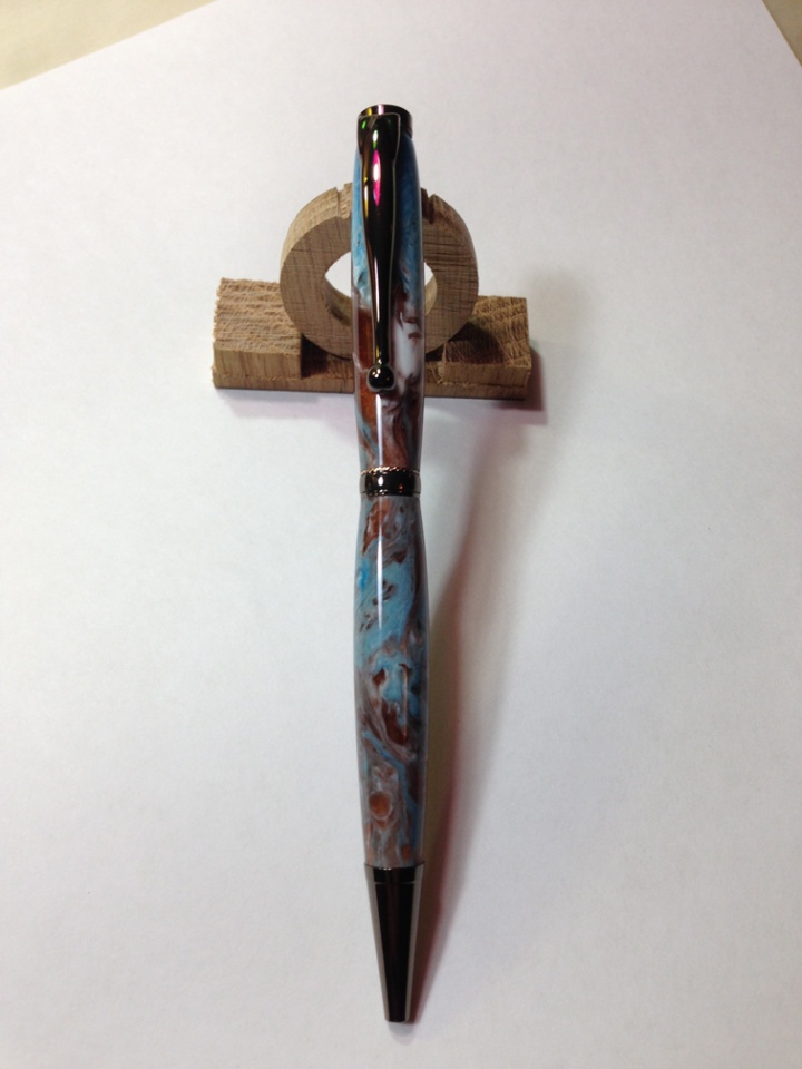

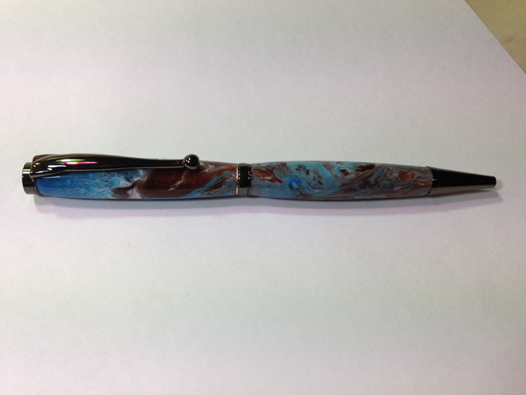

Wasn't sure how this one was going to turn out at all. This is the first time that I have used a center band like this. But, I forgot to make a center band and ended up having to use this one.

Hi Mike.
Referring to our PM conversation... A bit of critique. I may be wrong due to the picture angle, but the nib looks proud (larger) than the finished blank. This is where it is helpful to use your calipers and measure the components, and turn/finish to the measured dimensions; don't rely on the bushings. If you have been using the same 7mm bushings for all of the previous slims, I'l wager that your bushings "have lost weight" :eek:.
